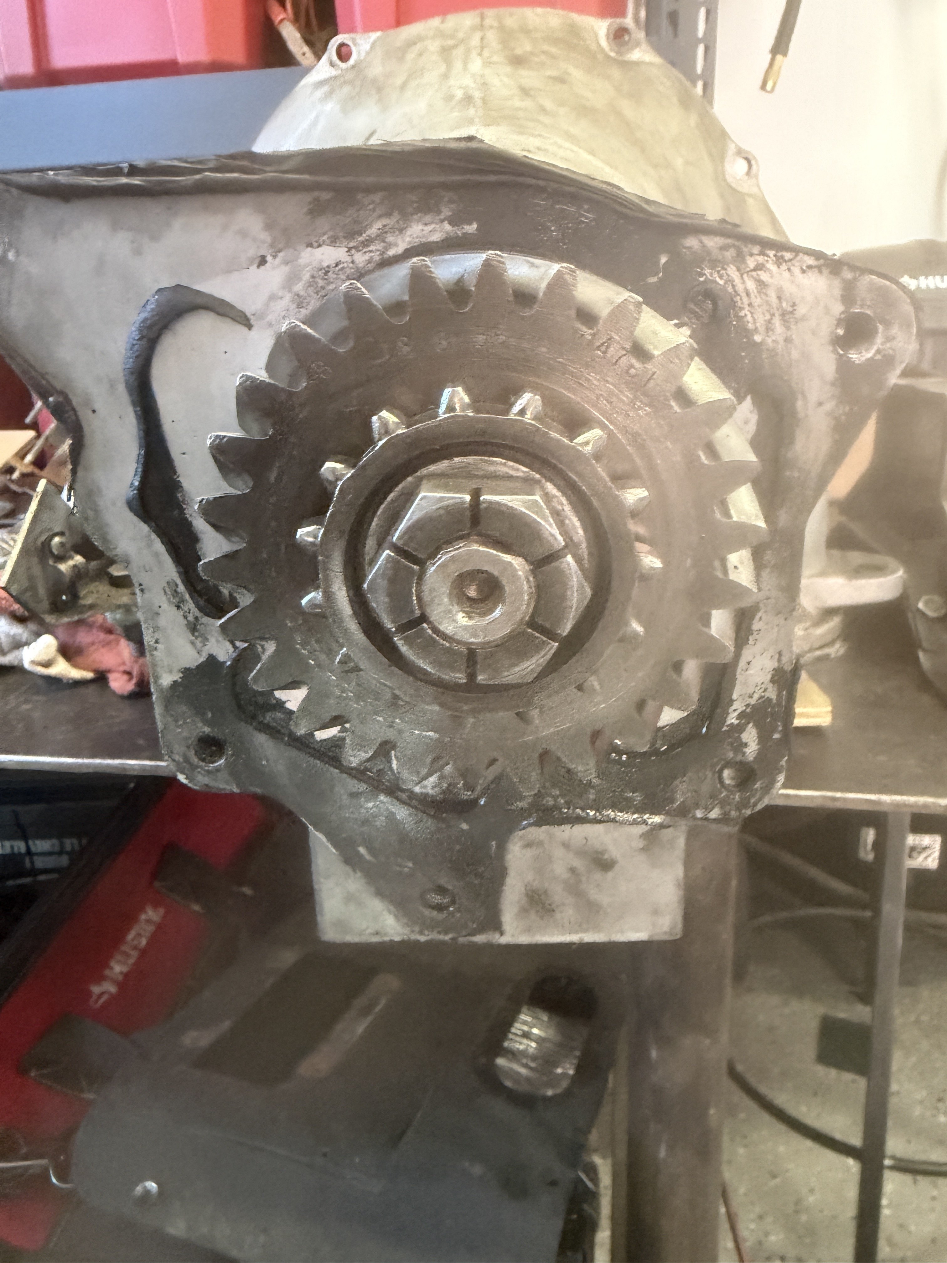

Hum, I didn’t see anything in my history. It looks just like the input gear I’m using on the BW tranny right now.

As long as you are using the matched bull-gear. There are a few different angle pitches of the gears throughout the years of production.
Thank you, for the info. I will look at the gearing numbers and see what I can find. I have a lot of work to do getting to that point. First I have to get the BW boat anchor out. I did go through all the TF 727 parts. Looks like I have the throttle plate, kick down rod, flywheel, ring gear, Harmonic balancer, shifter, cable, floor plate, tranny, dip stick tube, all the bolting.

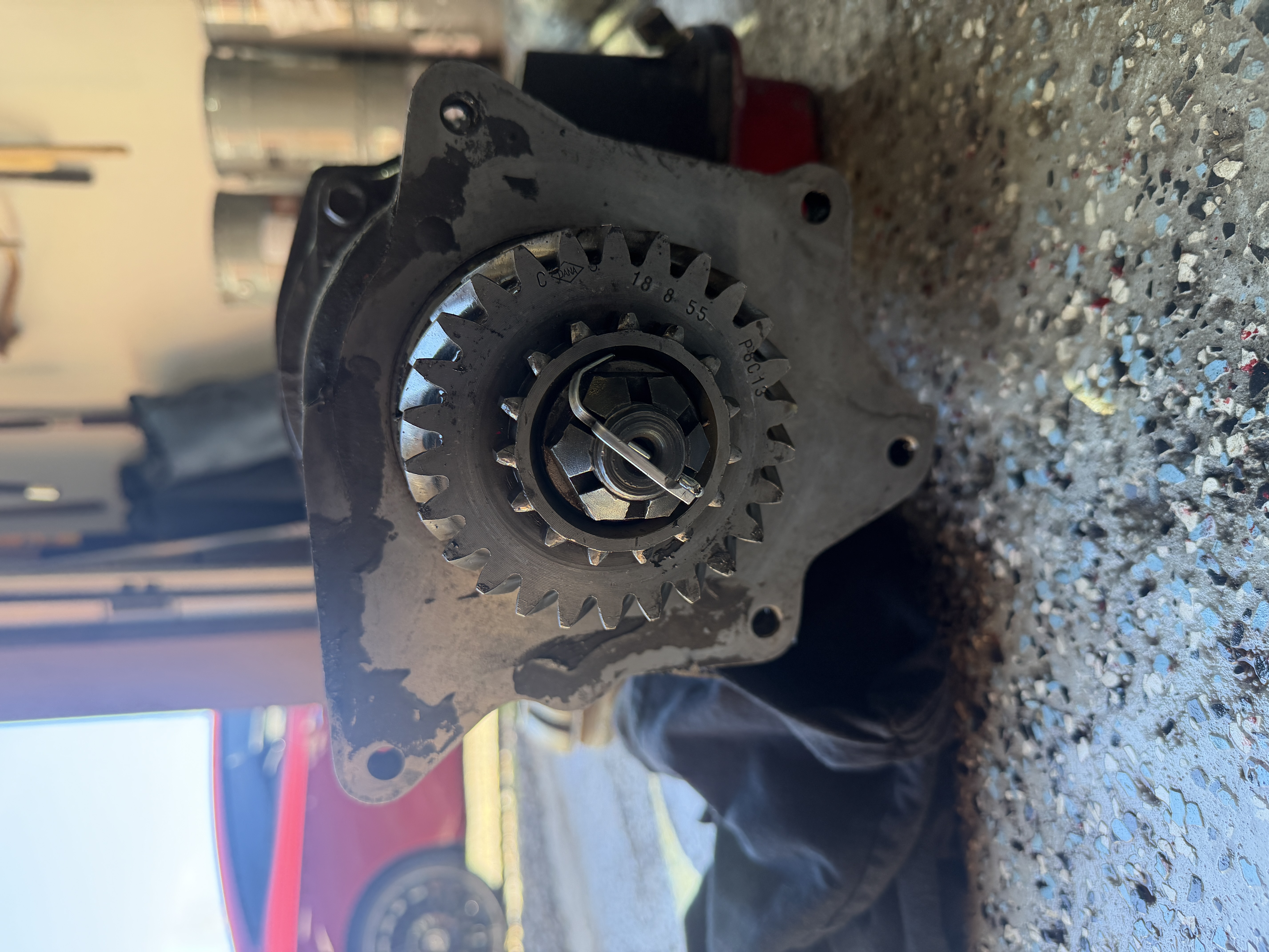

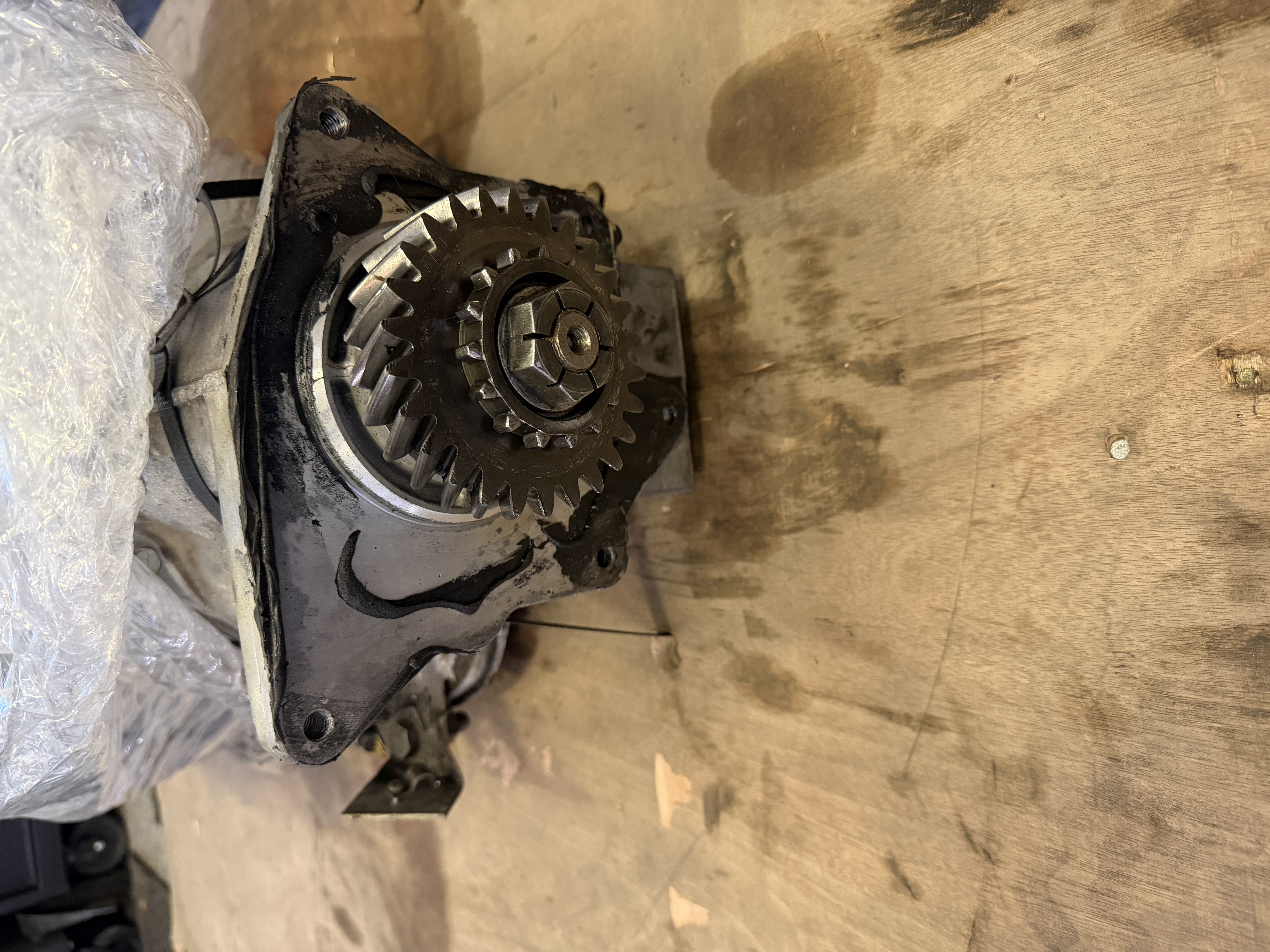

Ok, The nomenclature stamped in the TF 727 output bull gear is, K8 18 8 56 and then numbers non legible because of machining.
The nomenclature stamped in the output bull gear on the BW model11 is C? 18 8 55 P8C13. They both appear to have a little wear. The only thing I know to check the wear is blue the gears during assembly and look for 80% contact or better.
Pressure angle 17.5 Deg 727 trans
Pressure angle 17.5 Deg BW trans
So both will work but the internal splines wont interchange. So you cant move the one from the BW to the 727.
Pressure angle being the same. Go for it.

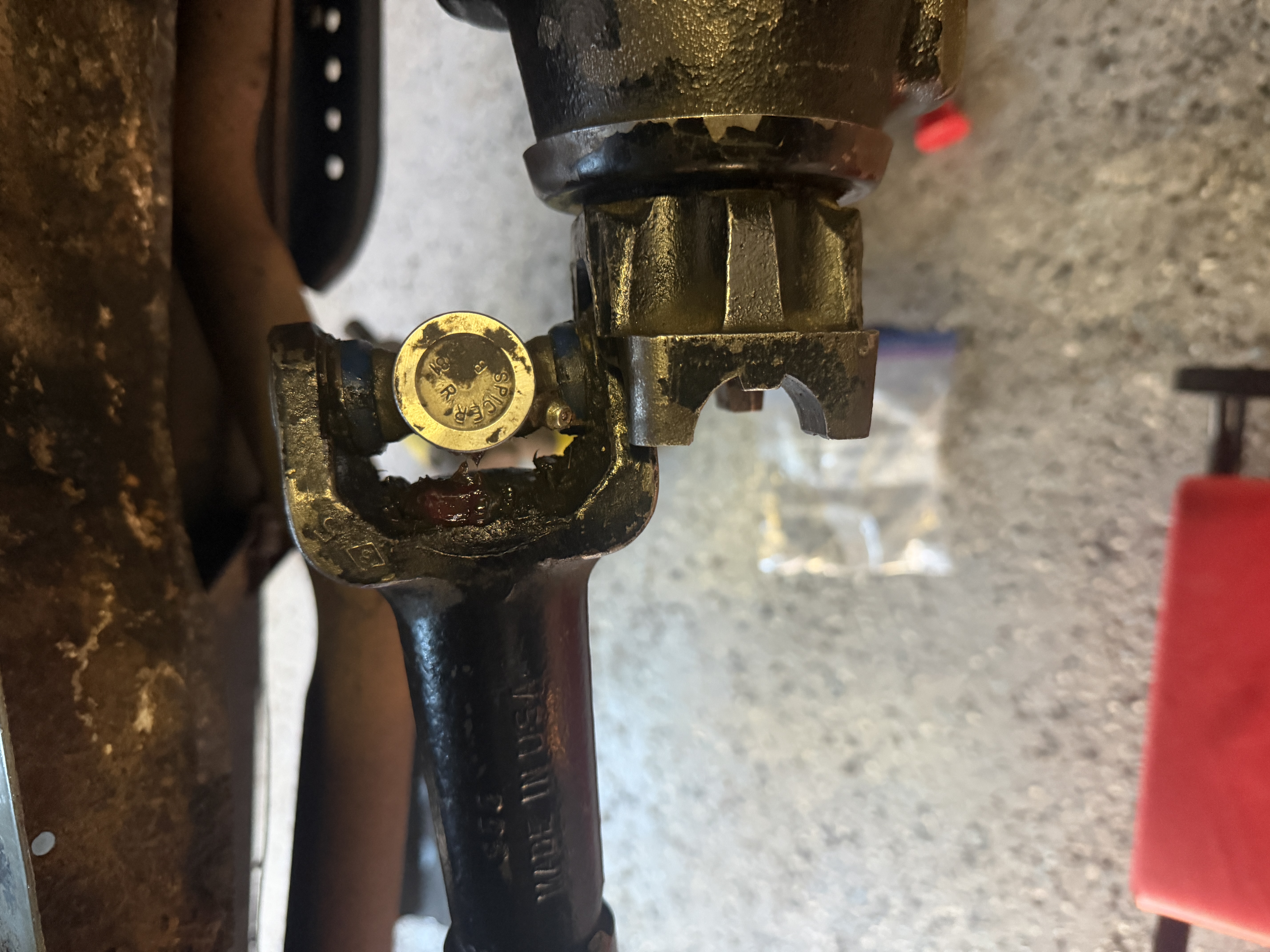

Ok, Transmission and Transfer case are in. A little but of a project installing the transmission. I had to use an engine hoist. I choked the Transmission with a 6' choker and lifted it from the front of the Scout over the top of the engine. My wife jacked the engine hoist as I guided the tranny in place from the rear of the tranny. This helped with keeping the tranny straight. Fit right in. No issues with the torque converter. After the Transmission installation was complete, I installed the transfer case. No issues there. If you are going to make this modification to a Scout 800A there are a couple of items you need to be prepared for. First item is, The transmission support crossmember will have to be fabricated to fit. The rear driveline is to long and will have to be shorted up 11/2" to 2" or so. I haven't got my driveline back from the machine shop yet to give exact numbers. I will circle back on that one. Also a transmission cooler will need to be installed in the front of the Scout somewhere. working on that one right now.
This is what the rear driveline is looking like before machine work. I will get some more photos of the front driveline and the crossmember transmission support.
