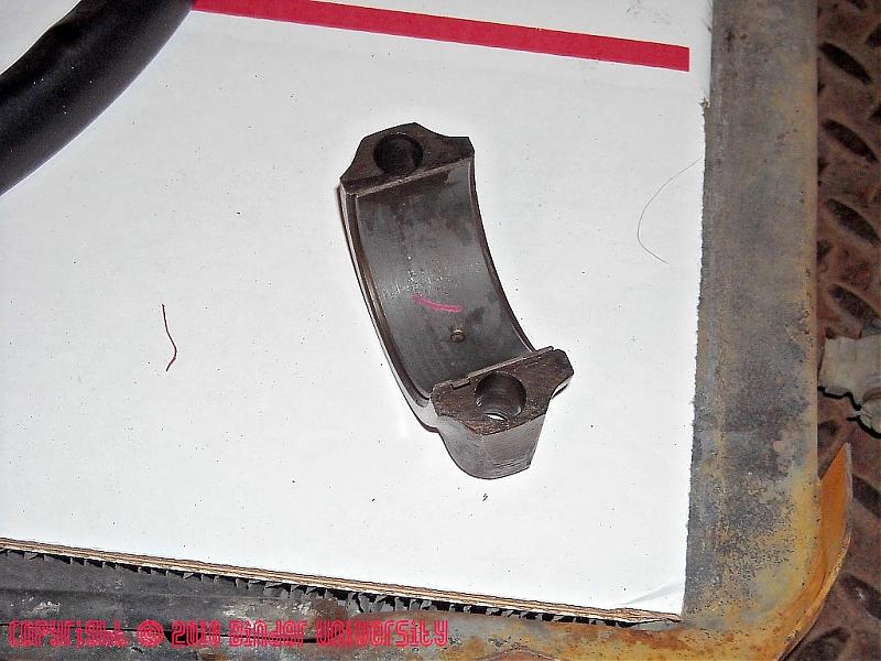

Mikee got started on engine component cleanup and removed all the bearing inserts so he could have some trinkets for posterity.
Turns out that nearly all the upper rod bearings had been shimmed with shim stock, when that was done (who knows when??), all the oil holes in the bearing shells were blocked!!!
I picked up the crankshaft from the machine shop last week, the replacement main and rod bearings arrived here yesterday, more on that later also. The gasket set is still a few days away from delivery.
