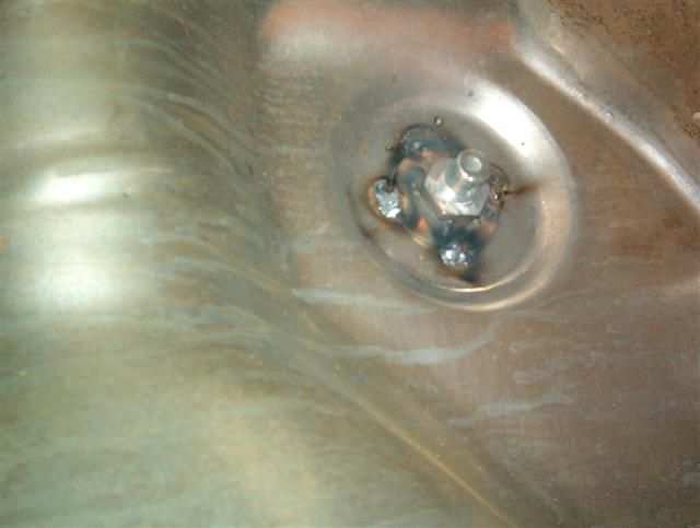

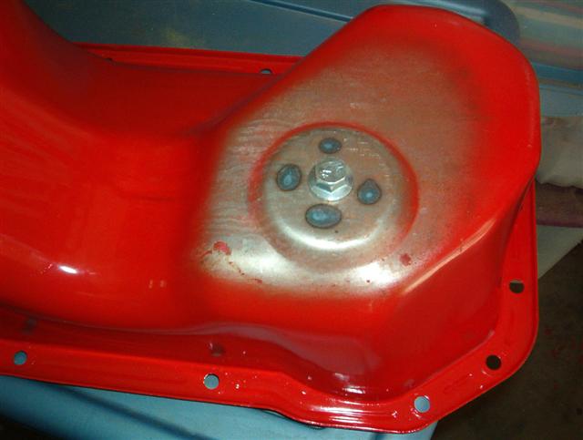

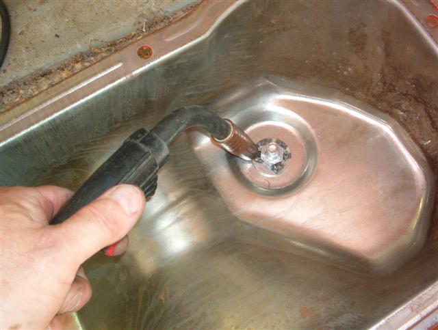

My '80 had the "reduced to one plug". I drilled out the depression and welded in a suitable nut slit widthwise to reduce its height. I'll try to post pics later. The thought of always having a quart of cruddy oil left behind doesn't sit well with me. That means each oil change only gets about 75% clean fluid.
My '75 xlc had two plugs. Here's the fix in case anyone wants to know how (relatively) easy it can be.
