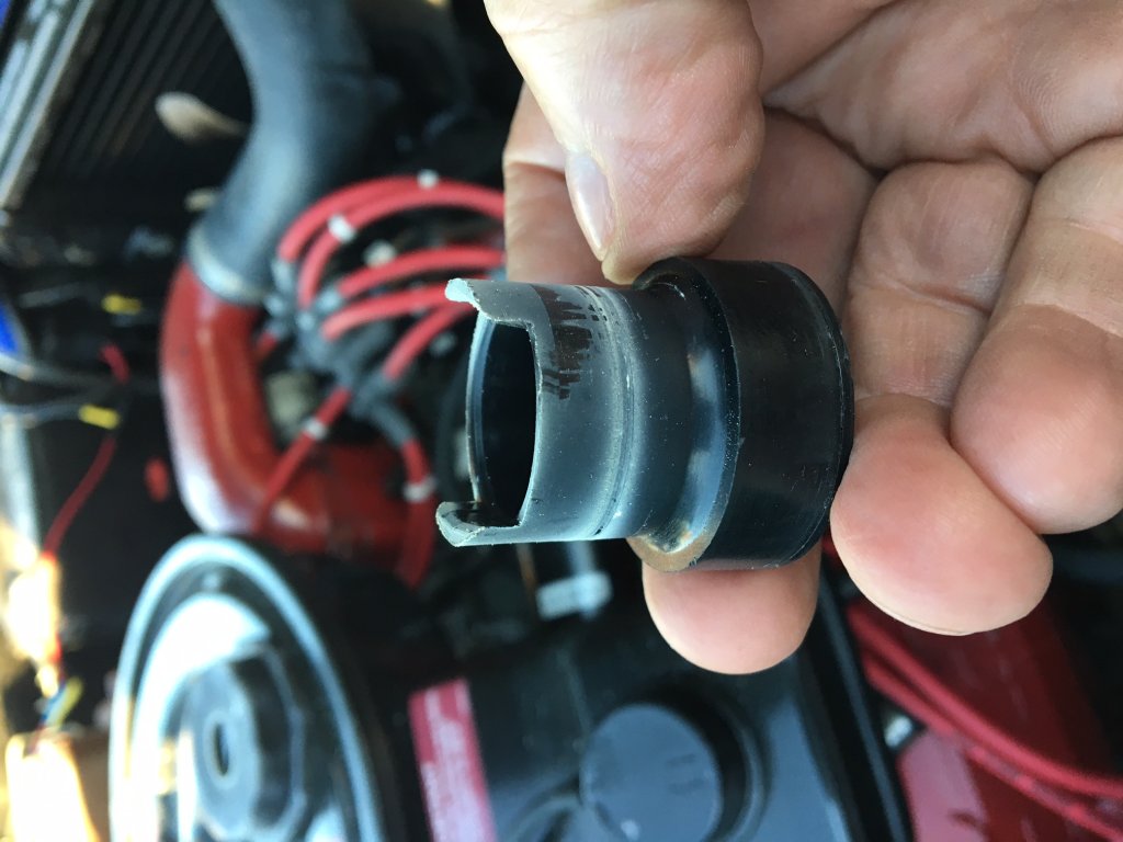

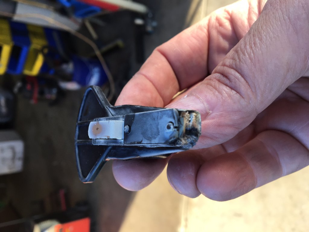

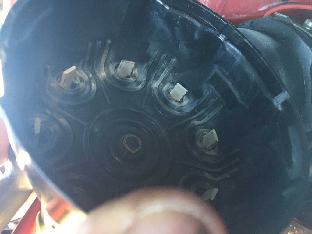

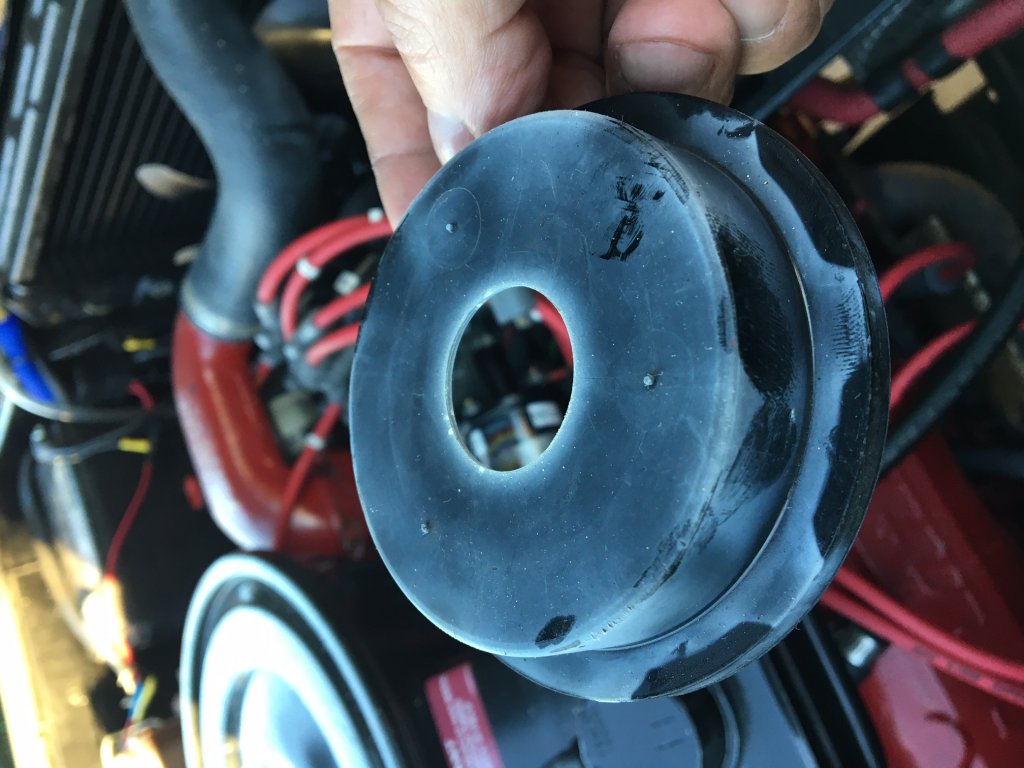

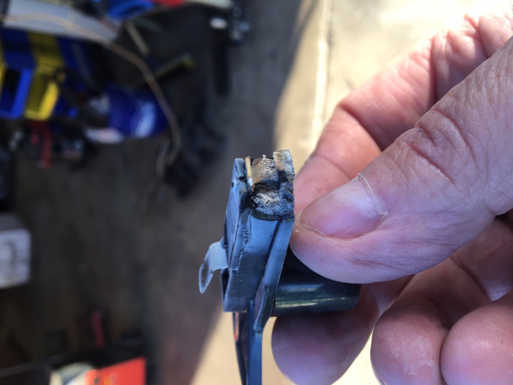

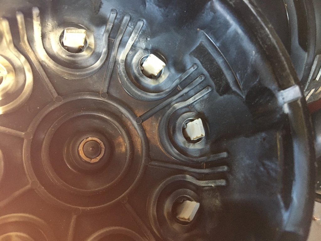

Ok folks, this is what I have as an update:
Please look at the attached pix. This is on my 79 Traveler, new engine (about 50 hours of garage running), TQ, P/s. P/B, A/C, Tilt, TF 727, D44 front and back with TruTracs, Prestolite Disto with Pertronix I / Pertronix 1.5 ohm coil, timing at 10 degrees, vacuum at 18.
I installed a new rotor, cap, plugs, coil based on the above thread, previous discussion, and comments. The truck since installation has MAYBE 15 miles on it. WHAT GIVES? if you will look at the rotor, it looks fried! there has got to be something that is "cooking" the rotor like this. As I mentioned before, I am not an electrical genius. most of this stuff is pretty straightforward.
The Traveler starts right up and runs fine: for a while, then starts sputtering, similar to a bad carb adjustment. I am having a hard time understanding that it might be a gap issue with the rotor/cap, as mentioned above. Could it be the plug wires (resistance)? I am running MSD 8.5 superconductor wires that are (per vendor) RFI compliant. Is there something else that could be causing that much current/voltage to "cook" the rotor?
RE: the coil - it is a new Pertronix I, there 4 wires going to it - two from the Pertroinx, one to the tachometer, and one to the bulkhead. According to the shop manual, That's it.
Sorry to be a dunce, but this is really bothering me and I could really use the help.
Richard

Mr. Kenney:
re: your mention of the "phasing" issue. I am a bit stumped on how the disto gets out of phase, to begin with. I read the linked article and I am trying to understand. AS I have never seen this issue before, I am kind of lost. I am going to do the "hole in the disto cap thing" today and will report my findings. This issue is occurring on both of my Scouts the 77 and 79. The 77 is not so bad though. Both have Prestolite disto's.

#1 - do you have the correct distributor cap? Holley cap has female terminals and Prestolite cap has male terminals. I have not seen a photo of the cap/terminals. Can you provide a photo?

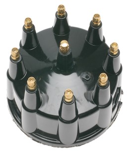

NAPA Distributor Cap p/n AL162 for Prestolite distributor photo below......
1975IH200:
yes to #1, I have the correct cap. I have run this Prestolite disto for 25 years with no problems. All of a sudden, I am having problems. Since I had all day to play with my toy, I decided to check the "phasing" issue as mentioned in the above thread. Yup, I do have an out-of-phase situation. The rotor is sparking between the #8 post and the one before it. CRAP! I do not know how this works or how it came to be, but it is there. Just out of curiosity, I move the disto one notch over to see if that would clear up the issue, NOT! So- I am stuck with this problem. I have to find a disto shop that does this kind of work. CRAP! My problem is that I have this very same issue on both of my Scouts, a 77 and a 79, both with Prestolites, both with Pertronix. CRAP!!!!!
#2, I did ask Pertronix this very question re: the MSD wires. They are ok to use. But I need to call them back in the morning re: clarify the MSD wires.
I am really stumped re: an out-of-phase disto. I just do not know what the hell is going on. The Prestolite disto is a very straightforward design. The entire shaft is one solid piece and the only movement is the center weights springs. I am totally out of my comfort zone as I do not know how to fix this.

good morning, and thanks for the reply.
1 - this disto (Prestolite) is an original one and has not been touched inside, other than my cleaning it and making sure the springs, weights are freely moving. Checked for bushing wear, all good.
2 - the disto rotor only fits one way as it is notched to the disto shaft. I have also checked the disto caps, all are the same re: precise location of terminal posts.
3 - yesterday, thinking that I could move the disto forward/back one tooth on the shaft gear, I did that. No difference. Put back to original, 10 degrees. Starts right up and runs fine - until it starts sputtering (like a bad carb adjustment)

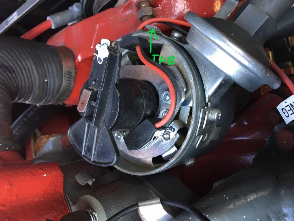

4 - The pertronix module and plate are a direct bolt in, there is no adjustment of the plate as it is secured by two screws from the side of the disto body. The only movement there is the vacuum advance when it kicks in. I checked that, and it moves freely as it should.
5 - Attached is a pic of the disto with Pertronix module.
yup, I am really, really stumped. What I am going to do is take out the Pertronix modules and reinstall them. Maybe I did something wrong, but I don't think so. I will report on progress.

Please don't take the following as nasty, I need to say this, rotor phasing has nothing to do with anything outside of the distributor.
The burning is because the plastic is being burnt by the spark not having a straight line of sight path from the rotor to the cap post. Once the plastic becomes burnt it becomes low resistance and is then part of the path for the spark.
Richard, At idle how big is the gap from the rotor conductor to the cap conductor during your phasing test?

Good morning all:
this is a 1979 Scout Traveler - 345, TQ, 727 TF, P/S, P/B, A/C, Tilt, D44 front and back with TruTracs, 2-inch lift, Firestone 33" A/T's.,
Running a Prestolite disto with a Ptron I and Ptron coil. Timing is at 10 degrees. vacuum is at 18 steady.
! - the position of the rotor during warm idle (with the vacuum advance disconnected) is right between the #8 post and #1. What I did also was pull out the disto and went one tooth over. Same issues, only different position.
2- I called pertronix and talked to their "tech" guys. I sent them the above pix as well. I asked about the MSD 8.5 Super Conductor plugs wires, they said that was not the issue. They are supposed to be discussing with the other "tech" guys at Pertronix. They are supposed to get back to me this week.
3 - I called MSD/Holley and asked about the RFI issues re: their plug wires. They stated that the wires that I have are not solid core and are RFI compliant.
4 - What I am going to do this weekend is this: I have a spare Prestolite disto. I am going to pull the one in the 79 and change over to the spare, then reinstall and see if the problem is the disto (being out of phase). I really don't understand the "phasing" issue, but if the issue still exists, then there is something else wrong. I can't see two disto's with the same problem.
5 - Re: the plug wires - I will change them to a stock set of original IHC plug wires (old school) that I have never used as I have 4 sets of them, but I don't see that as an issue, but it is worth a try.
6 - Re: any mods or additions to engine before I was having issues? I do not know as this engine was just started in January this year after sitting in my garage since 1987. I bought it new from IHC and has never run until January this year. When I got it running in January, I was just happy with it running! It starts up fine and runs real nice (sitting in my garage). I did not notice this issue until I had the same issue with my other Scout II (77 with Prestolite disto). Re: the thread above - I was having what I thought was carb issues (sluggish running, hard to start, poor mileage) I had the Holley 2bbl. rebuilt twice, switched to another Holley 2bb., but with same issues. When the 77 died on the freeway, out of curiosity, I pulled the disto cap and found a similar situation with rotor. I thought that maybe it was the Pertronix module going bad, so I bought another one, but a Ptron II. It was at this time (out of curiosity) that I checked the disto in my 79 Traveler. That is when I noticed the gray dust in the disto cap and the burnt rotor. The rotor was not as bad as the above pix, but it was never under a load in the garage. I swapped out a new cap and rotor to the 79 back in October.
Hell, I was just happy that I got the 79 running and out of the garage. When driving around the block a few times, it started missing. backfiring. so, I pulled back into my driveway - and here we are to the present.
7- I wish I could post some videos of the engine running here, but apparently that is not allowed.
Anyway, sorry to drag on so long - there it is. Thanks to all for the input and help. I will post as soon as I can with updates.
IIRC many posts back, you rebuilt this distributor do you still have the oem vac advance unit. The indexing is changed by moving the "breaker" plate in these distributors to advance/retard the spark. So so if the mechanical or vacuum advance is not correct it will affect the indexing.
One sure fire way to fix it,
The tab on the vac advance locates the cap I assume. Move/enlarge the slot in the cap so you can rotate the cap CCW?, to the correct position as indicated in your phasing test. Add material to the slot so it can't move. Test. The proper phasing is past the intended cap post at full retard and the same distance behind at full advance.
Also make sure there are not any contaminants on both the rotating trigger ring and the ignitor sensing face.

You miss understood me. The vac advance base has a tab that sticks up that locates the clocking of the cap, right? (image)
The cap slot can be opened up to allow the cap to be reclocked to align with your existing rotor phasing. The spring clips might be strained a little.
