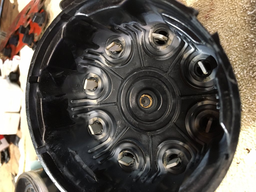

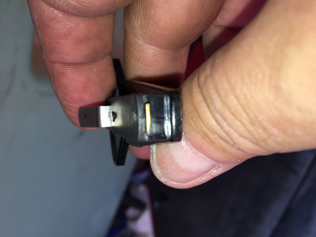

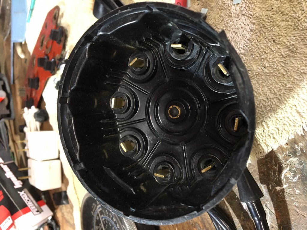

6 - Re: any mods or additions to engine before I was having issues? I do not know as this engine was just started in January this year after sitting in my garage since 1987. I bought it new from IHC and has never run until January this year. When I got it running in January, I was just happy with it running! It starts up fine and runs real nice (sitting in my garage). I did not notice this issue until I had the same issue with my other Scout II (77 with Prestolite disto). Re: the thread above - I was having what I thought was carb issues (sluggish running, hard to start, poor mileage) I had the Holley 2bbl. rebuilt twice, switched to another Holley 2bb., but with same issues. When the 77 died on the freeway, out of curiosity, I pulled the disto cap and found a similar situation with rotor. I thought that maybe it was the Pertronix module going bad, so I bought another one, but a Ptron II. It was at this time (out of curiosity) that I checked the disto in my 79 Traveler. That is when I noticed the gray dust in the disto cap and the burnt rotor. The rotor was not as bad as the above pix, but it was never under a load in the garage. I swapped out a new cap and rotor to the 79 back in October.
