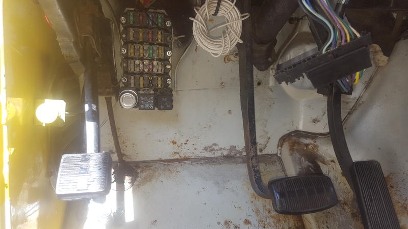

Welcome Randy
I recently rewired my own '72 scout II and, also, helped a fireman friend rewire his '69 scout 800. Both kwikwire kits, had the fuse block mounted on driver side under the dash
My own '72

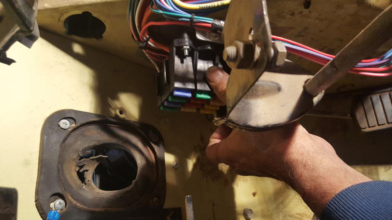

Friends 800
The photo somehow got rotated. The old rubber boot is where steering column goes into. The funk empty hole right above the fuse block, was old wiring bulkhead connector, which I used to mount a rubber grommet in order to route the wires for engine compartment, headlights and taillights.

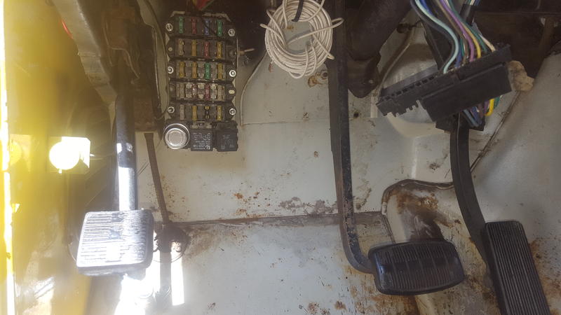

Welcome Randy
My own '72

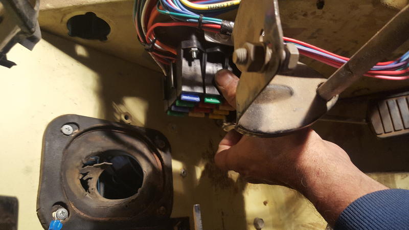

Friends 800
Thanks for the info on the fuze block install. On your friends 800 did everthing fit up under the clutch? There isnt as much realestate under the dash on this 800 as I remember on my travler.
On the fuse block install in my friends 800, it's mounted on the side of the transmission tunnel, just under that one hole where one of the OEM bulkhead connectors used to be. That photo, I posted earlier, was rotated somehow when I posted it.
