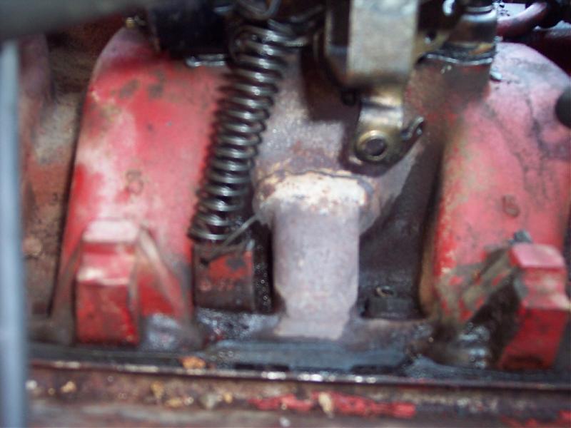

Attached is a photo of the crack in the intake

But..since you are buried in this deal now and have multiple issues to deal with, I'd take care of sealing the top end completely and get that out of the way. Then drop that 4412 back on you will be able to start the motor and verify all systems, check for leaks after resealing, etc. Then ya can make a decision as to what to use for a carb. The 4412 will certainly start and run the motor, but performance will suk and most likely "tip-in" will be very frustrating.

That cracked heat riser casting is a fairly common occurrence regarding the sv intake manifolds.

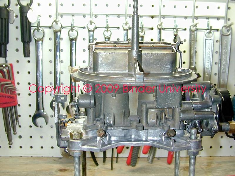

The 2300 mixer Jeff has on the shelf is a side-hung float version, oem carb. It was reconditioned from a really nice core in late September (by me) and is as fresh as a new one and is already jetted for any IH 304/345 app. Good 2300 cores that are designed for hot air/electric choke apps are very hard to come by these days, that one was exceptional.
A new 7448 would have absolutely no operational advantage over that reconditioned carb, and by the time it's properly set up/installed will run in excess of $500!
I deal with folks every day who are attempting to do this same thing on the cheap, attempting to use boneyard cores and even worse..."ebay specials" and end up with nothing but empty pockets and junk carbs that are only suitable as parts donors (maybe).
This pic is a companion mixer to the one on the shelf at ihon...a hot air choke (2300c) that has been converted to full electric choke.
