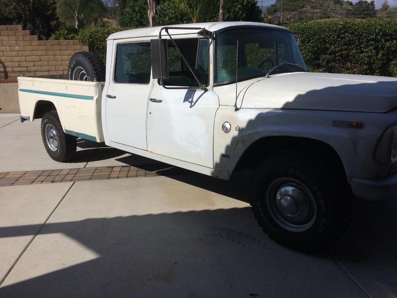

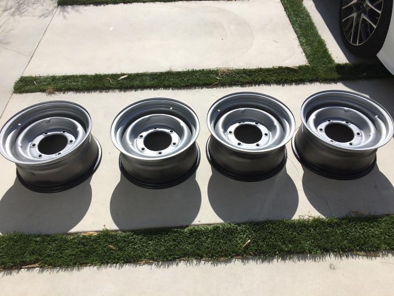

had these made by stockton.
attachment.php
attachment.php
What timing! Came here from google just to ask about those wheels: what did a set of 4 set you back? Also, can I assume you sent them 4 splits and they sent you back those 4 beauties?
I have used stockton wheel a couple times before and wouldn't hesitate to do so again, but these days I live across the country and have to think about things like freight when considering tco.
Yes, I sent them oem splits and they cut out the centers and built these to my specs.
To test them I sent one and had them build the first wheel ( spare in the bed mount). Turned out well so they got the job to build 4 more.
I recall $180/wheel in my hands.
Given my obsession to use the oem cap and the fact that I had two sets (one nos) of oem caps, the decision was made to go this route.
