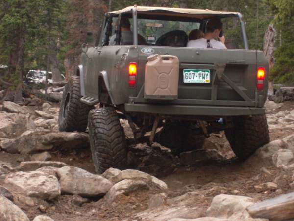

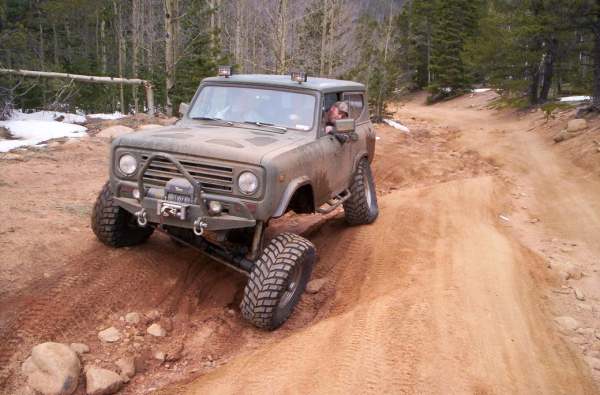

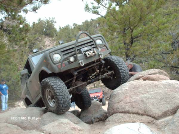

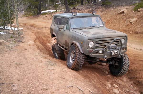

Very unique ride dude! How come we ain't heard from ya before???
That last pic with the kiddo settin' on the rock is priceless! You better watermark that one, someone will rip it off and next thang ya know it will be in some national print media ad campaign!

Totally f'n sweet! I love the hood ventilation. If ol' sarge got up in my grille and barked, "get down and give me twenty maggot!", you know, I think I'd comply with that very reasonable request. Thanks for answering the call.

the "kiddo" is my 10 year old son. He May actually enjoy wheelin more than me! He's been wrenching with me since he was 5. Gotta bring em up right ya know!

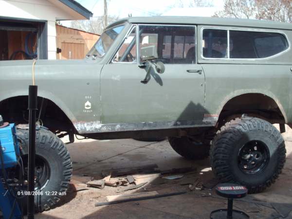

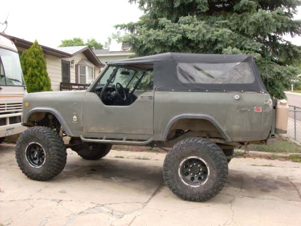

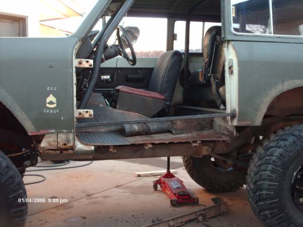

Flares are actually early Bronco, 3" cutouts from 4 wheel parts. Trimmed down since I removed the bottom 3 inches of the truck. (I actually removed the bottom 7 inches of the cab:yikes:, and built my rockers out of boxed 1/4" 4x4. Had to shorten the doors by 4" also, but everything worked out in the end, :thumbsup: and I have rocker clearance and protection galore!

That is some good work man, thank you for your service to our country good luck with the rest of your build (as we all know is never quite "done")
Thank you jayman... I think that once it's eventually on rockwells and 46" lmtv tires it May in fact be done!:ihih:
until then, we'll keep wrenchin'.
