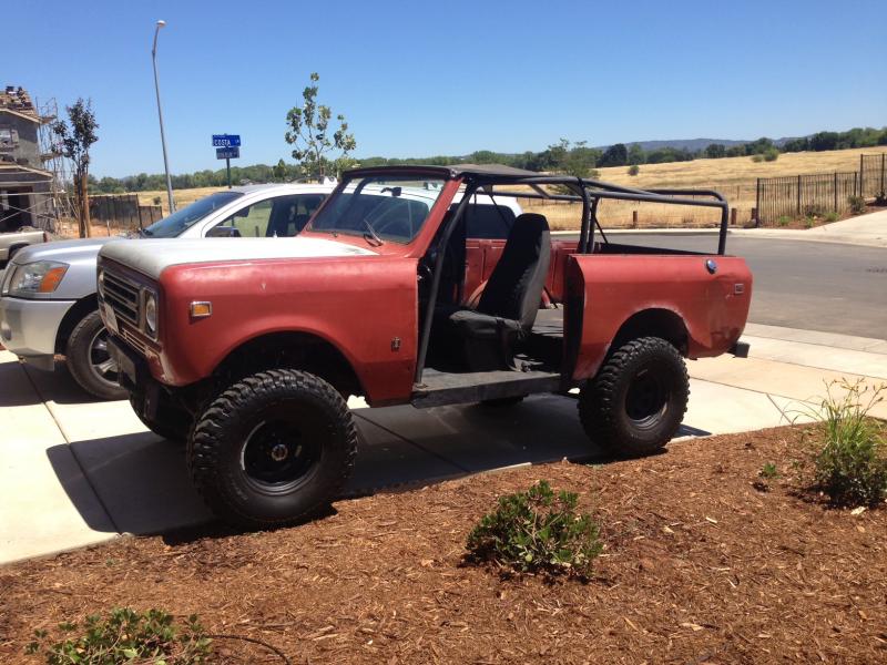

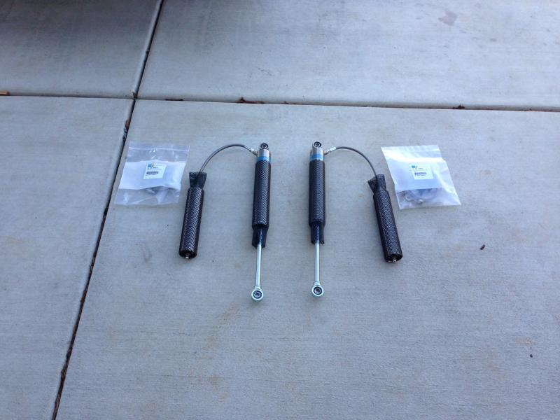

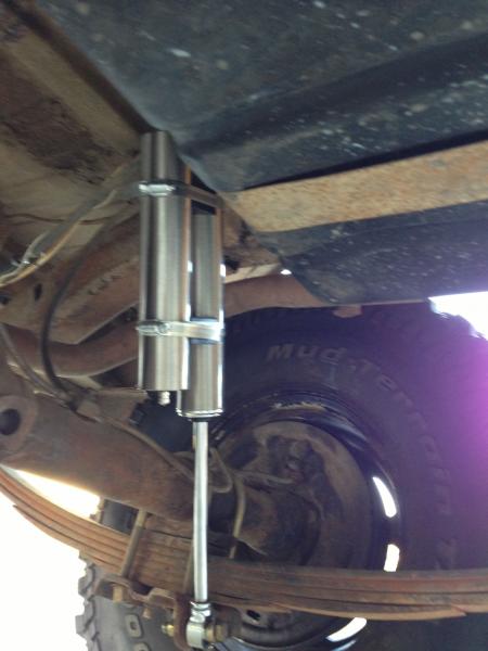

My '78 is getting a set of #7100 Bilsteins
Wow, nice pics. Very thorough.

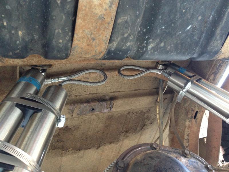

I see you don't have the factory skid plate around your tank. If I'd gotten shocks with reservoirs I would consider mounting them one over the other on the forward surface of the skid plate. It'd be a nice solid, out of harms way location. Without that option though, I don't know. Maybe build a bracket that hangs down from the x-member?
Thanks! I just kinda threw them on. I wanna run tubing of some kind up near the tub but thats in time. My Scout aint equiped to off road yet so I got time. The p.o changed the rear gear ratio and never the front so I need to fix that first. Ive been lookin for a frame cause the p.o againg fuged it all up and bent it up front. Rat turd welds on the spring mounts stuff like that. Then shock hoops for the front. Scooter is gonna help me with that tho...wink,wink.
thanks! I just kinda threw them on. I wanna run tubing of some kind up near the tub but thats in time. My Scout aint equiped to off road yet so I got time. The p.o changed the rear gear ratio and never the front so I need to fix that first. Ive been lookin for a frame cause the p.o againg fuged it all up and bent it up front. Rat turd welds on the spring mounts stuff like that. Then shock hoops for the front. Scooter is gonna help me with that tho...wink,wink.

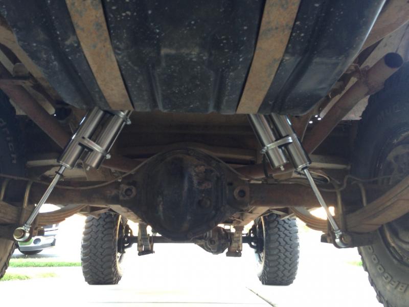

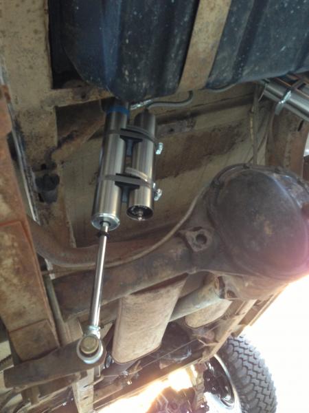

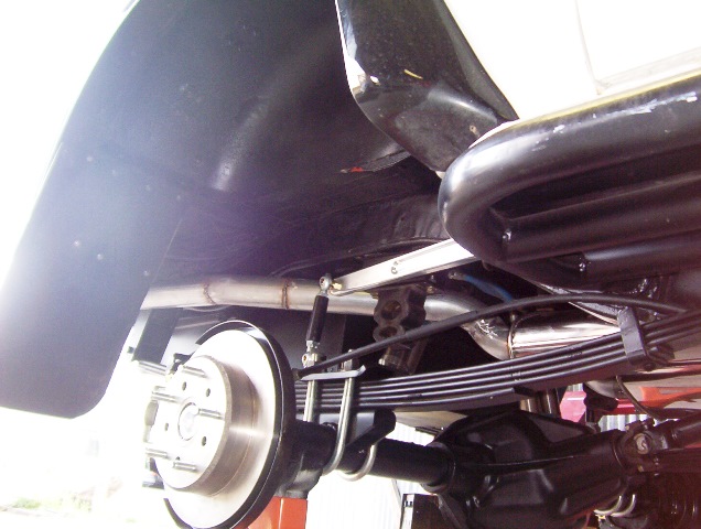

I personally have been running a set of 7100's for some time now on the rear of my white Scout and couldn't agree more about not only the quality of the shock but the quality of the ride as well. For those figuring out how to mount the reservoirs I have the left reservoir mounted to the right shock and the right reservoir mounted to the left shock. If you look close enough you can see how the hoses crossed each other. Sorry about the quality of the picture that I attached as it was the best that I could find.
On a side note I know it was mentioned earlier in this thread about whether we sell these as it is frowned upon to link products we carry to other sites. I'm somewhat ok with this on the 7100's since we don't stock them but as a Bilstein dealer we can order these in for you as well.

I'm using 10" travel in the rear and 14" in the front. From my research at the time these short body shocks were the longest travel shock that I could find with the shortest overall length.

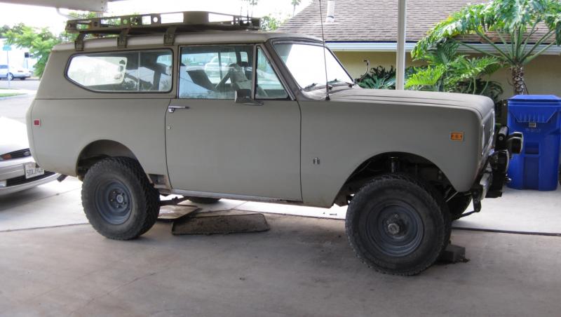

You can see how the front passenger side frame is slightly pushed back and the p.o added rock gaurds into the body on both sides. (welded) haha
Chico: wow you have a lot more lift and bigger tires than my Scout does. I kind of thought so from your earlier pics. There is a lot more shaft showing on your rear shocks than mine. Make sure they won't "top out" too easily.
That Scout should make a really nice trail rig when it's along a little further. Looks cool now though.

You think so? It's only a 3 inch lift on 33. I haven't fully cycled the rear yet. And they are connected to the stock spring plate. I guess we will see. Might be using the 10 in the rear. Lol
Gotta be more than that, I'd think. My friend's Scout has (I believe) 4" rancho springs using 5" l shackles with his 33's. And he doesn't have that much clearance at the wheel wells. Either that or it might just be and odd viewing angle. And/or the shadows making the gaps look bigger.
Just for fun, you might want to measure the distance from axle tube to the frame rails at the front and rear, and post the dimensions here.
edit: Chico, I looked at your earlier pics again. Your rear shocks might not be as extended as I first thought. I think it's partly just the perspective and angle of the lens in those pics, plus your stock spring plates have the shocks dropped a little more than do my spring plates by about 1.5".
Nice thing is, if you ever decide that the mounting points have the shocks too extended, it's easy to fabricate and weld some new ones a little higher. Having them higher up and more out of harm's way isn't bad. Better than if it was the other way around---lowering them would suck.
So last night I measured from axle tube to frame and in the front I got 11.5 inches and the rear 10 inches.
Wow, that's a lot more lift that I have. I measure mine at 9.25" for the front and 7.75" for the rear.
I've got the Skyjacker 2" or 2.5" lift kit (whatever they call it). Mods to this are: front springs have iho's 5" long shackles; the rear springs have Skyjacker's 'helper leafs' to boost the rate and lift a little.
So I figure I netted at least 3" lift over my old stock springs. Maybe a tad more than that. Here is how the truck sits. Tires are 31" generals.

One other update since I last wrote here is that I positioned my rear shocks to optimize the travel. Wasn't a hard thing to do.

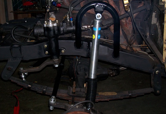

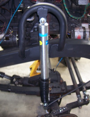

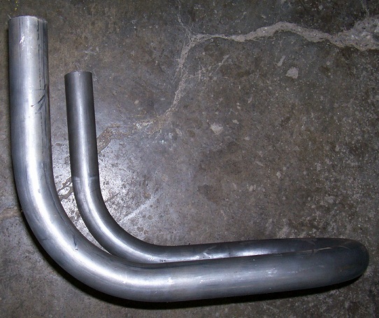

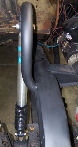

On the shock mount pics, sure. See attached. Since the original config was just a little short for these shocks, I put in new upper mounts to gain some length. The upper mounts, even moved outward as far as they'd fit, actually made the for slightly too much stretch. So I split the difference by changing the lower mounts. Simplest solution (and best, imo) was to weld on some 2" long .5" id heavy tubing to the spring plates. They make for a very solid mount. And as I've said, very simple in design. Didn't even have to remove anything to get them on there. Then I just needed to buy some longer bolts.
The beauty of this lower setup is, if I ever change ride height or shock type, I can always weld another tube above/below the existing one to make adjustments.

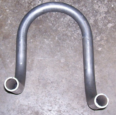

One tech tip. The Ford shock towers have holes that are less than 1/2" I.d. Do yourself a favor and drill them to 1/2" diameter before welding or installing. It was a pain to drill mine, after they were installed.
