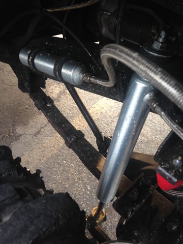

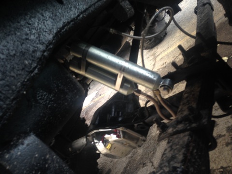

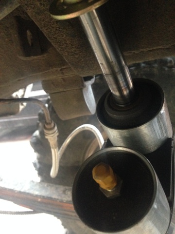

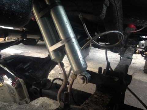

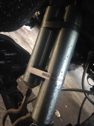

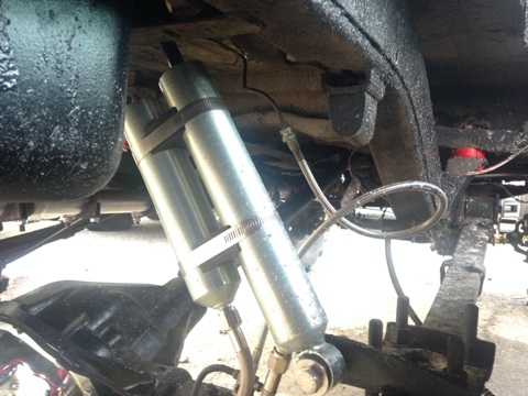

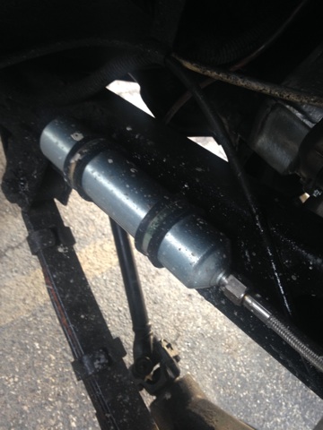

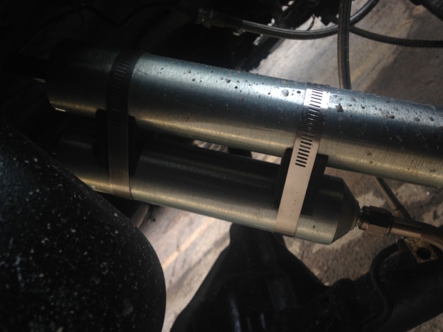

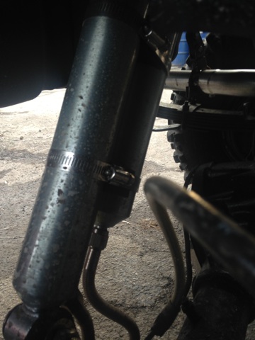

Im missing a rear shock and in search of getting the matching pair these are pictures of the current rear shock that is on there now I need a matching one for the rear driver side.
Without knowing part numbers or manufacturer, it be rather difficult to match up one shock to what you currently have. Might consider ordering up a new matching pair so you know exactly what you have.
We don't know. You should try to contact the person who purchased/installed them for info. They are clearly aftermarket items. Have you noticed the severe angle that your stock front drive shaft is at? That ain't good at all. You're gonna need a custom drive shaft with at least one cv end. I strongly advise you against operating this vehicle in 4x4 mode as it is now. Whoever did the "monster truck" style lift on this looks like they maybe got in over their head and either didn't know what they were doing, or ran out of funds to complete the job properly.
