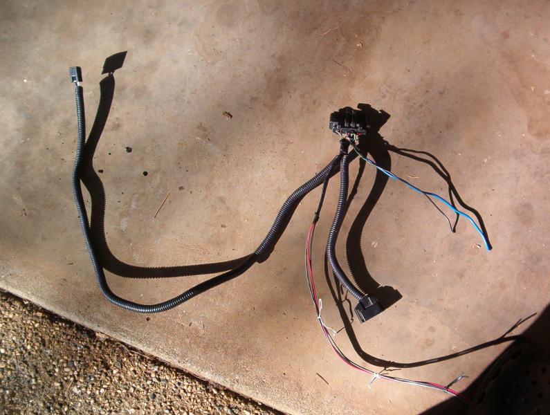

More progress while awaiting my module. Wiring harness: blue and black wires to far right are the power and ground, second bundle from right with plug feeds the coil pack, next bundle is the shielded signal wires ("pip and saw"), plus power and ground that will go to the mjlt, which will mount inside the vehicle and under the dash. Far left bundle goes to pick-up sensor for the crankshaft trigger wheel.

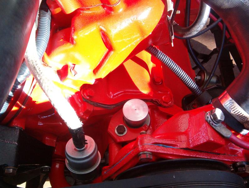

Also a pic of the "dummy drive" mounted in place of the distributor. This will drive the oil pump. IM002195.jpg

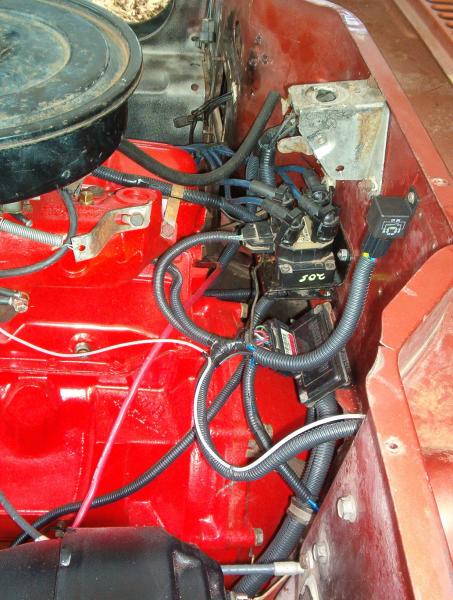

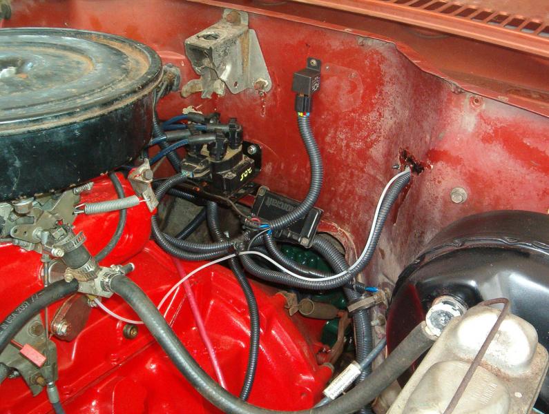

Here's the wiring finished in the engine bay. I soldered all connections instead of crimped, then wrapped with harness tape, and then put looming over it all. I still need a 1" grommet for the firewall. All that's left is mounting the controller inside the cab. I plan on mounting it on the underside of the heater duct. The white tube is 1/8" nylon tubing (mechanical oil gauge) that I tapped into the huge vacuum fitting plumbed into the intake manifold. The mjlt control module contains a map sensor and adjusts accordingly.
Regarding the relay. I "repurposed" the + lead that connects to the coil & distributor and ran it back through the its loom to the rear of the engine. The hot pickup that feeds the edis system comes from inside the cab, where it can be switched and pose a potential drain if the relay somehow sticks closed when it shouldn't be closed.

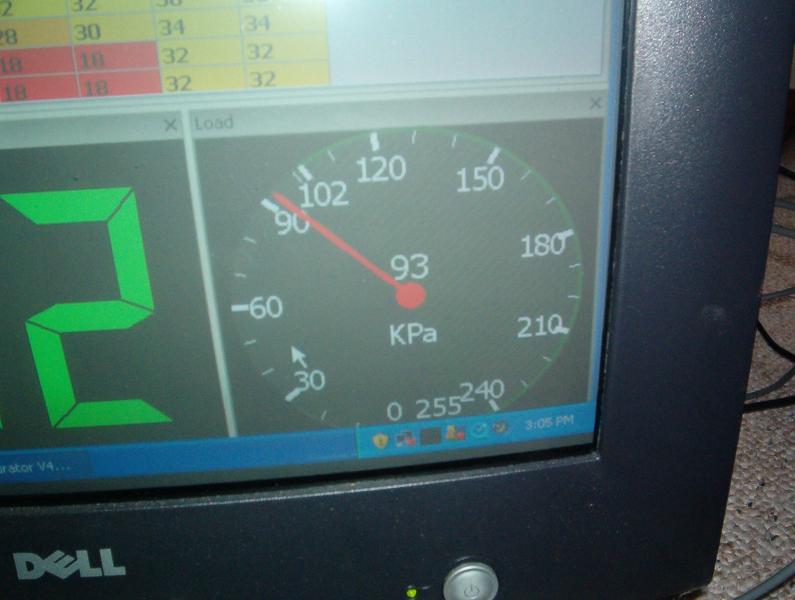

My mjlt arrived yesterday. I had a problem with my laptop, which put it out of commission. However, all was definitely not lost. I pulled an old dell full-size computer out of mothballs (in the garage) and hooked it up. Wonder of wonders was that I forgot I had a duplicate copy of all the mjlt maps and programs on it! So here's what you see in the pics: the mjlt, the cable that comes with it, and hooking it all up to a 9v battery and mighty vac to simulate changes in atmospheric pressure. Absent ignition signals from being in the vehicle, this proves it is communicating with the computer and is operational. You'll see the screen shot where simply being "on", you see "manifold" pressure of a tic over 90 kpa. 103 kpa is sea level, and as I live at 2,400 feet, you see it responding to that altitude. Excellent! Also a pic of it after giving a few squeezes on the mighty vac and reducing the pressure. I have just completed compiling the first iteration of the ignition map for this 196, and it is now loaded onto the mjlt. So after I finish the installation, which is only mounting it to the underside of the heater duct, and wiring in the power/ground/pip/saw onto the molex connector, and hooking up the 1/8" nylon tubing via a short section of rubber hose, I am done installing it. Plan on firing it up tomorrow.
It runs, but I've had trouble uploading some video to youtube, so as soon as I fix whatever the problem is, I'll get it here.

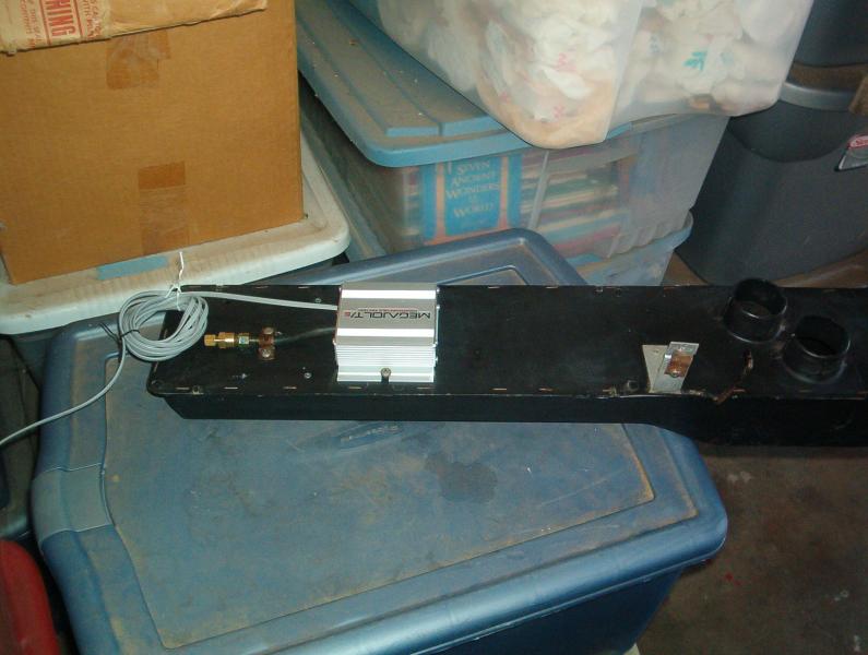

The engine runs noticeably smoother. I'm tidying up the wiring, as I had a fuse problem (need at least a 20 amp fuse to run the actual coils - I was blowing 10 amp fuses). Mounted the mjlt to the top of the heater duct so it's out of the way and not visible. I left the connector cable installed and coiled up out of the way. Hot feed to the relay is direct from the battery, as I didn't figure a way to run it through "switched". So as long as the relay never fuses itself, things should be fine.

Pick of it mounted on top of the heater duct. Power, ground and pip/saw feed are on a molex plug that will go into the right side of the unit; on the left is the rg11 plug for the communication cable, as well as the tubing into the map sensor. I took one of those standard 1/8" nylon tube brass ferrules to connect the nylon tube, screwed to a 1/8" brass fitting w/barb, short length of rubber hose into the map barb. I screwed this tubing down to the heater duct to keep it secure.
