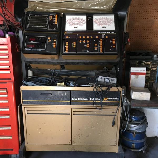

Looking for manuals for peerless 1200 engine analyzer

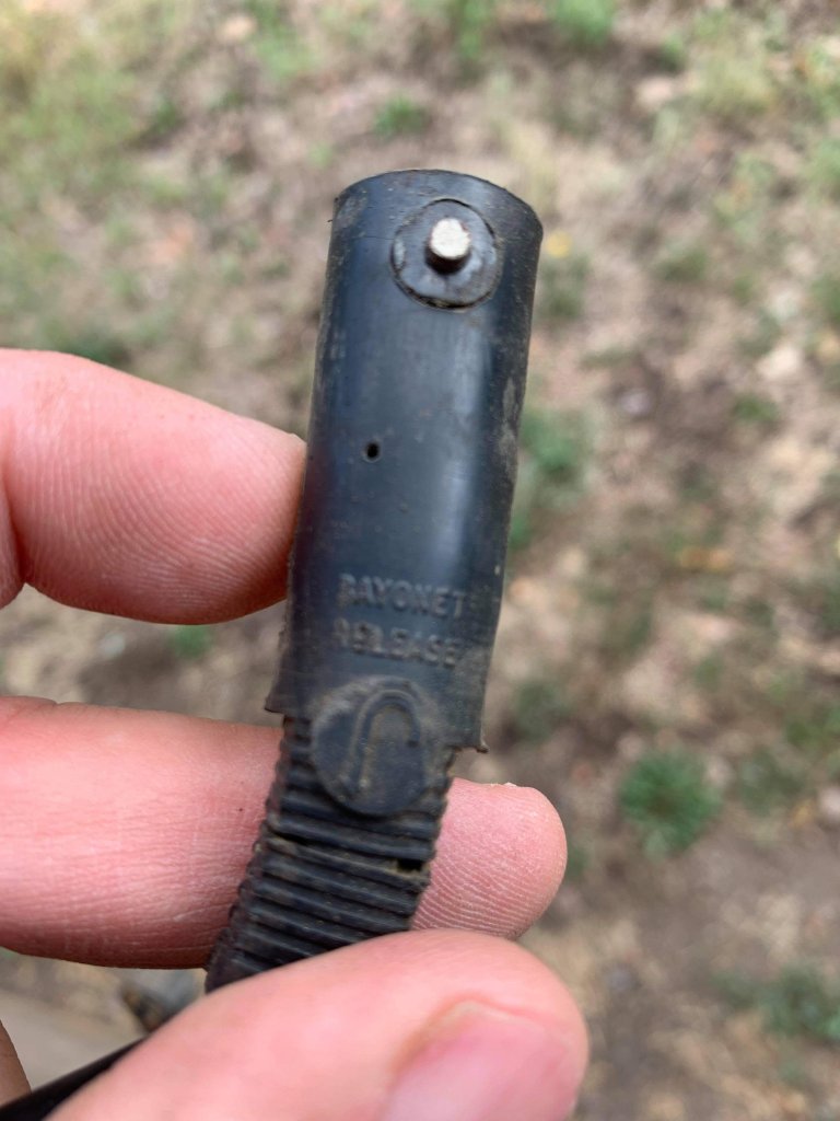

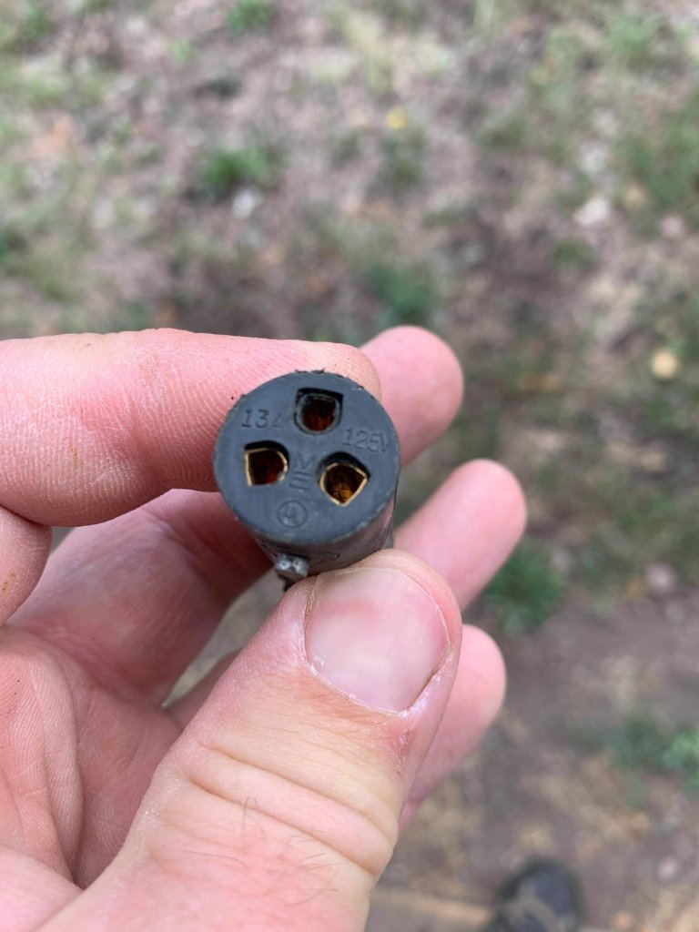

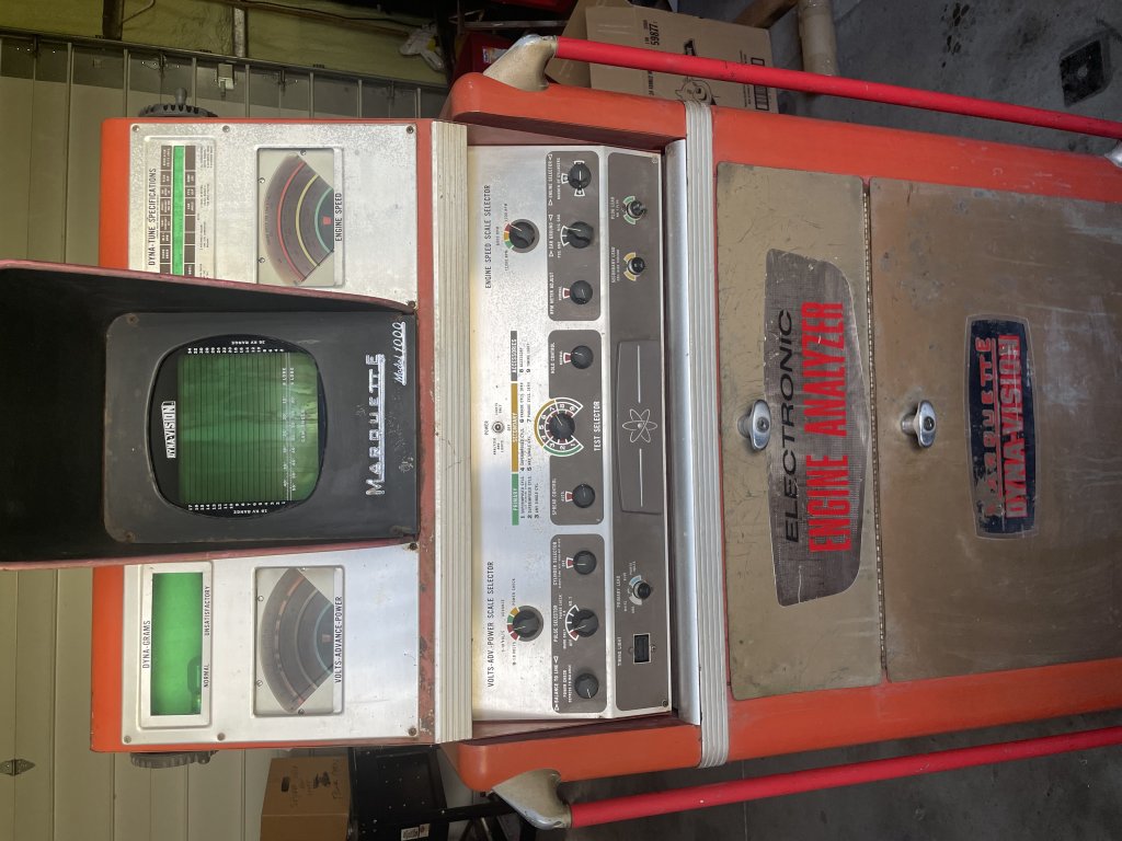

I recently purchased a Marquette 1000. I have yet to try to use it due to the main power cord and instructions are missing. It did come with the test result papers, a box of advertisement papers and a wall banner. If anyone can help me find the missing cord or the book, I’d greatly appreciate it. The picture of the cord is an example of what I need.
