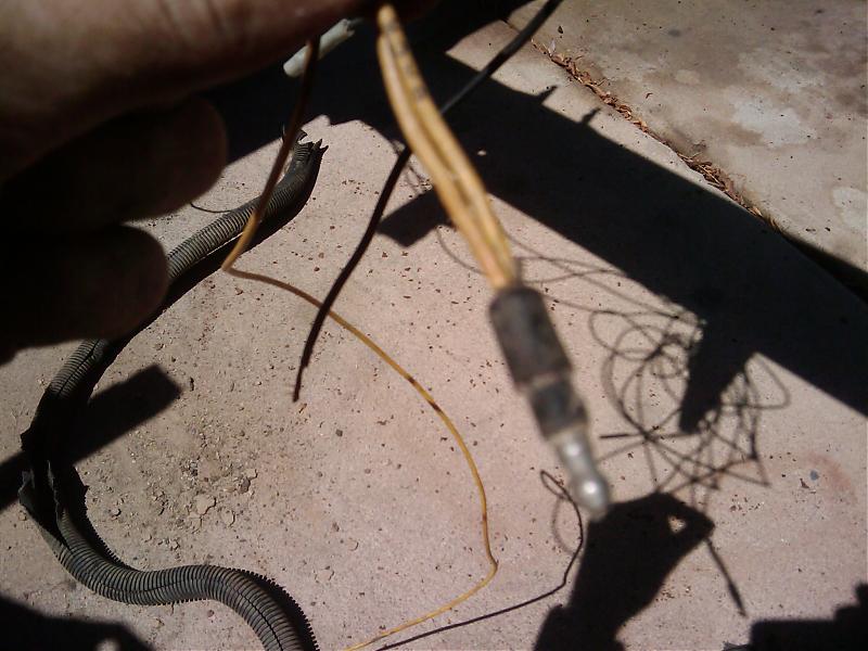

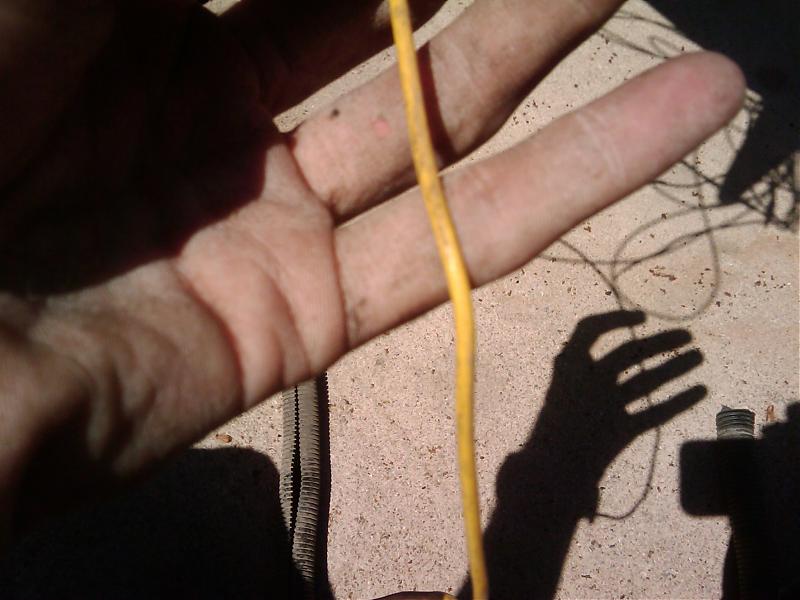

Now that I am in the right area, I have 4 black wires and 1 yellow wires with 2 ends on it, what do these wires do" I want to test them for funcinalty as I will be resuing this section of the harness. My exisitng harness is a rats nest with splices everywere, and this one is in near immaculate shape
You'll need to narrow this down some. Colors alone don't mean much. Any circuit numbers still visible? What gauges are the wires? Maybe a well-focused pic would help us home in.
Attempt number 2
all the black wires are the same gauge

I think we still need to narrow this down, when you say connect to the cab, do you mean coming from the dash to the engine compartment? Or are they coming from the engine compartment to the cab or dash? Can you trace the wire to find the other end and find what it is connected to?

Although the pic is a bit fuzzy, it looks like there is a circuit id number at least on the yellow wire. Any numbers that are still legible on the wires can be cross-referenced against the wiring diagrams and circuit id pages contained in the service manual for '69 thru '73 pickalls if you have one.
