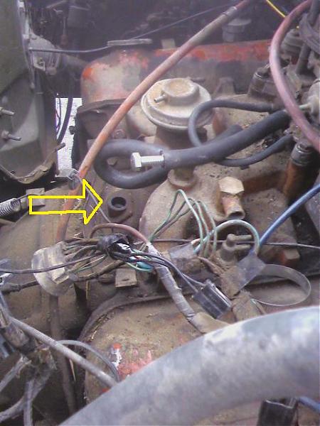

Large hole on back of valley cover
BigTallKen
I have a large hole on the back of my 304 intake valley cover.
It looks like it May be threaded for something..
Oil pressure sender? Vacuum port? Pcv?
Any ideas?
I have a 304 with a 2v carb on the stock intake manifold.

Ok, here's the pic.
I hope this helps.
There is one pcv valve on the drivers side valve cover. This hole is simply empty.
It is a 304 with a manual transmission.

Yep ken, that's a pcv location. I have the same on the 392 in hooty. The 345 that was in it before did not have that valley location. That engine had the threaded version on the driver side valve cover.
Nice pic! Trev discovered the same kinda swap around parts deal on hois motor!
There is a baffle spot welded to the underside of that valley cover, that grommet leads into the baffled chamber and must have a "throwaway"-type pcv in it. That is the "last gen" pcv system that lasted through the end of production of these engines around 1984 or so.
If the valve covers on your motor are oem to that item, then what you are discussing is not a pcv, it's a flame arrestor dude! Take it out and clean it, you'll see it's full of grunge which is hiding the frog hair inside. Soak in solvent and blow out several times to clean.
Then install the correct pcv in the grommet, the hose goes to the base of the carb where the the whitetrash "plug" is stuck in.
