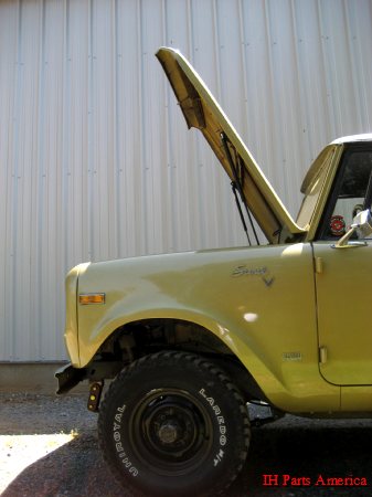

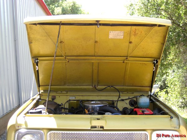

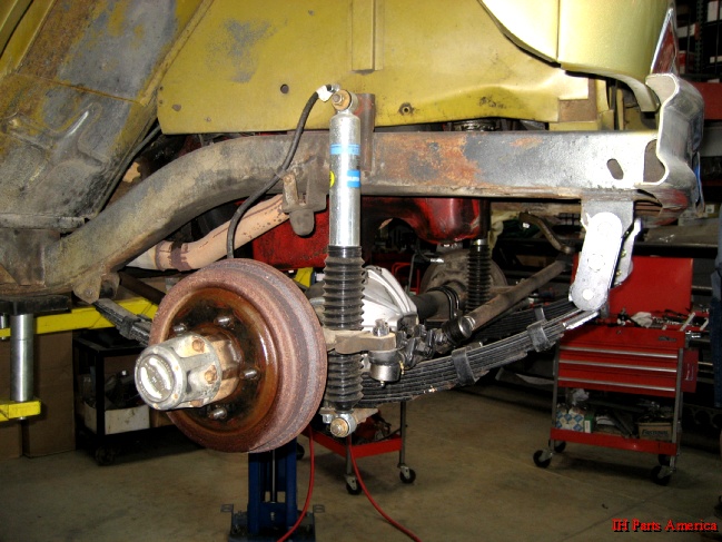

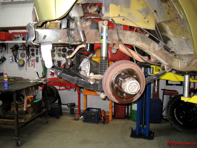

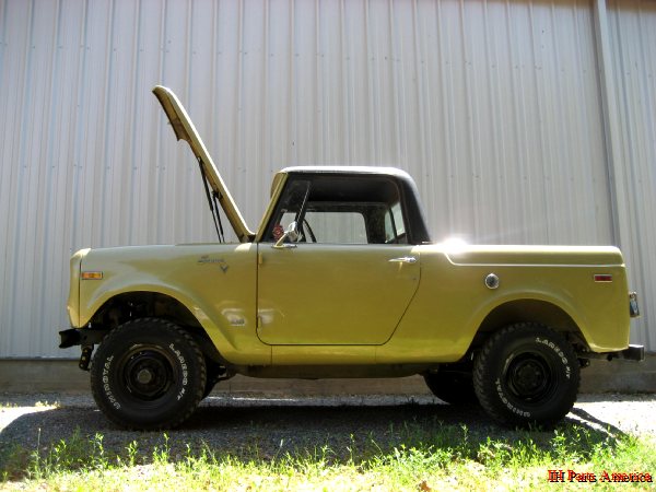

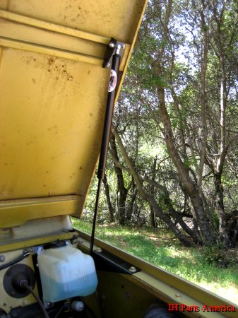

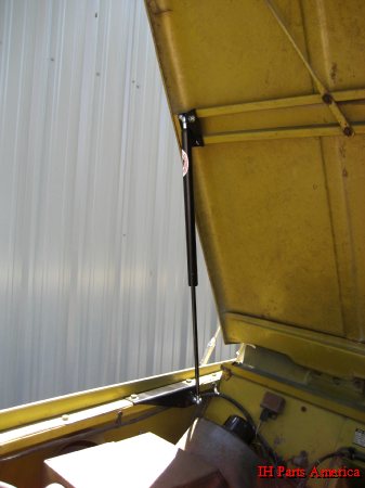

Got my btl - built to last hood lift strut kit for the Scout 80/800 from my brother Isa. After installing the kit in just under a half hour I must say this kit is worth every penny. Nice directions with color pictures made the install a breeze. And as a plus the hood goes much higher than before. These kits are sold at Isa's IH Isa's International Harvester: Scout 80,800,a,b hood lift strut kit Or they are also available on our online store - hood lift strut kit for 61'-71' Scout 80/800 - International Scout partshere are some pictures of the conversion.

Thought I would give you guys an update on Stumpy. Since the lift was installed and other work performed I've put a little over 1000 miles on the Scout and thoroughly enjoy driving it.

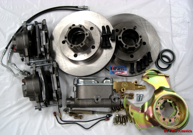

Through the years we have received a ton of requests for a disc brake conversion for the front Dana 27 or 30 axle in the Scout 80/800. We know that there are plenty of other retailers offering a front disc brake kit for the Scout but we found none offered it as complete as we would like to see so we developed our own. With how poorly Stumpy stopped it was time to perform a front disc brake conversion and at the same time also develop a kit that our customers could purchase from us and install for themselves.

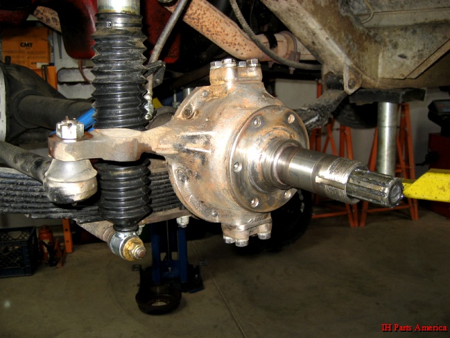

After putting Stumpy up on the lift first thing was to remove the tires.
attachment.php
attachment.php

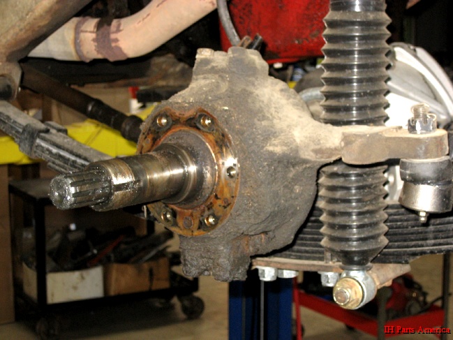

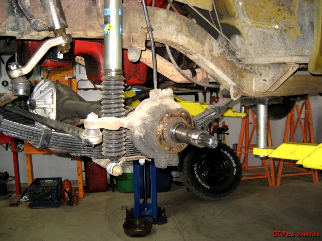

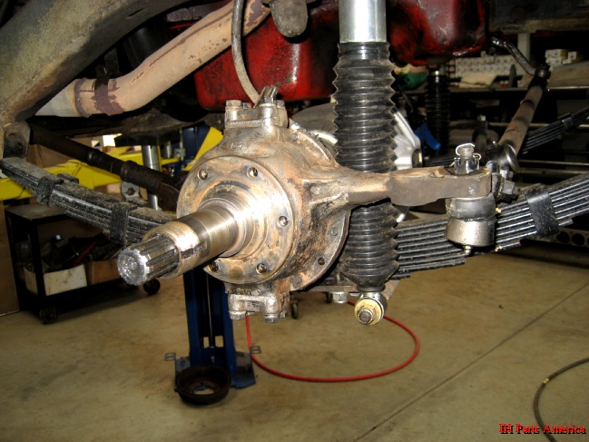

Next up the factory drum brakes were removed down to the spindle.
attachment.php
attachment.php
After that I spent a few minutes cleaning up both of the knuckles. If the knuckle seals were bad now would be the time to replace them. Mine were still in good shape so I left those alone.
attachment.php
attachment.php

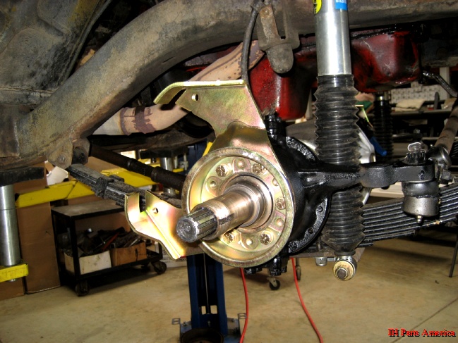

With the freshly applied paint dry on the knuckles the first thing to install were the caliper support brackets. New spindle bolts are included with the kit that we offer as they need to be longer than the factory original bolts.
attachment.php

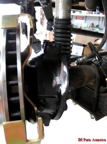

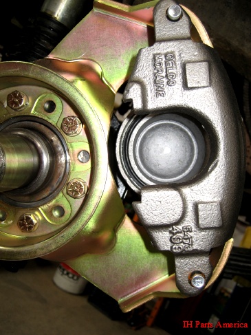

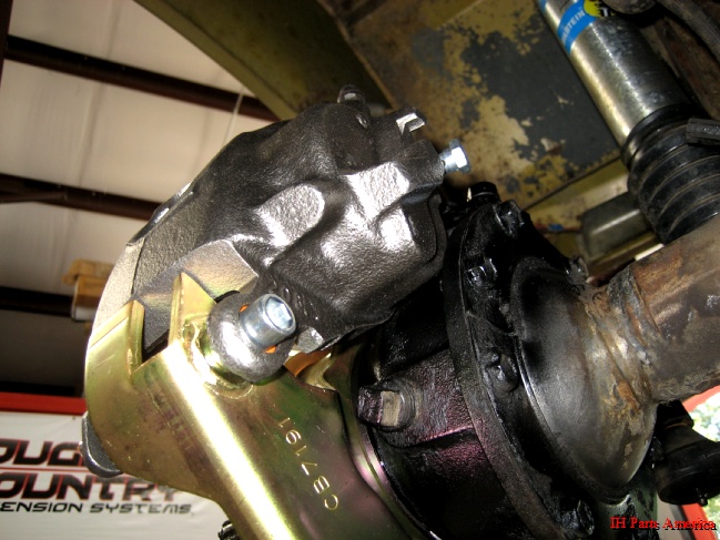

Next the calipers are hung on the support bracket to see where the knuckle needs to be ground on for proper caliper to knuckle clearance.
attachment.php
attachment.php
A few minutes with a flapper wheel on my 4.5" angle grinder and the necessary clearance needed was done on both left and right sides.
attachment.php

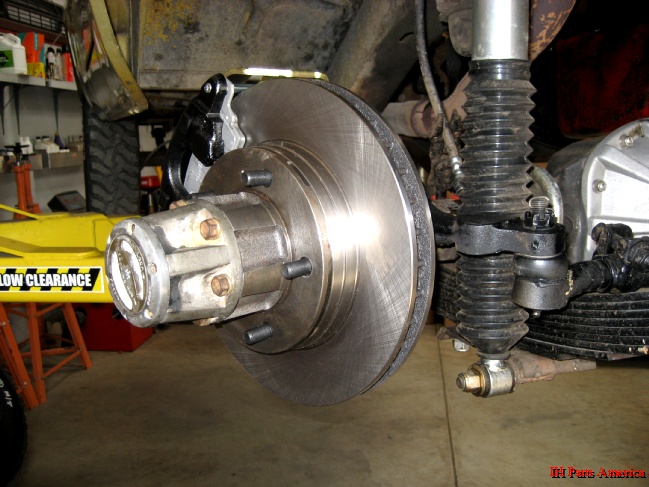

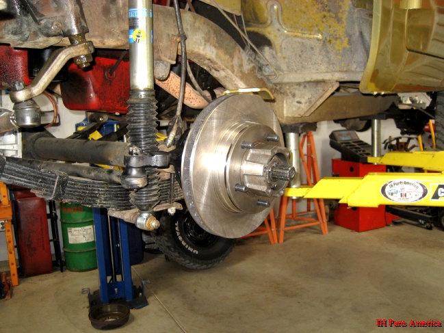

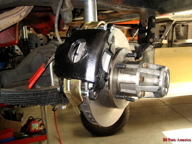

With the grinding done the new wheel bearing hubs and rotors were installed. Since my wheel bearings were in excellent condition I went ahead and reused those.
attachment.php
I then installed the new calipers and my original locking hubs bolted right back on.
attachment.php
attachment.php

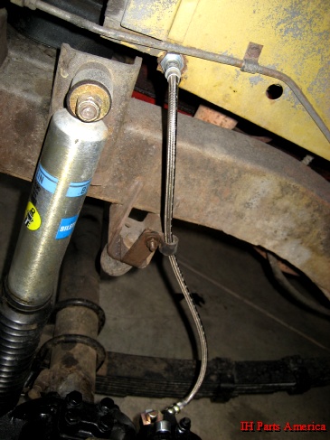

A phone call to my local brake line builder and an hour later I had brake hoses in hand that both had the correct caliper and hard line end to make it an easy direct bolt in.
attachment.php

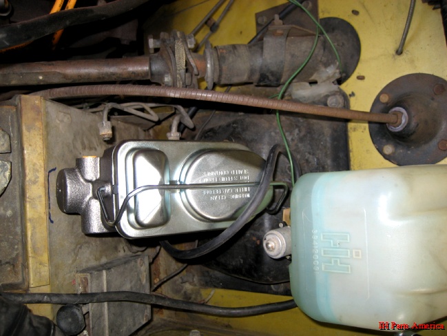

With disc brakes now installed up front a proper matching master cylinder should be installed and is also why we include one with our kit. We already sell a disc front/drum rear brake master cylinder for the Scout 80/800 so one was pulled from the shelf and installed. In order to bolt in the master cylinder some additional clearance is required between it and the wheel well. A few hits with a hammer and the needed clearance was obtained.
attachment.php

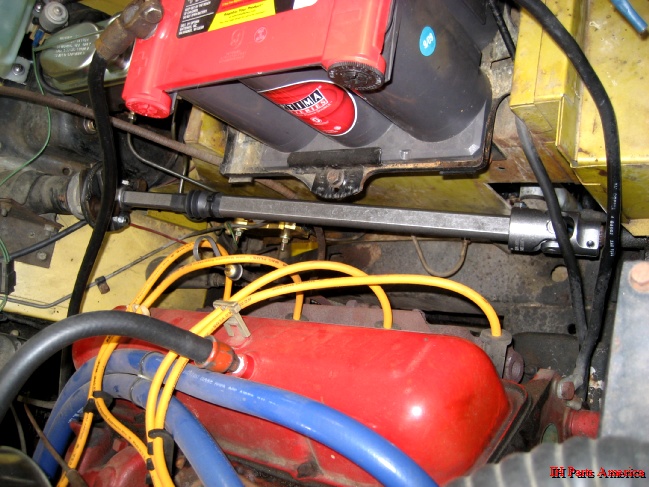

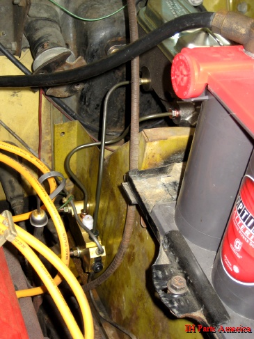

To top off the install and our kit and to make sure everything works correctly a proper brake proportioning valve for disc brake front and drum brake rear was installed. Later Scout 800's originally came with a distribution block while early Scout 800's and 80's with the single reservoir master cylinder only had a basic junction block. Upgrading to a proportioning valve is a huge improvement over both performance and safety. Our kit will also include pre-bent brake lines from the master cylinder to the proportioning valve.
attachment.php

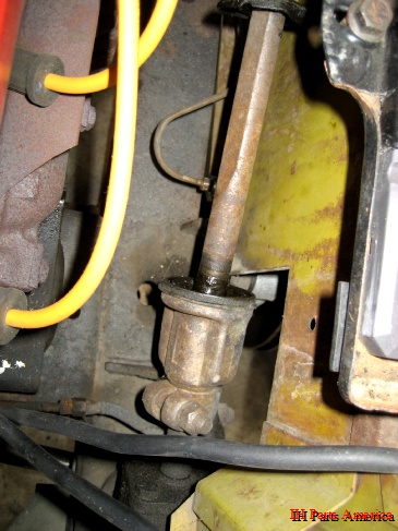

For easier access in installing the proportioning valve I removed the steering column. Since my bell joint boot was missing and the column was out I decided to go ahead and install one of our borgeson column kits.

For those interested in our disc brake kit we have them available for the Scout 800a and 800B. For those with a Scout 80 or early Scout 800 with single reservoir master cylinder additional brake lines will be needed in order to perform the install.

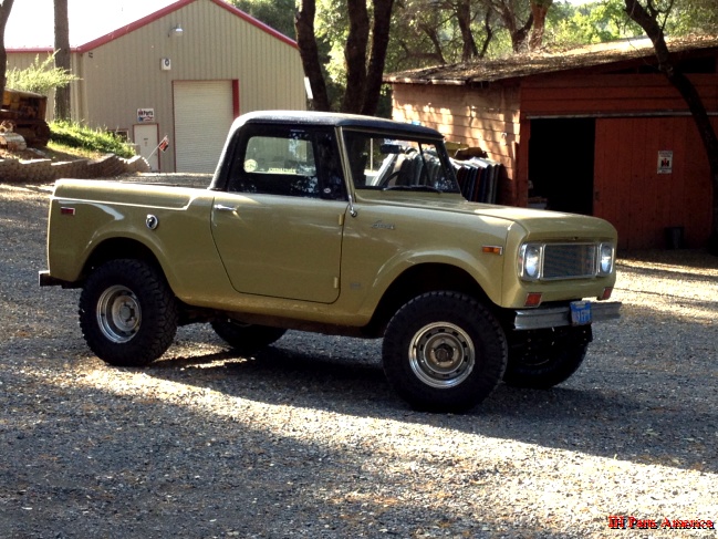

Earlier in the month I took Stumpy on a trail ride up to fourdyce lake. It was really nice having the new extra stopping power.
