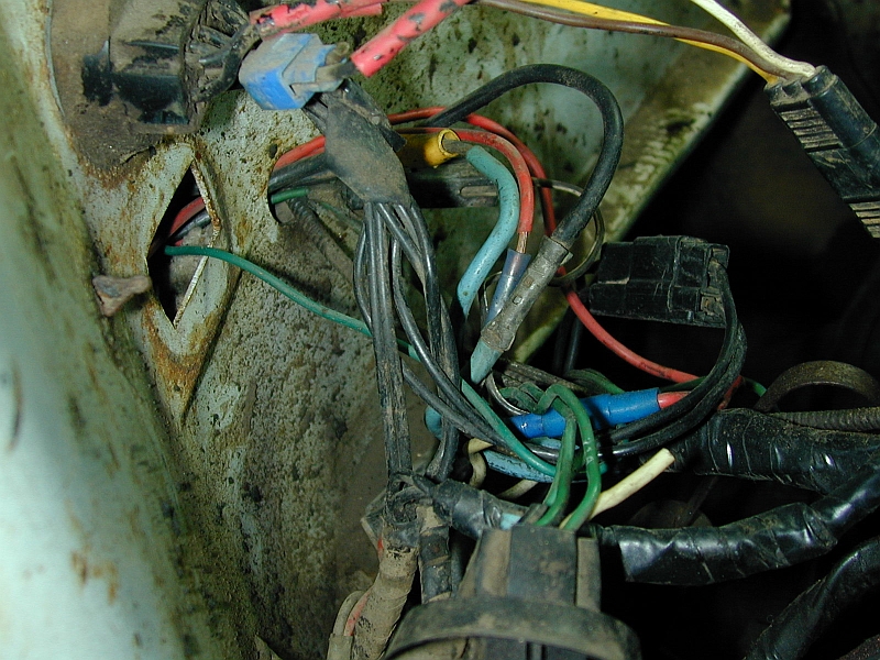

Attached is a pic of an early sii with possibly the worst botchjob on one of the bulkhead connectors that I've delt with in recent history!!! A large portion of the resistor wire had been taken out and a piece of 20 gauge (!!!!) spliced in with scotchloks! And ya can see the 10 gauge main feed has been butchered too! This one had a resistor wire circuit meltdown right in my parking lot and actually caught fire while we were bs'n over the open hood!
All of this was delt with in a very "poorboy" (but safe) manner so that the owner could make it home. I simply installed a proper "used" resistor wire I had on hand stripped out of a melted wiring harness (I don't throw anything away!), and re-worked all the real trashy splices that had been done over the years. You can see that many po's had tried to bypass the bulkhead connector over time. This one is a prime candidate for a total re-wire! Ya should see the reat of the story!
