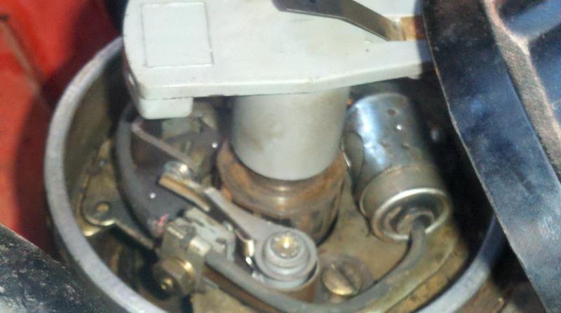

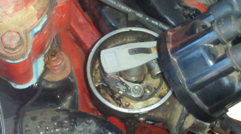

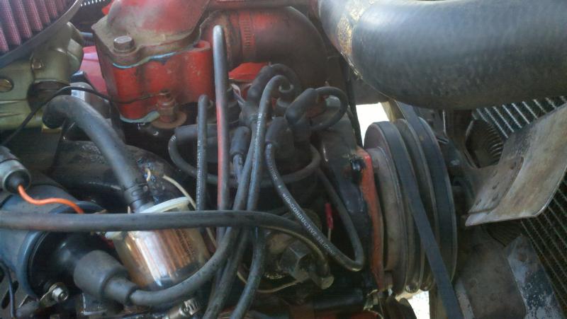

Thanks scoutboy, heres those pics you were talking about.

That's a Holley curved points distributor. There is also a straight points version that was used in IH engines as well.
