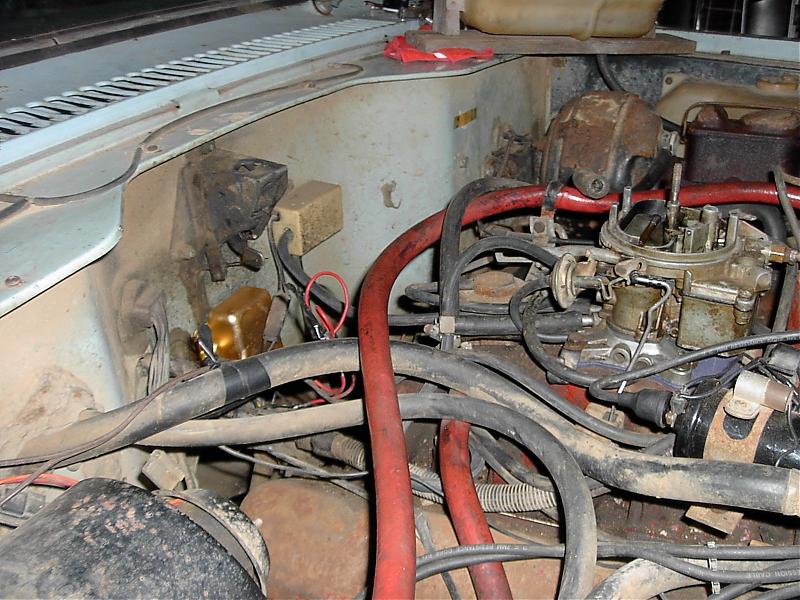

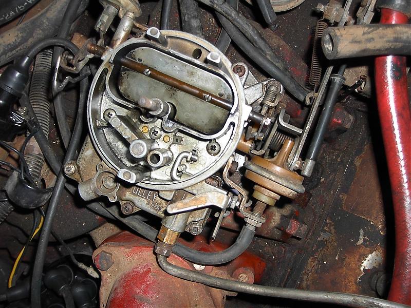

Brand new battery, but I did give it a little tickle charge for a good measure. Here's pic of the carb. I going to pull the plugs tonight and see if they are gumed up? They are new thats how I got it start before. The motor has been sitting for so long the other plugs had sh-t all over them. I was hoping by running the motor for 30 min. It would have clened the cyclinders up good?
