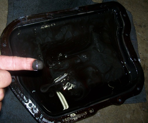

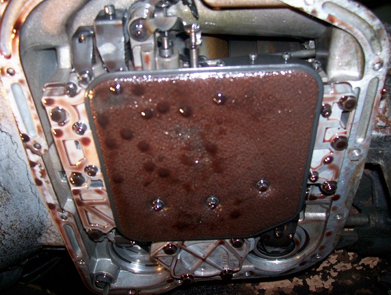

Here's two examples of signs of needing a complete over haul.
attachment.php
attachment.php
This was taken from my 72 ole yeller. Along with the stinch of burnt oil. As trevor mentioned, it May be difficult with continual addition of go go juice when you're dealing with a leaky trans. Another issue I had from a shop rebuilt 727, is the 3 pressure ports. The shop had their heads up their butts and forgot to tighten up all 3 threaded plugs. So that might be another thing to look at for source of leaks
