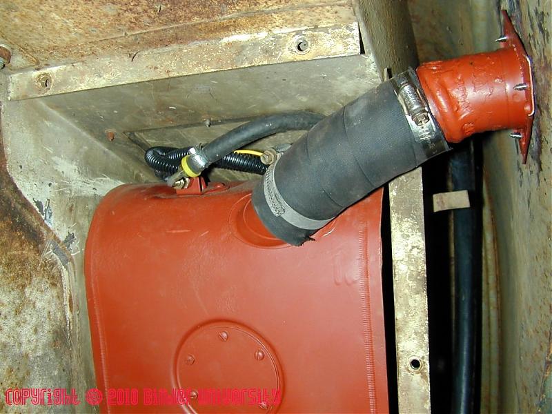

This is a cut and turn using a chev s10 boneyard filler neck with a real vent hose to the inner fender. There are hundreds of boneyard tank necks that can be modded for this.
Use only "rated" fuel hose for the soft connections, radiator hose will disappear in very short order once exposed to this shit e10 fuel.
This is the passenger side setup, the driver-side will be a mirror image.

Yeah, I like it. Did this set up completely alleviate the fuel spewing all over the place problem?
Im just thinking of something a little more custom with a perfectly aimed bend that lines right up with the steel tube coming from the tank and perhaps a 2-3" length of the high grade fuel hose.
I couldn't agree more about the grade of fuel hose. Found out the hard way on my power wagon about why we should spend a dollar more per foot for the good stuff. I only use the good stuff. Also when doing evap hose, one needs to make sure and use fuel vapor hose, because it is not the same as fuel hose and will not break down and disintegrate.
The unleaded restrictor is still in place along with the flapper. Fills just fine from either the pump up on the highway or a flex spout from a jerry can (preferred method).
