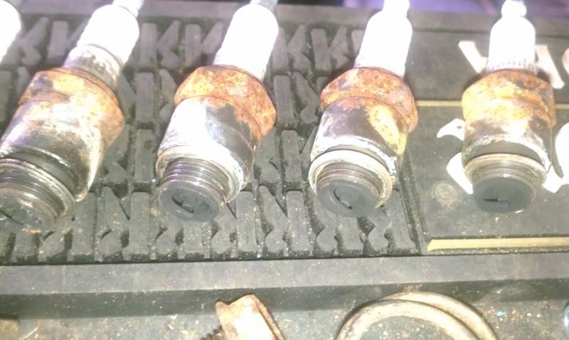

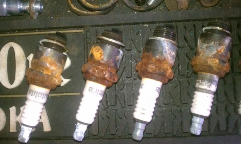

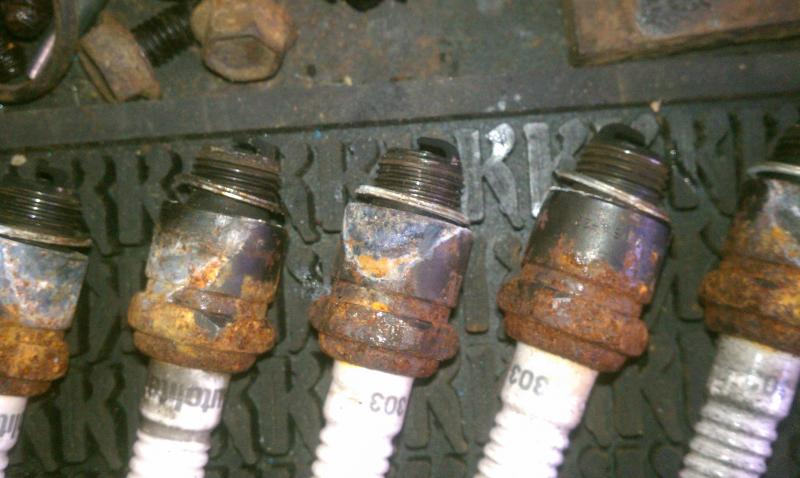

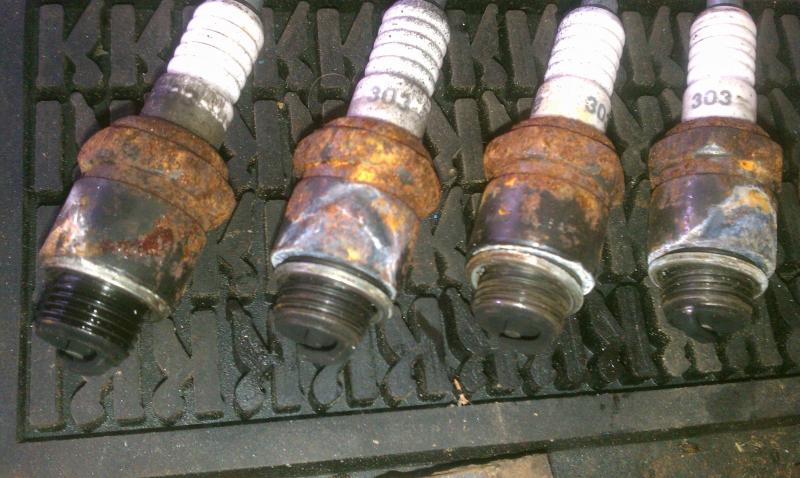

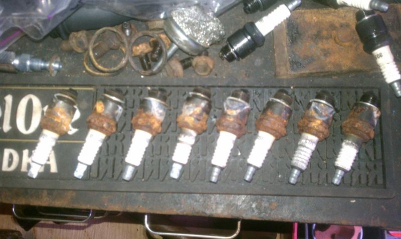

Plugs are out and I have attached a pic of them.
Ugh, by the looks of the plug body corrosion, it looks as if the engine sat out and exposed to water. You can see where water sat in the plug hole area for a while. Might be a a agood time to have a close look through the plug holes whith a flashlight. Any sign of corrosion and I'd think a head removal was in order.
Agreed on how those plugs look. It also looks as though the new(to you) motor hasn't been ran in awhile. Even after pulling the heads, the consideration of a rebuild might be in order. I would rebuild it, but that's me. Maybe, as a minimum, honing cylinders and new rings, along with new bearings(cam and main) and of coarse new set of gaskets

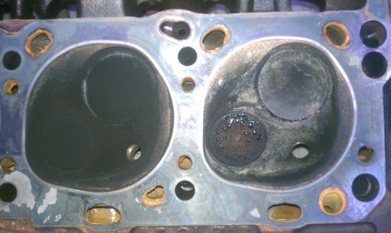

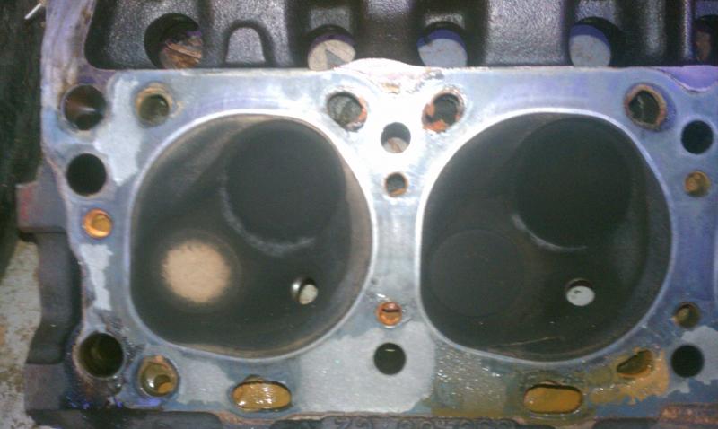

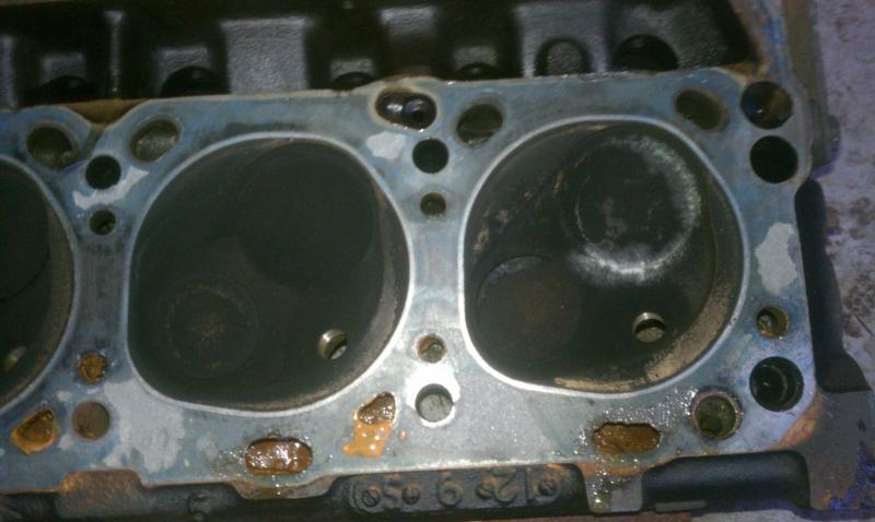

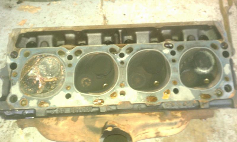

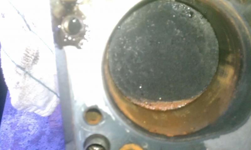

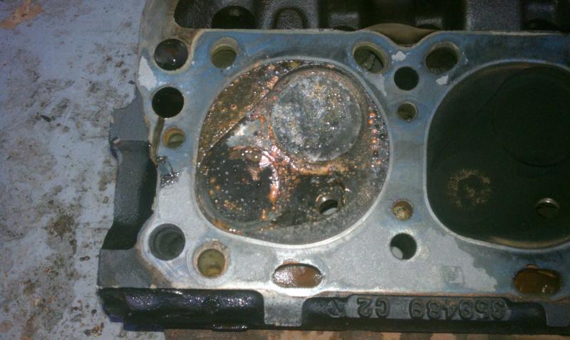

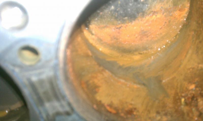

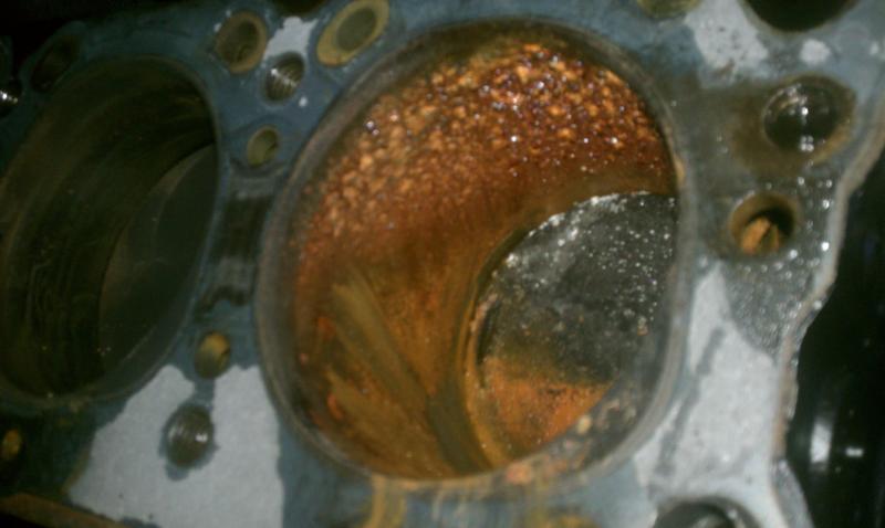

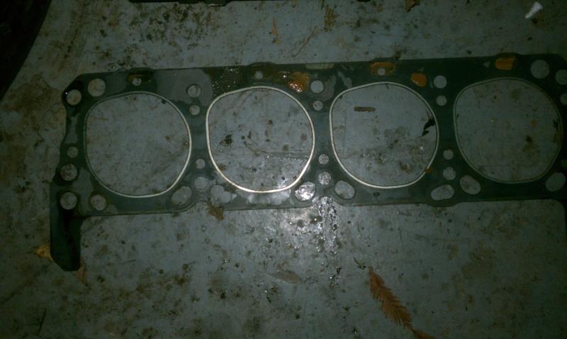

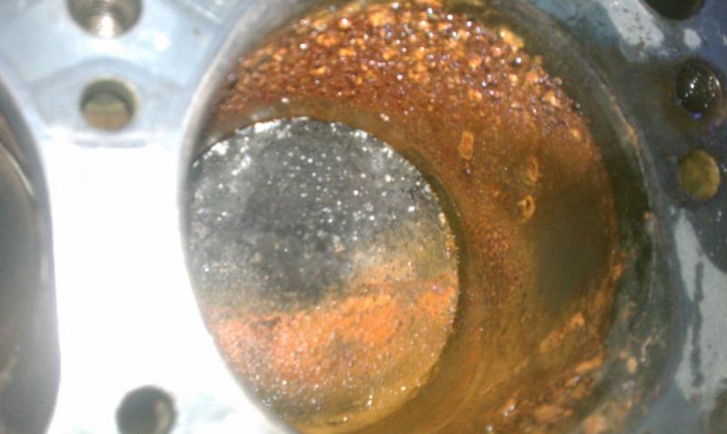

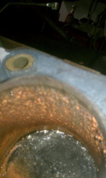

A rebuild was definitely going to happen at some point but I was hoping for a runner and not a roller for the near future. Wouldn't turn after removing torque converter bolts. Removed swapped oil pump and still didn't turn. Removed rockers and still didn't turn. So had to remove the heads. Here is what I found.
#2 cylinder
attachment.php
attachment.php
attachment.php
attachment.php
#1 cylinder
attachment.php
Passenger cylinder head pics
attachment.php
attachment.php
attachment.php
Drivers cylinder head pics
attachment.php
attachment.php
Head gasket (both looked the same)
attachment.php
So as you can see a rebuild is definitely needed. Disappointing but expected since I didn't crank it over manually when I bought it. Live and learn.
Fwiw wouldn't the po who pulled the heads have known what shape this engine was in. I'm not blaming anyone but myself for this but it sure seems like this didn't happen overnight.
Wow what a f&%k'n bumer. :nonod:
if I had sold it to ya I'd give you your money back and buy you a bottle of your favorite poison. It's simply uncalled for to sell a pos like that. That is not over night water damage. That took months, perhaps years and many wettings to accomplish. The po had to know.
That would have been visible from below when you had the pan off.
That's a painful post to read, dude. I rebuilt one that looked that bad (maybe worse). But I knew what I was getting (it was free), and there was no mis-representing it for anything more than the pile of crap it was.
Sure hope the c-sucker that sold you this bill of goods is happy with himself.
Keep your head up. We've all been there. Keep up the posts. There's good help here.

A very slim chance that the bores will clean up with a bottle brush hone and be defect free. If it was going to be a trail rig and not subject to emissions regs I'd let a small amount of pitting go and re-ring it if the bore size was reasonable. In your case however a little oil passing will kill the smog crap test.
