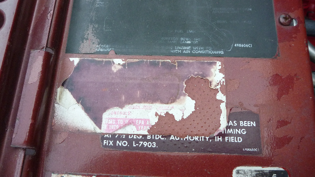

So remember all of that bitching I did about the "factory specs" for timing? Well I just discovered the remnants of this sticker on the cowl. From what I see, it looks like some kind of official factory adjustment from 0 deg btdc to 7 1/2 deg. It even gives the official document number. Perhaps senor mayben or another grizzled veteran can look this up for official verification? It would be cool ammo to use at the smog station for those of us who have to deal with such things.

Major freakin' juju happenin' here deal!
Just a month ago, I found the same thing on that rig that sparky (brotherbryce here on ihon) picked up from bill corn down in fairfield!!!! Bill had parked it several years back since he'd put an edlebrock 1406 (spreadbore 345) on it and it wouldn't smog for the visual inspection:
http://www.forums.IHPartsAmerica.com/norcal-scouts/4071-need-someone-look-Scout-me.html
I made up a proper spread bore adapter to use the square bore carb (luckily it had a 1" poly body lift so the hood cleared), rebuilt it, and now it runs perfectly after sitting five years. The rest of the ride under the hood is virgin. Then I found the emissions sticker with that overlay! Sparky (bryce) has the pics, I didn't take any of that as he was gonna post it inna reader's rides thread but hasn't got to it yet. I do have the pics of the carb conversion after it was cleaned up.
The way this worked back then...for every vehicle vin affected by the "campaign" (based upon various qualifying criteria), the selling dealer got one copy of the documentation along with the overlay and instructions to contact the vehicle owner for the "update" for each vehicle delivered by that dealership. This was long before the feds got involved in this kinda shit like we have today. The overlay was supposed to be installed in an exact position over the emissions sticker so that the original timing spec was covered.
Then the documents were placed in the owner's packet typically in the glove box, as proof the campaign had been performed, the vin was checked off on the master list held at ihc service engineering hq, and the appropriate state agency for each campaign vehicle was notified so that the state dbase could be updated. And this was before all this shit was done on pooters so ya know dam well it all fell down the rathole, especially in kalifornikate! Mosta you dam kidz weren't even born in '78>'80 or were swimmin' arount lookin' like a tadpole!
I have spent hours trying to locate a copy of the original service letter that outlined this upgrade. Someone out there has this information in their files. I know that copies exist in the archival information held by binder books. I'll be talking to cyndi (binder books) at the Binder Bee about this on July 16 and put a bug in her ear about finding this information in the files she has.
I do have a few similar items (copies, not originals) regarding '73 and '74 emissions details, stuff that was never included in the service manuals as it should have been in later years.
So...the document we're looking for will be a "service letter", or a "fleet service letter", that is coded..."slf78 (or 79, or 80) and then a sequential number from 1 thru whatever. I bet someone out there has an actual '78/'79/'80 vehicle that has the document in the glove box, but since they don't have to smog in wyoming or wherever "normal" is, then they don't pay any attention to this stuff.
I knew that this had been a campaign based upon what others had told me over the years (with no documentation)...but I've never mentioned it in the forum since I had no proof of this that you could take to the bank (or the smognazi). Ya know how we are about being accurate and correct with information around here. I've also gone through every piece of collected ihc technical information/memorabilia that Jeff has been saving since high school there at the shop, and I've found nothing regarding this specification change.
