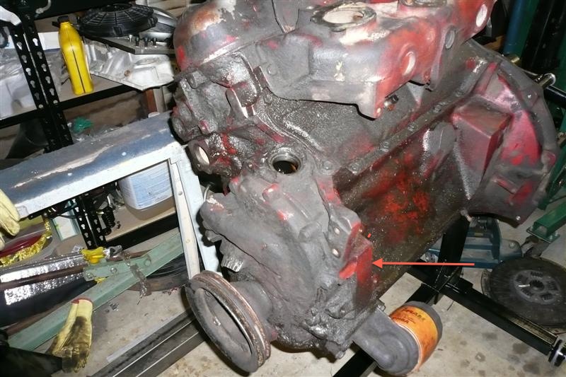

IH 4-152 & 4-196 engine id stamp is on a flat boss on the left side of the engine block, at the front end.
Clean off the gunk first.

Thanks ih200, it is a 196 e, and I knew about the dipstick bolt scoutboy, but you cant even see the bolts on the front of this engine under the 43 years of oil and grime.
After a whole day of scraping, degreaser, and some wire brushing. It's starting to look like an engine.
