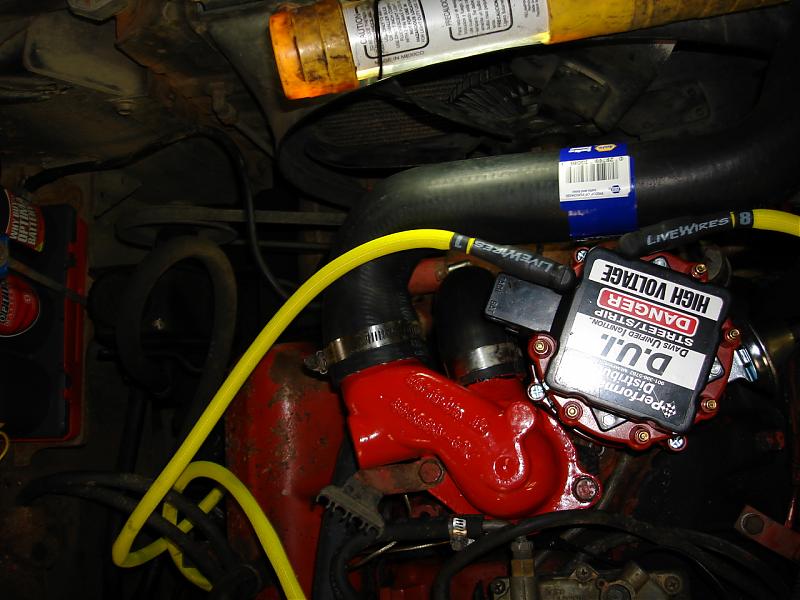

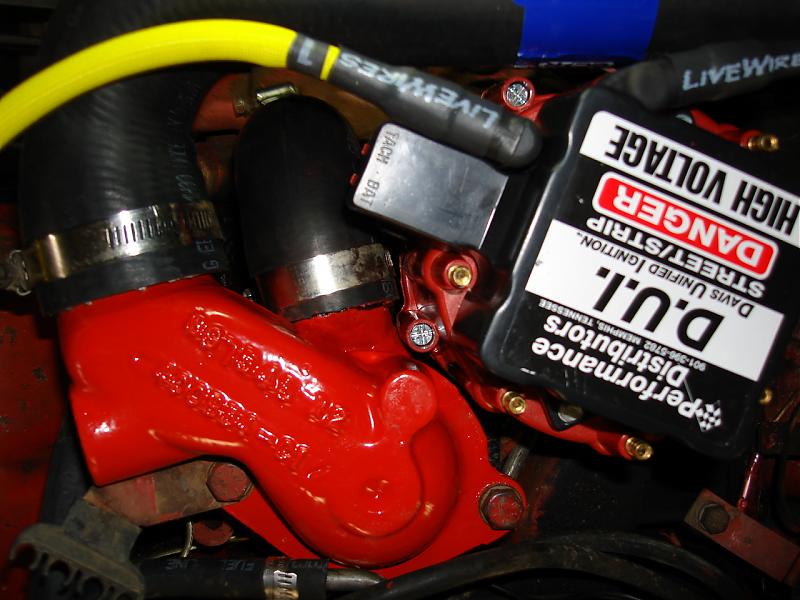

Ok, so here is some progress. I hope I will be able to post these pics in here. I put the different neck on so I was able to point the elec hookups forward and make clearance for the air box. Now I am still only getting a half inch or so of adjust ability. Now I guess I am hoping it will be close enough to time and if not, what can I do? Can I move the dis. A tooth?
If I point the power/tach hookups forward I run into the hose. I wish I was better at this work around stuff and had more mechanical experience but I think I can do alright. Of course I could maybe get a different hose so I could point it forward and get that hold down out from in that nook between the housing and bypass hose.

I didn't go back and reread what was previously posted in this thread, but the needing of an offset water neck is not true. The stock one that came on most Scout II's works just fine. Is it tight on clearance? Why yes it is. But the distributor does fit and has enough room to make minor timing adjustments, which is all you need.
The Davis Unified Ignition "DUI" HEI Distributor fits just fine with either water neck, in my experience.
Plenty of room to rotate the distributor housing for timing adjustment with either upper water outlet.
Photo attached of each.
