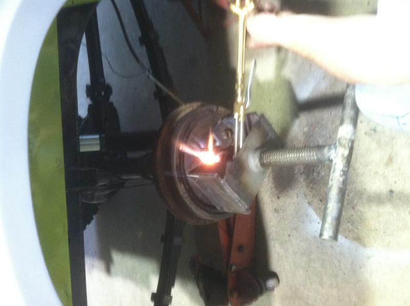

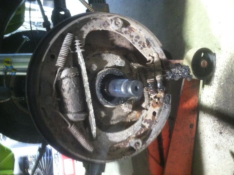

I got an email today with the photos of Robert inspecting the brakes on the passenger side rear. I thought about going back and editing the post about the brakes and putting the pictures in there, but y'all are just going to have to try and keep up.
Robert made a puller because he couldn't find the one he had back in the day to work on his willy's. From the pictures I have seen of the pullers, this is the real deal. Since these drums probably haven't been off of here since October 1964, the smoke wrench was judiciously applied.
I would say 50 years is just about right. Wheel cylinders seized, hardware rusty, pads shot, drums shot, what to do? Hello, IHPA? :yesnod:
