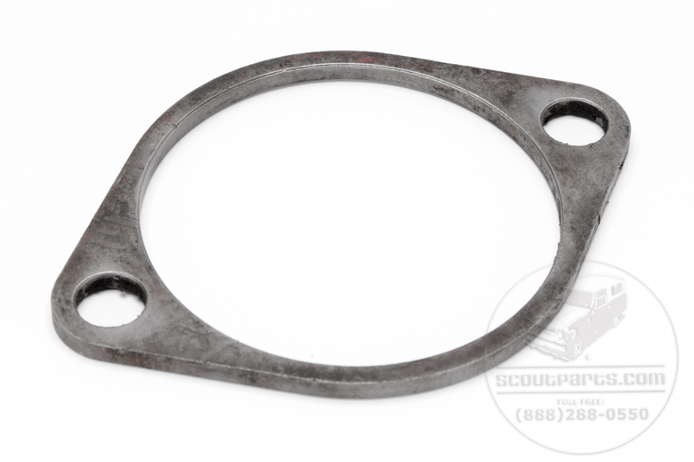

:icon_up:don't for get the spacer ! Jeff
X2
spacer in question is mounted between the starter and the hole in the block where it mounts. Some p.o. May have gotten stupefied and didn't put it in when they last replaced the starter.

Ok, thanks for the heads up. Do you guys know where I can purchase just the spacer?

ok, thanks for the heads up. Do you guys know where I can purchase just the spacer?

So are you saying that you don't have a starter spacer in place right now? I'd be shocked that the engine could even be starter cranked without the spacer in place. The gears don't mesh up right and even if it did manage to fire up, the flexplate gear teeth would be rubbing on the starter gear with each engine revolution. You can imagine the damage that would do to your ring gear teeth.
Trever, I was thinking the same thing about the vehicle even being able to start without it. I imagine it's still there. When I say cold, I'm talking anywhere from 0-15 degrees. The battery terminals are starting to corrode at the battery, and the battery is from sept 2008
It'll still start w/out spacer, but will be noisey, an yes it can do damage to starter drive & or flex-plate ring gear. Jeff

Here is a pic & p/n 424 443 c1 for the spacer.

I wasn't able to get all the way under the Scout because there's a bunch of snow on the ground and it's in my driveway, but I was able to see that there is a spacer in between the starter and the trans. So I'll just be sure to switch that over to the new one.
