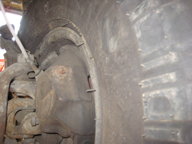

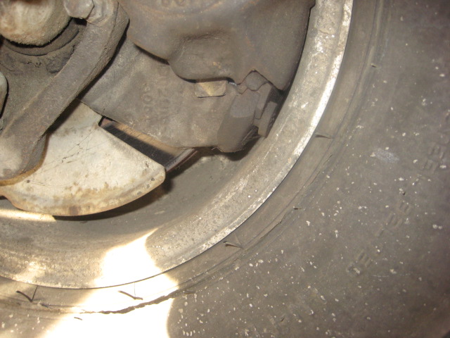

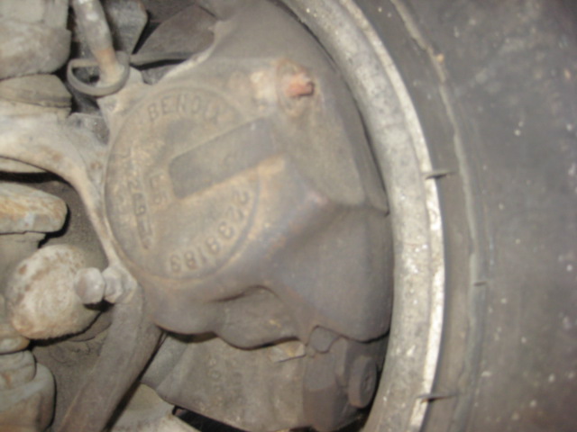

So I gots some pics of passenger side

so I gots some pics of passenger side
Sorry for the temporary distraction!
From your pics, we can see you are dealing with the bendix-supply caliper.
