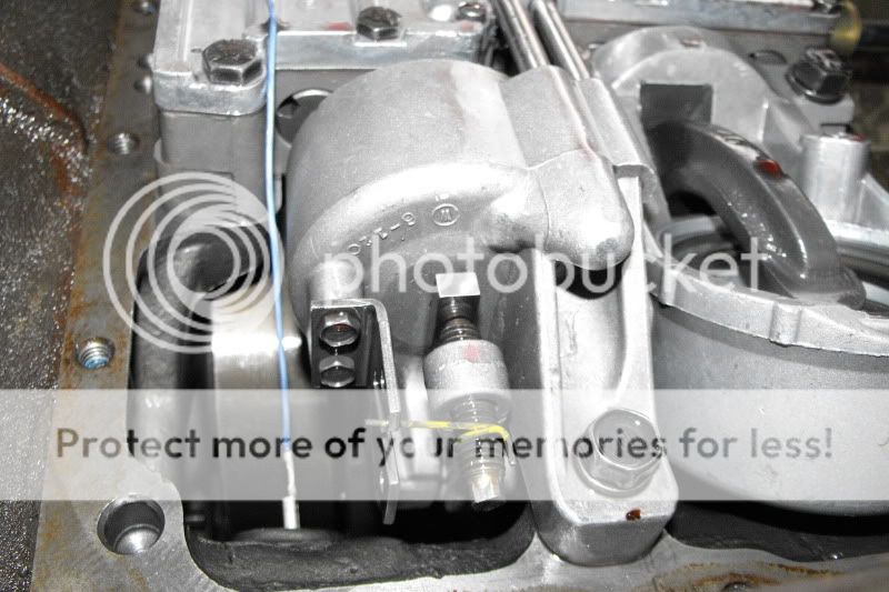

But I have a print of that studebaker stuff in my bw 11 tech binder here, but did not have it with me to respond to your question with a "fact". But your research led to the same info I found years ago when I planned to build the tranny I have for re-sale. That "special tool" is a 0.250" gauge block...and a .250" drill bit shank will work just fine (or maybe a chunk of shank cut to fit??)! This is not a precision setting since the band and drum wear on a continuous basis.
