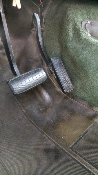

Pic of pedals. Brake sits about 3/4 inch lower when at rest. Typical is opposite (safety feature so can always reach brakes when seat is adjusted for accel pedal. Called lift over) engine off, the pedal is immediately firm. Once running, pedal travels 1+ inch before brakes start to do anything. Also, mostly unrelated is the dash light for the brake is on always. Due to brake controller??? Or short?? Might be my electrical issue root cause. Still debugging that problem.

I would not be concerned with the brake pedal height until the brake system has been completely repaired, bled and is working properly. Then the brake pedal should be at normal height above the floor due to those corrective actions.
If not, then That pedal height issue can be addressed.

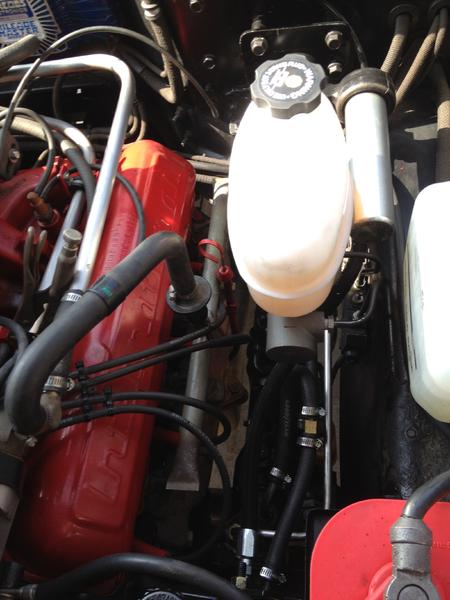

This is a hydroboost system. It will put you through the windshield. Jeff has a kit on the site, or you could piece it together.
It sound like your truck has languished a while and the m/c has lost its seal. They are cheap enough, and Jeff has them new, as well as hoses. No sense cutting corners on brakes. The stock disc/drum system is totally fine if your booster, m/c and other bits are up to snuff.
Hydroboost is the way to go. It makes a total difference, when you mash the brakes the Scout will stop! And if you stall the brakes will still work pretty well too.

All a hydro-boost does is give help pressing the pedal. If the engine stalls it needs to be spinning for the hydro-boost to work, if spinning it will also make vacuum too. However vacuum assist will hold enough vacuum for an application of the brakes or 2. Does hydro do that if a belt breaks?
anybody put hydro boost brakes on a 60s travel all?
We recently did on a 1968 1100 4x4 pickup. We also installed at the same time 4 wheel disc brakes. Couldn't tell you how well it stops as we have yet to drive it on public roads as we are waiting for proof of insurance on the truck.
Yes.
The hydro-boost has an accumulator that will give you some reserve braking after engine shut down, similar to the vacuum booster.
The accumulator is the round cylinder adjacent to the reservoir. It automatically charges/recharges with pressurized fluid as long as there is hydraulic pressure being provided from the ps pump.
