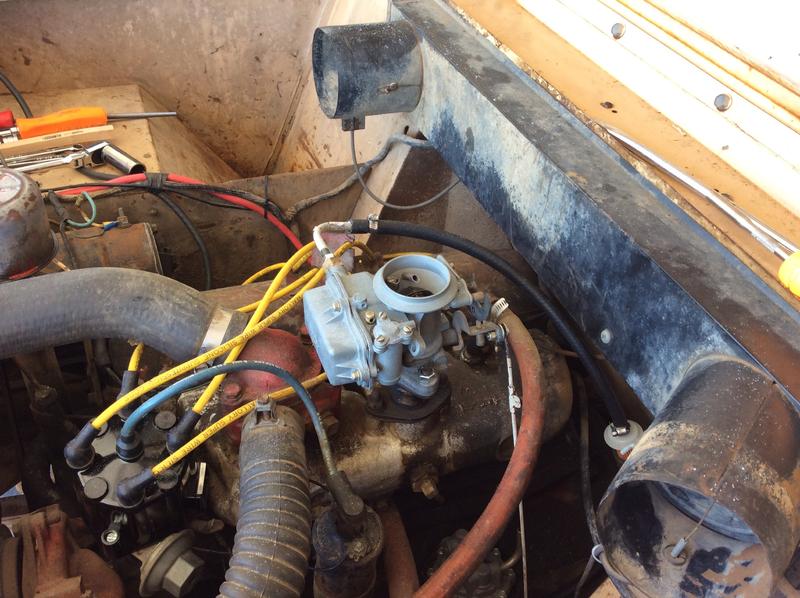

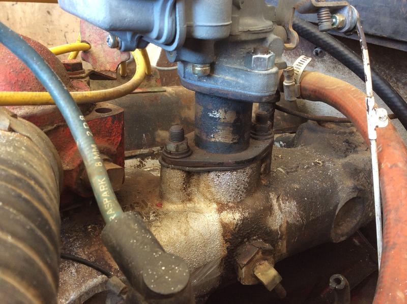

My best guess based solely on that photo is that the original Holley 1904 carb is long gone and has been replaced with a Holley 1920 carb which has a wider bolt pattern thus requiring an adaptor such as you see on your 152 IH 4 banger cornbinder powerplant.
