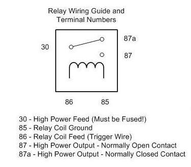

When following the the sticky on the solenoid upgrade (http://www.forums.IHPartsAmerica.co...pgrade-remote-starter-relay-installation.html) the starter solenoid found on the starter is 'jump switched' by a small jumper cable from the battery to the 's' terminal on the solenoid; does this mean the original solenoid is bypassed or does it still work when cranking the engine? I.e. What is the use of an extra solenoid in this case..? Sorry to ask but I am not that electrical educated...
