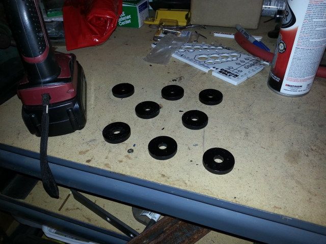

Its been awhile since I've done anything to the Scout cause its been so fricking hot here these last 2 months of summer. The weather has mellowed a bit now so I started in on it again this past week. Remember the drop plates I had made? Well I started fitting those this week getting ready to do my "on the cheap" lift while retaining the correct axle alignment specs. I have procured 3/8" x 5" shackles to take care of the other ends to match the 2" spring mount drop. Thats all for now and nothing has really changed yet, I'm planning to do the lift in 1 day so as not to down it for long since its my dd...more to follow.

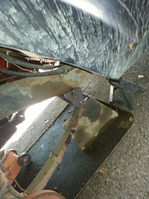

Started on the lift today at the front...yes that's ruthie my wife. I'm fortunate enough to have a wife that likes IH's as much as me and likes to work on them too.
Frame plates are installed first, bolted, and heavily tacked. I will finish weld them when I'm done with the whole lift and then painted. The shackles went on next and new kyb's. I've ordered the correct length kyb shocks for front and rear and will change them when they come in. The stock shocks will work for a mall crawler but will get destroyed four wheelin. It was 3pm when we got it back together and fixed the upper shock mounts. There has been some interesting things done to it in the past.

The hard work is done on the "poormans" lift now and I'm pleased with the results....
Before
And after
The frame plates need to be trimmed and finished welded but are welded to the factory brackets on the inside. If I were to do this again I would move the new mounting location 3/8" forward, or rearward depending on the location, to push the spring out a little more for more shackle angle, especially for the rear. I expect the rear shackle angle to be better when done cause there isnt any load on the rear right now and there will be gear in the bed when used. I replaced the rear springs with ones that I had that were just in better condition and had a little more arch to them....thus the slight "stink-bug" stance.

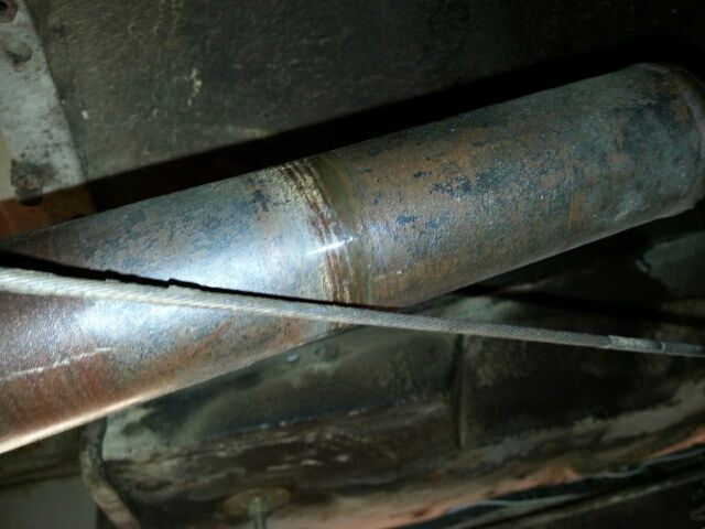

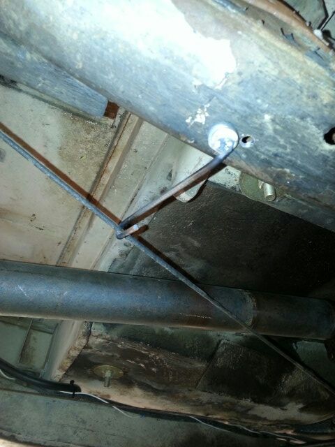

Beater had a new noise since the lift...a sorta song. Turns out the e-brake cable is rubbing on driveshaft and causing the "song". So I flipped the pull rod to the bottom of the swing bracket and made a tether out of steel rod to keep the cable away from the driveshaft. It does what its designed to and the brake works fine.

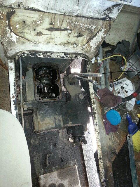

I got home early yesterday and started prepping the 64 to pull the trans/tcase to go in beater. Pulled the top cover on the t90 and the inside looks to be in pretty good condition, full of oil and no chipped teeth are evident.

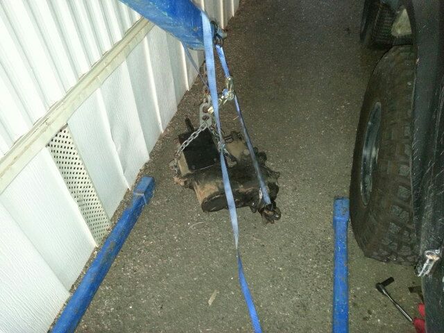

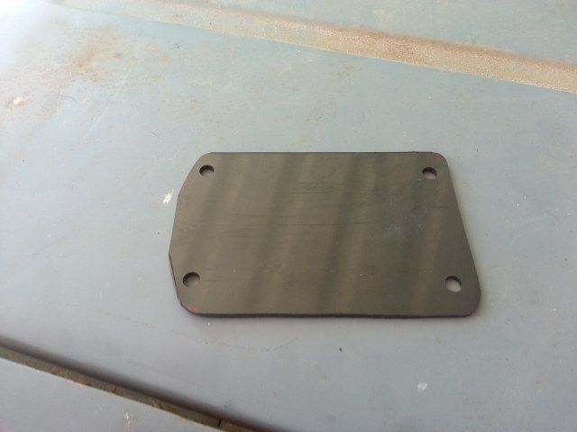

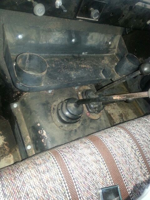

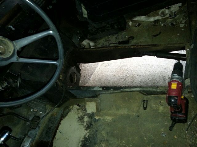

Since I don't have a hoist at home it has to come out the bottom and I have to lift the Scout high enough to drag them out from under it, so the shift levers have to come off. I wanted to keep anything from getting inside the trans so I made an abs plate to bolt in place of the shift tower to keep it sealed up during the job. Other than draining fluids and pulling the front driveshaft out, it's ready to pull.
Found a rental yard that has a small hoist for $25.00 a day that comes apart into 6 pieces for easy transport, so I got busy today and prepped and pulled the trans/tcase out of beater and wilma. Beaters stuff is on a roll cart now and will be torn down for rebuilding later. The swap units are on the hoist ready for install in the morning, I ran out of light and energy. I did swap the t/o bearing from the 64, beaters was chattering and it was just plumb wore out. The clutch isn't to bad looks to have about another year left on it...I will have to start saving for a new one.

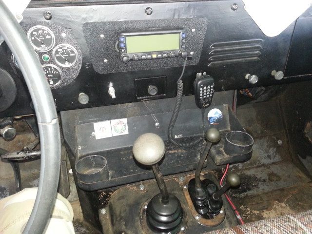

Getting it ready for I.h.w.r. In April, got my ftm-350 ham radio mounted and working with a cheapo mag-mount antenna for now. I will have to save some pennies and get a good antenna soon. I also fixed my cup holders today they work great on a soda size can but the cup was so tall the larger travel cups didn't reach the bottom so I cut them down an inch or so. I need to move some cables and switches around so they don't interfere with the giant travel cup that I use.
