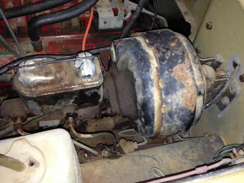

Brakes....

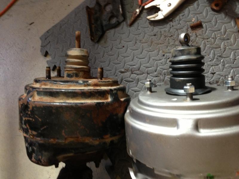

I checked the vacuum at the hose coming from the manifold and I'm getting decent pull. There is one last check I've read in a thread on here (by vancopbs--thanks), but I'm breaking down and getting a new master cylinder and booster. I mean it's the brakes....newer is better:icon_xd: parts are set to arrive tomorrow. Pics to come.

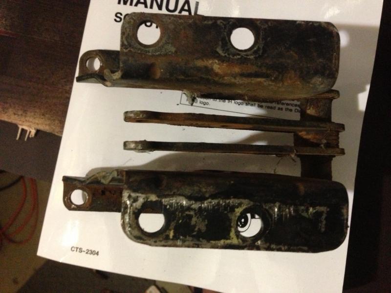

Uhoh! I've got a question. After I made the adjustment on the booster, I started to re-assemble the linkage/lever assembly to the new booster (pic below). Is this lever supposed to pivot freely on the pin? Mine does not budge at all.
