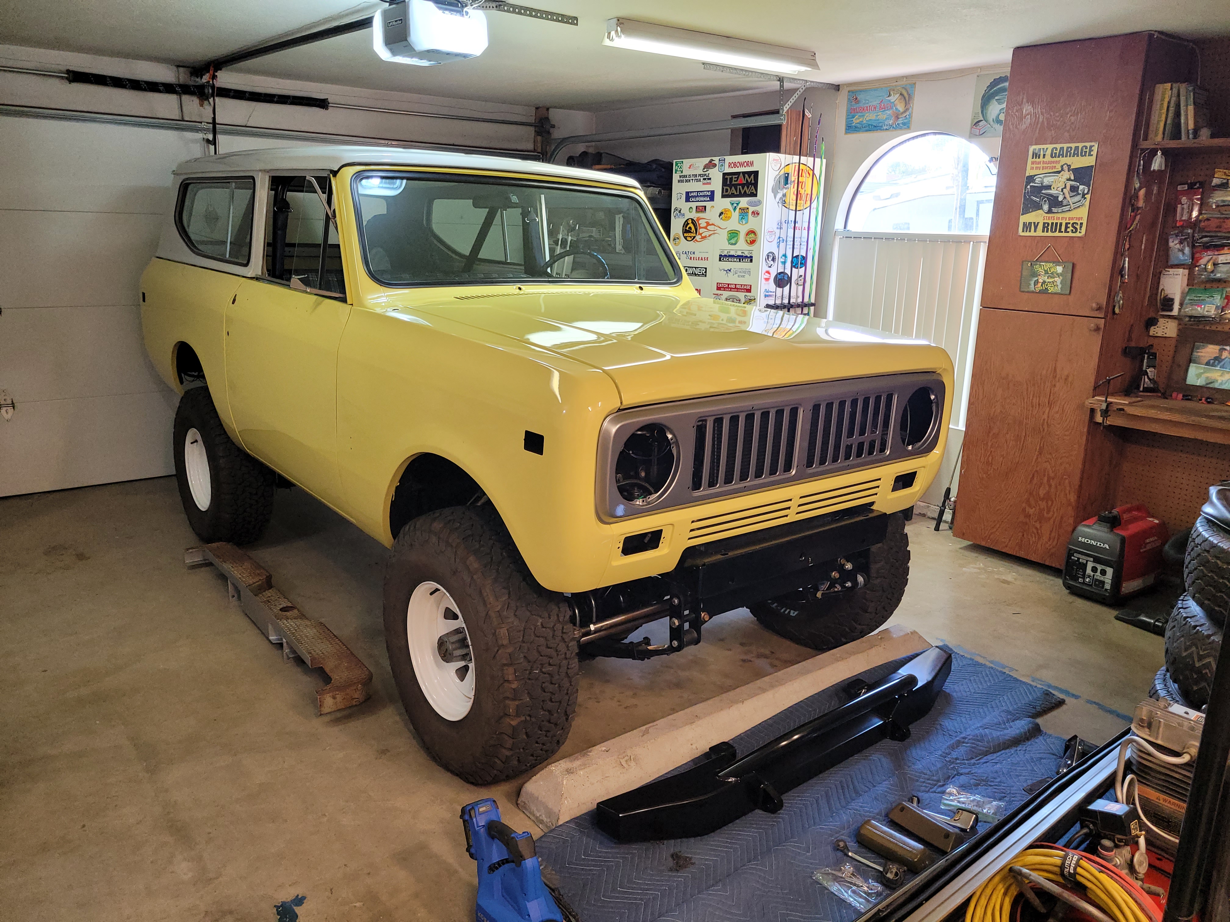

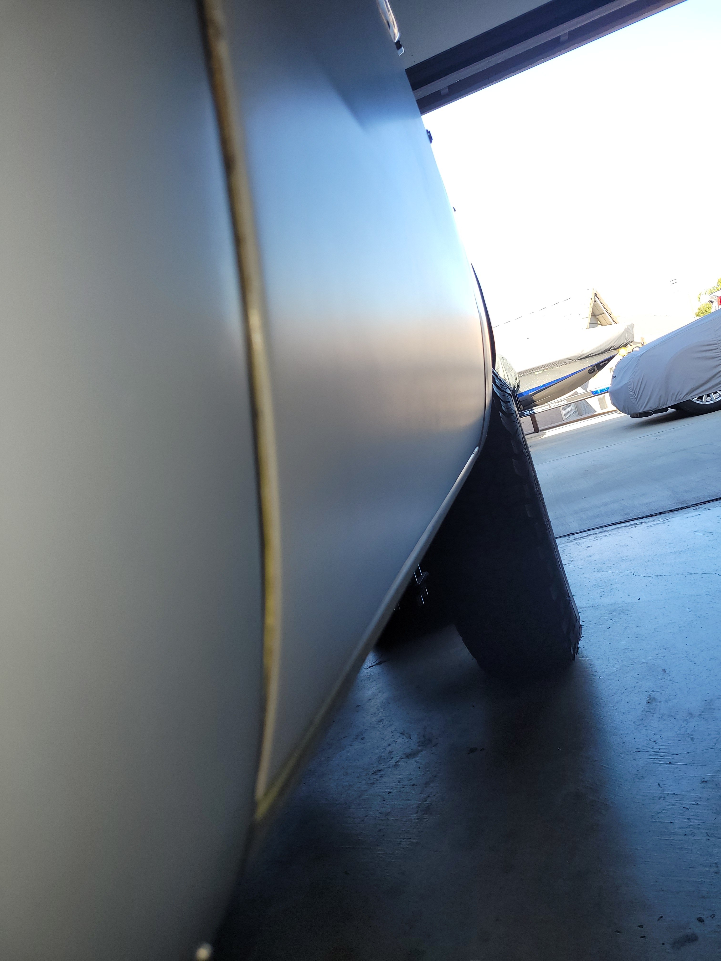

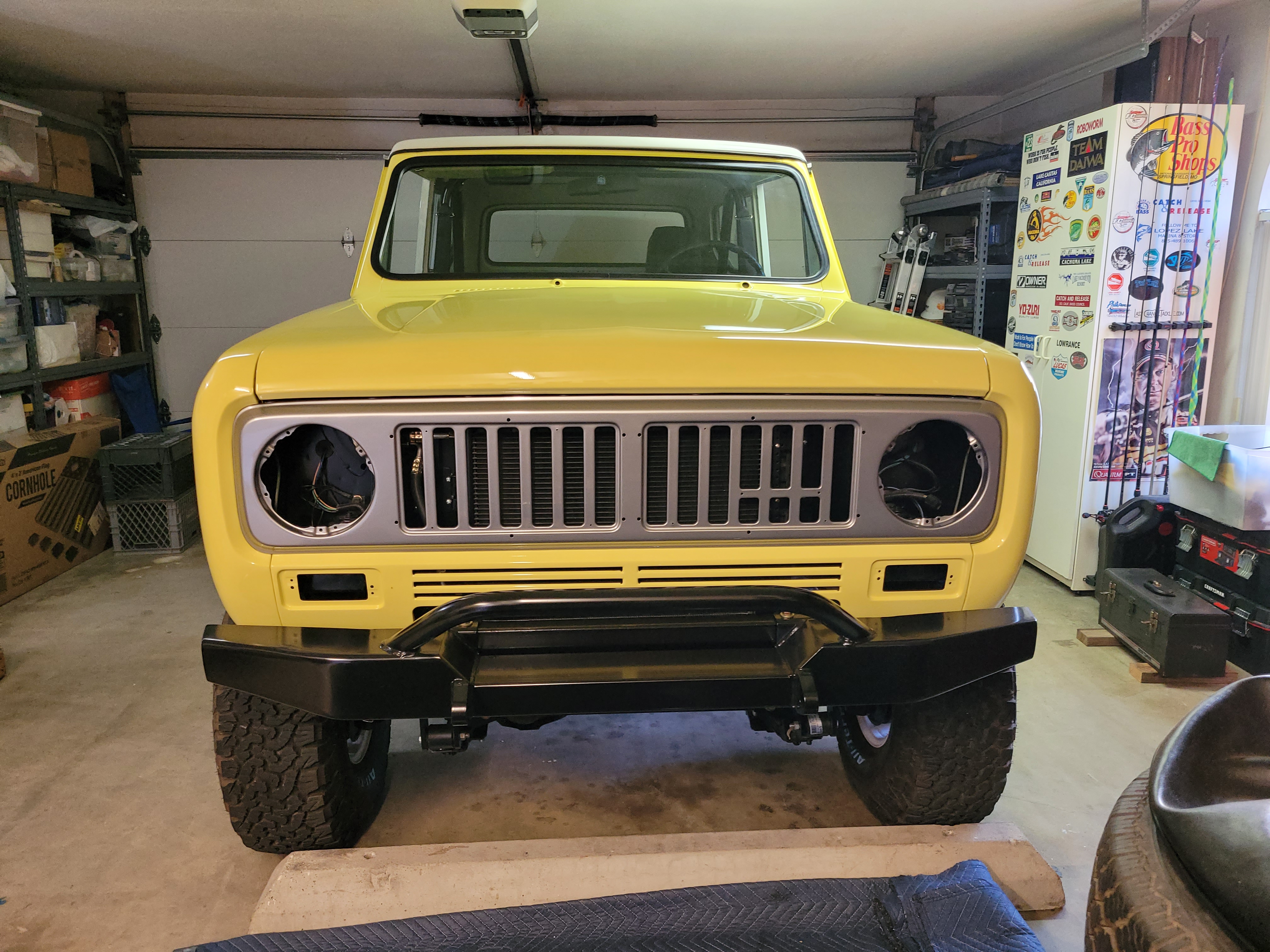

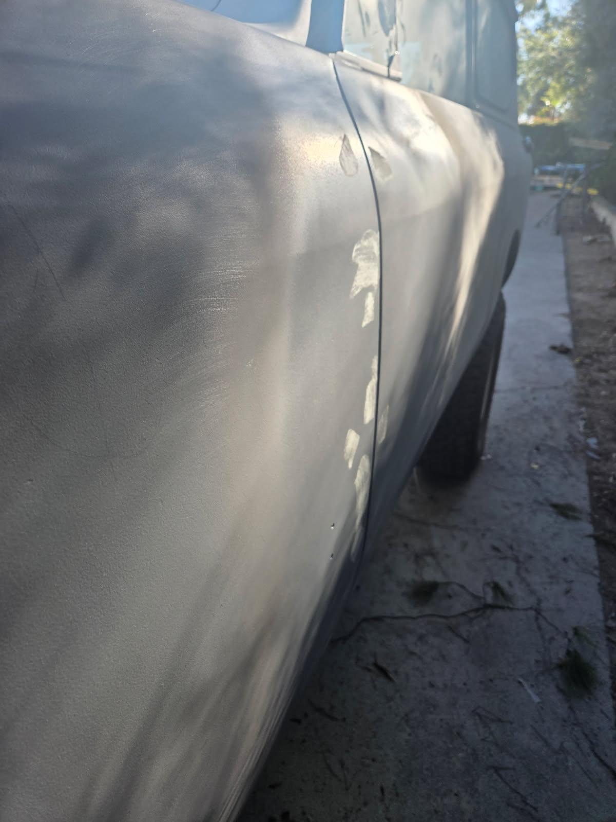

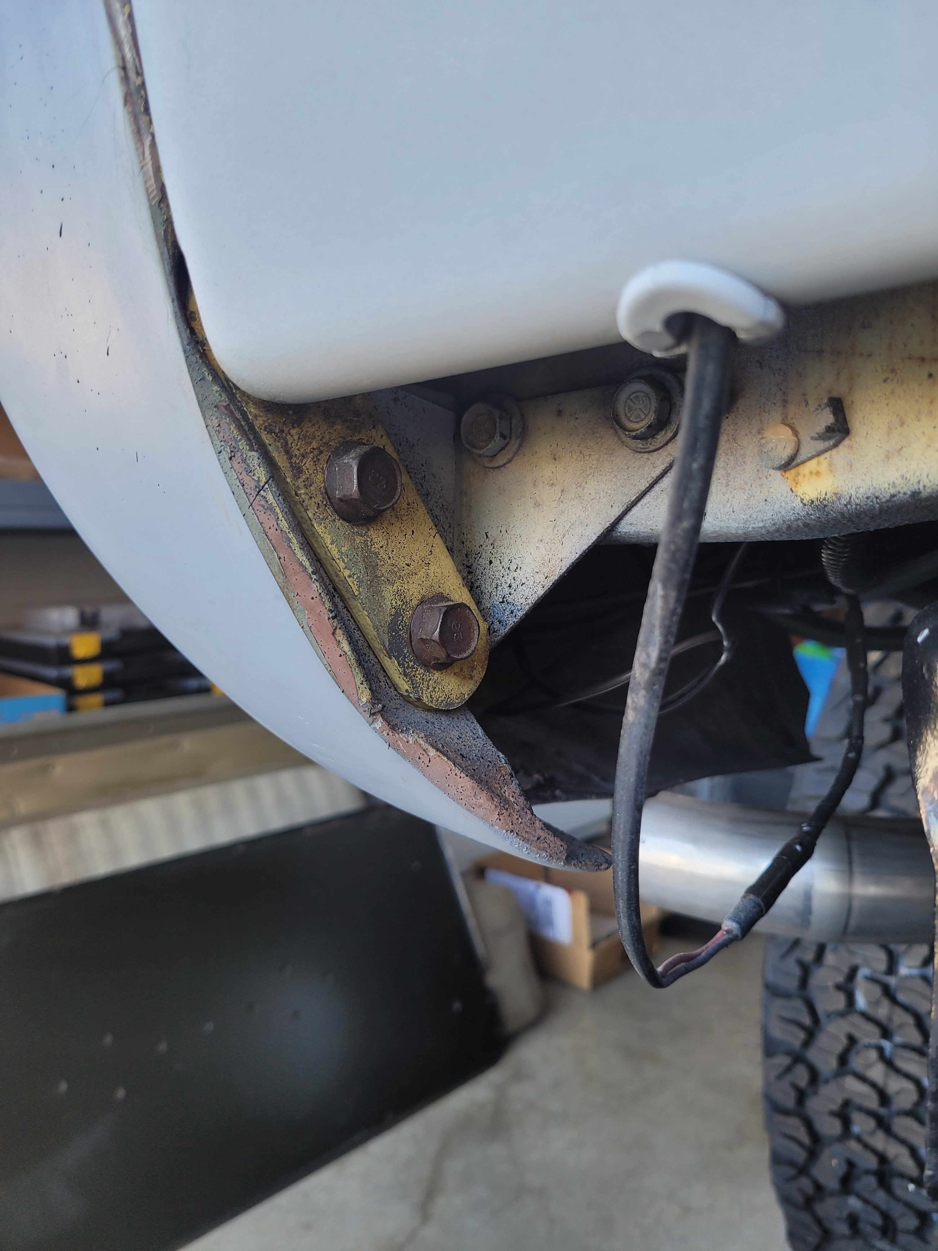

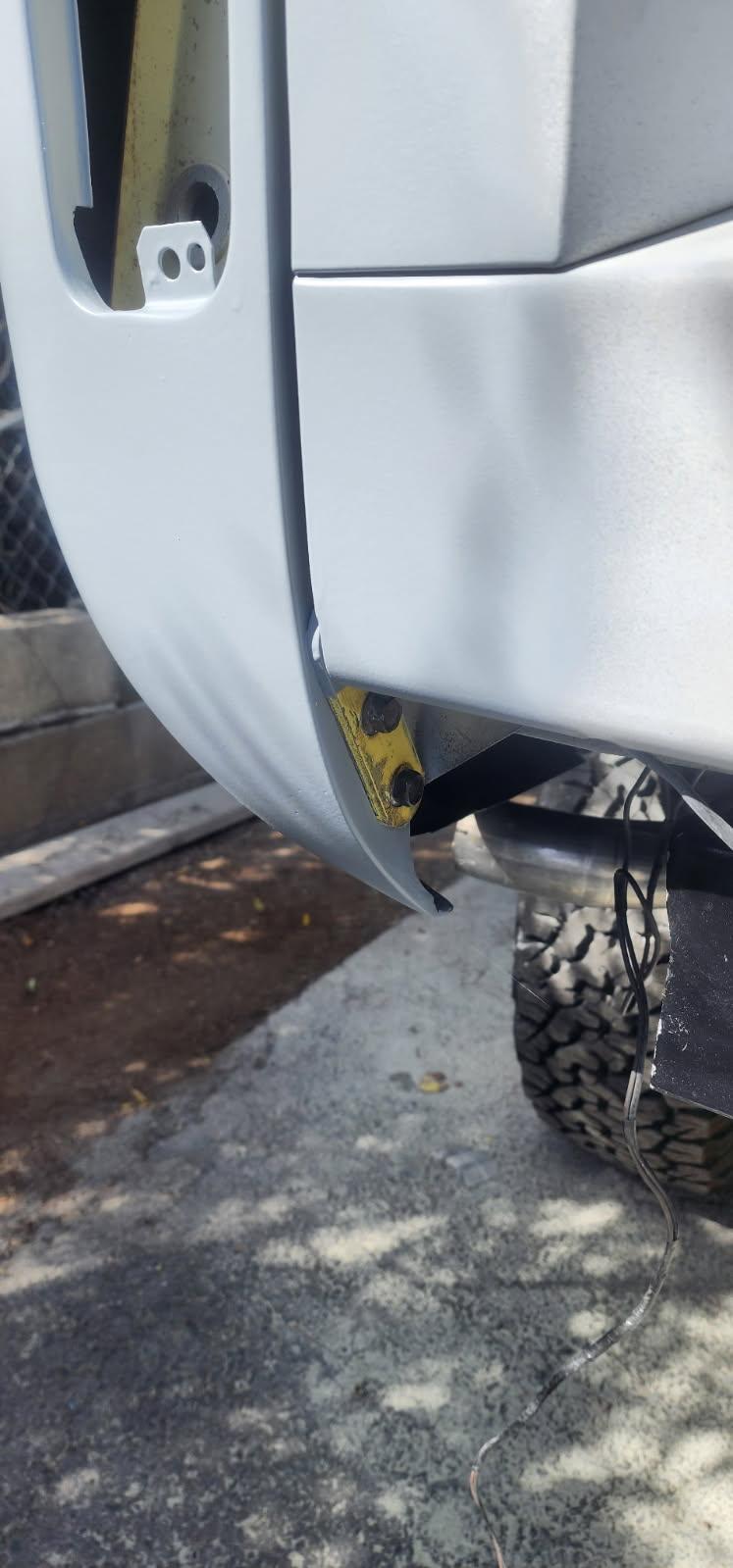

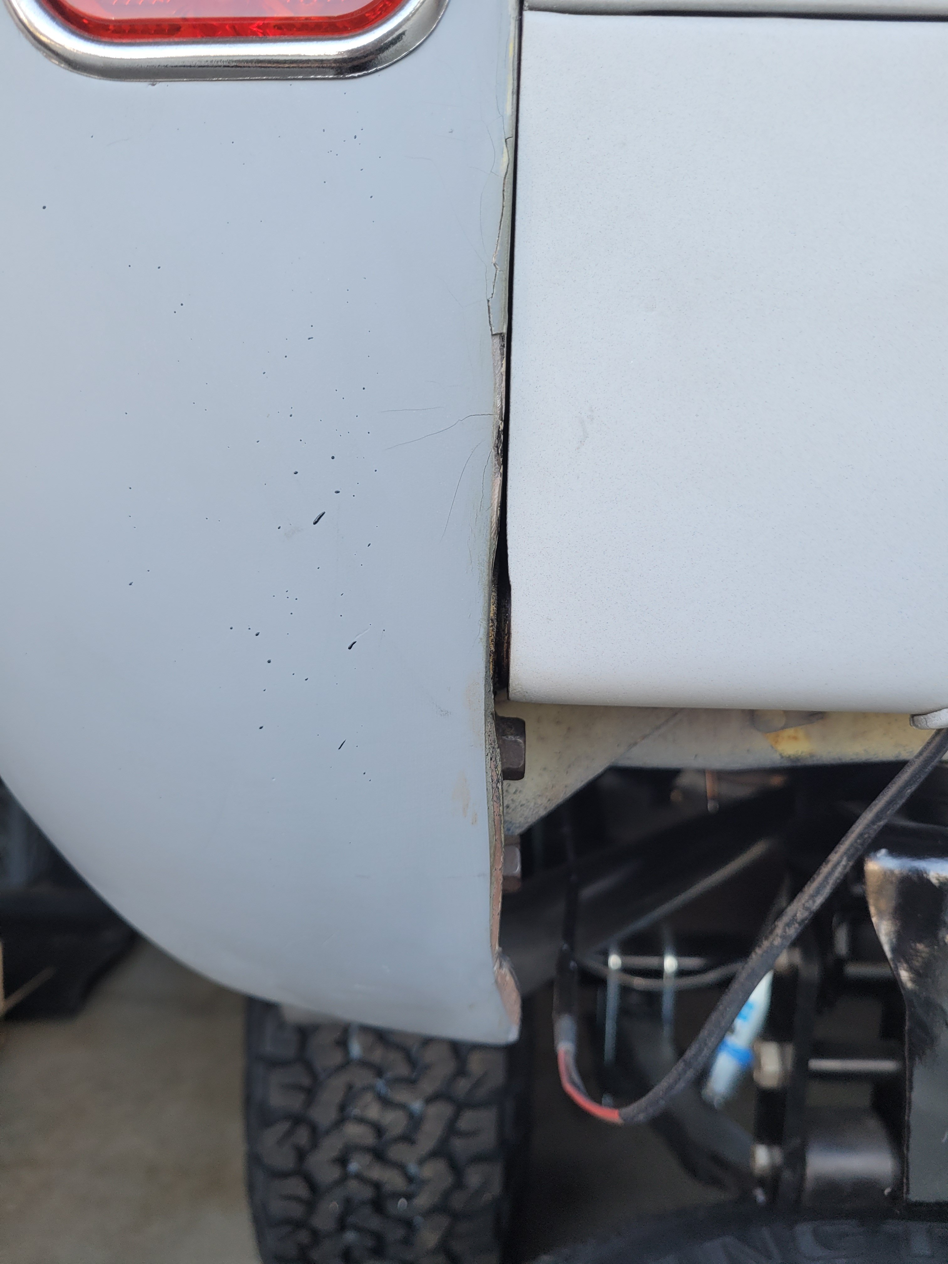

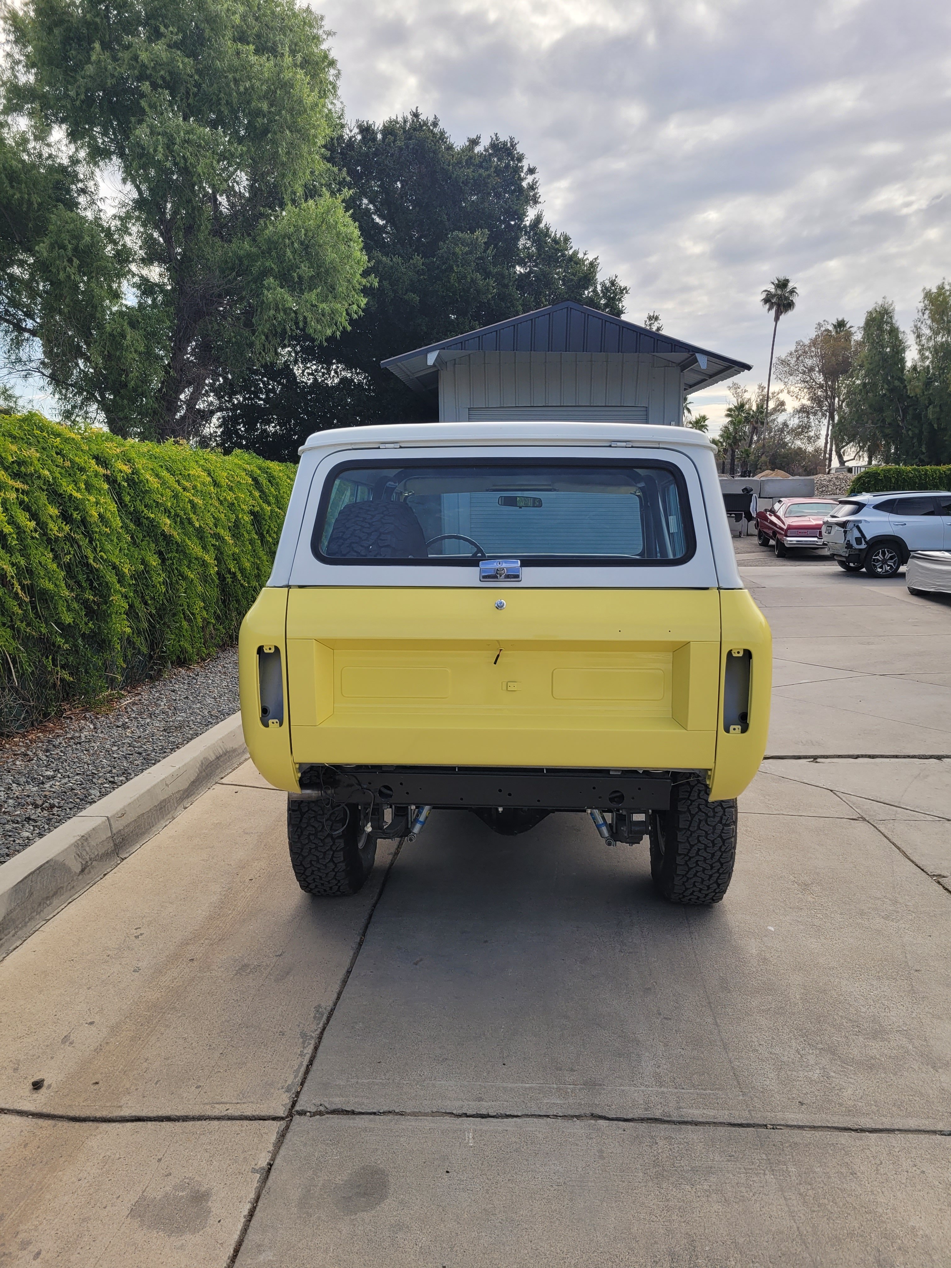

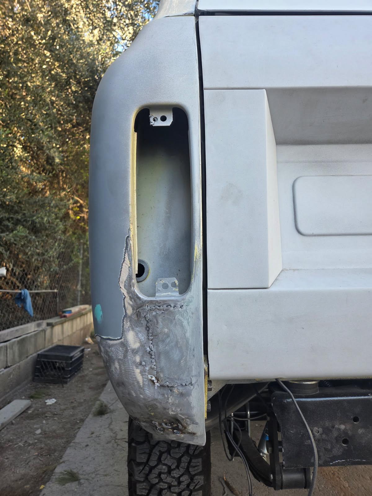

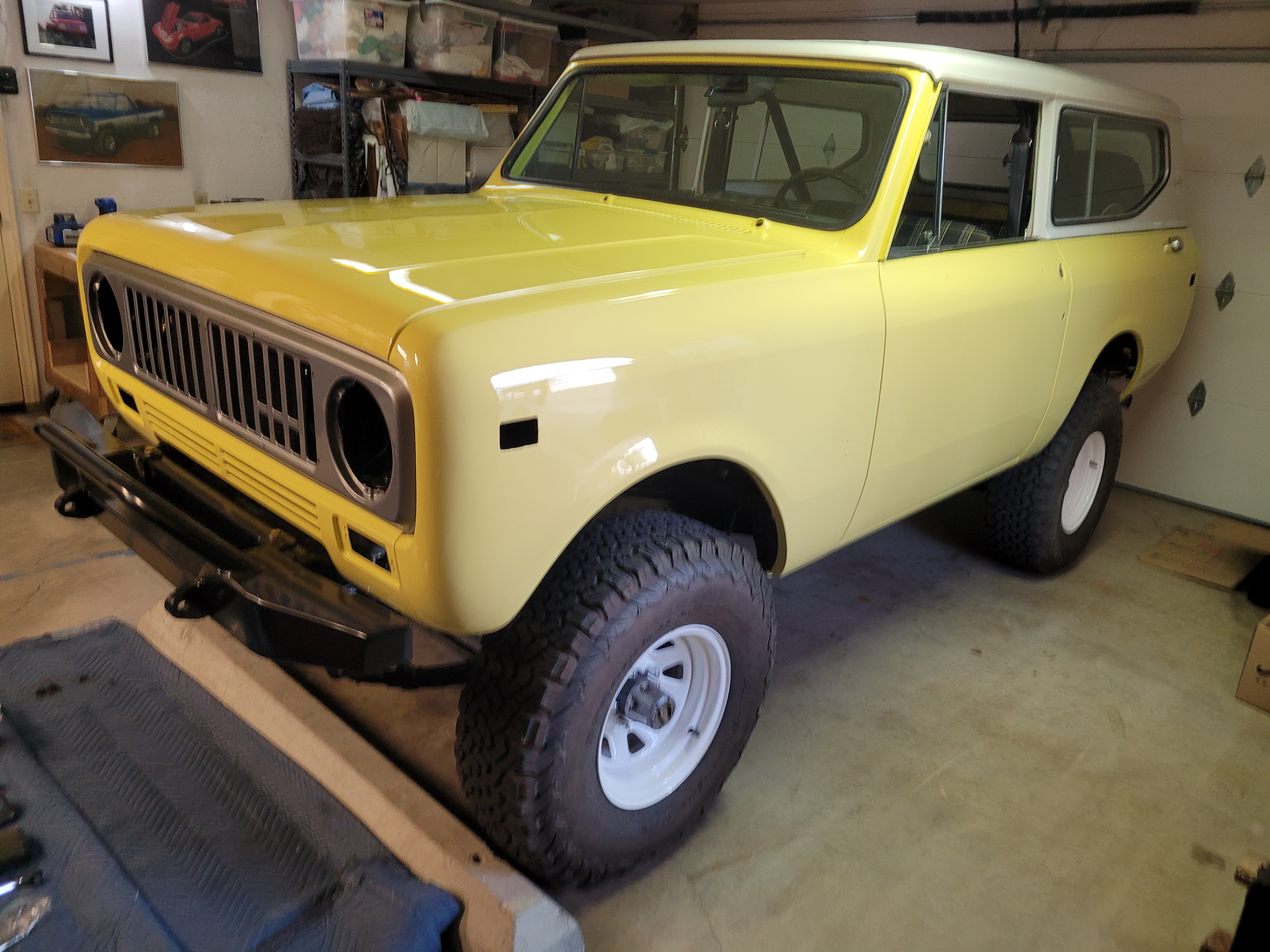

Here's an update on the Scout II project. I took it to a body shop near me in Menifee, Exclusive Autobody and Customs. They repaired the right rear corner that was hit by one of the PO. Who ever fixed it pryor did a poor job and just filled it with bondo. They did not even bother to pop out the dent or adjust the tailgate gaps. Exclusive Autobody and customs had to cut out the bad sheetmetal and replace in the lower corner, pull out the dent at the lower tailgate mounting plate and realign the tailgate gaps. My prior body guy at the equipment rental yard I used to work for did not get the chance to finish and block sanding the drivers side sheet metal before the business was sold. Exclusive Auto Body and Customs finalized all the block sanding, aligned all gaps and put a three stage paint job on it. Firts coat was a base coat of white, second was the OEM color; Sunburst Yellow and the final thick coat of clear was applied. I'm in the process of putting everything back together. This project is close to being completed. Another update to follow soon...
