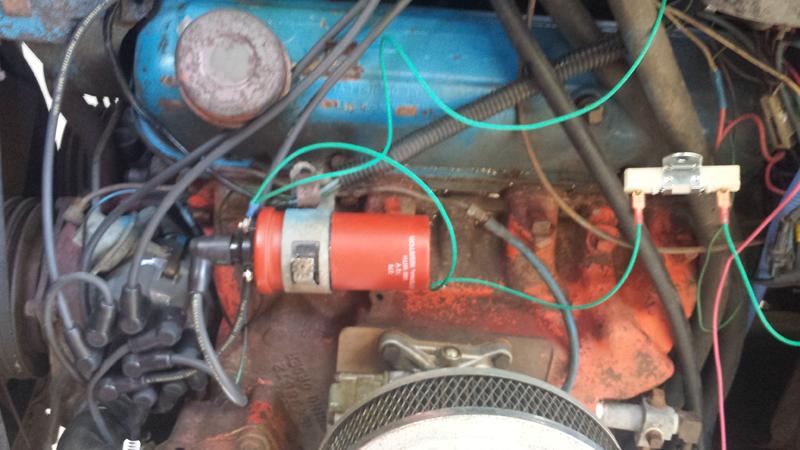

Reading one of the other threads I noticed something about a resistor wire going to the coil and its length being critical. There was one peculiar wire running from the starter solenoid to the coil that looked to be extra long and the original old style insulation.... I naturally cut it and replaced it with a shorter piece... There was also a capacitor/resistor mounted to the original coil which wasn't hooked up... Could this be playing a factor? Thanks
Originally, the resistor wire run is from the firewall bulkhead connector to the coil pos terminal. It is a cloth-wrapped wire with the excess length folded back against itself several times and secured with electrical tape. This feed is hot when the ignition is switched on. Its what allows the engine to continue running after it starts up and what stalls it when the key is switched off. Without seeing the wire you've described, one can only speculate. "original, old style insulation" is in the eye of the beholder. With a breaker points distributor, there should be a wire running from the solenoid 'r' terminal up to the coil pos terminal. This is the resistor bypass feed, but it is only hot while the switch is held in start position during starter cranking. So this wire shouldn't have any wild cloth insulation covering it as you would expect to see on the resistor wire as previously described. If it was the original bypass wire, it would be standard automotive wire with the same insulation consistency of nearly every other factory wire in the truck. The length would be sufficient to make the run up the backside of the engine and then down the length of the valve cover to the coil without being sloppy. The capacitor mounted to the coil bracket is for suppressing rf noise interference in your factory sound system generated by the ignition while the engine is running, aka "am radio buzz". Its a non-essential item.
The unknowns of this situation include: positive distributor identification...point gap/dwell angle setting...condition of points and condenser (aside from cursory visual)...correct circuitry runs to coil pos terminal consisting of a proper resistance feed from the ignition (either the unmolested stock wire or a replacement wire interrupted by a ballast resistor) and a resistor bypass feed from the solenoid 'r' terminal...correct coil for the application and ability of the coil to generate a spark...whether or not the distributor has been removed from the engine or its orientation otherwise altered since the engine last ran. This calls into question whether the timing is close enough to allow each cylinder to fire on time...correct routing of spark plug wires in accordance with cylinder firing sequence...what diagnostic/tuning aids you have at your disposal (ie multi-meter, timing light etc). Pictures are helpful and welcome.

This May help to speed the process up. The cloth insulated wire went into the fire wall and is the one I cut and replaced. Reading some of your other responses I now know I need to do some adjusting with the ballast resistor on this. I haven't been able to trace it but I assume it goes to the "run" side of my ignition...
The original cloth insulated wire was attached to the pos (+) side of the coil along with a wire going from the r side of the solenoid. From the neg (-) side of the coil is a wire going inside the distributor to the points. In my brain this sounds correct... I am just looking for confirmation from a reliable source.

That wire you describe sounds like the resistance wire. You will need to either add a ballast resistor to the system or now is a good time to ditch the points and install a pertronics ignitor electronic ignition.

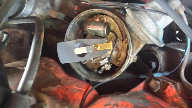

I went ahead and changed the points and rotor on the inside of the distributor. While I was in there I pulled the condenser and cleaned the ground wire since it was a little corroded. I then replaced all the plug wires and checked to make sure they went to the correct cylinder.

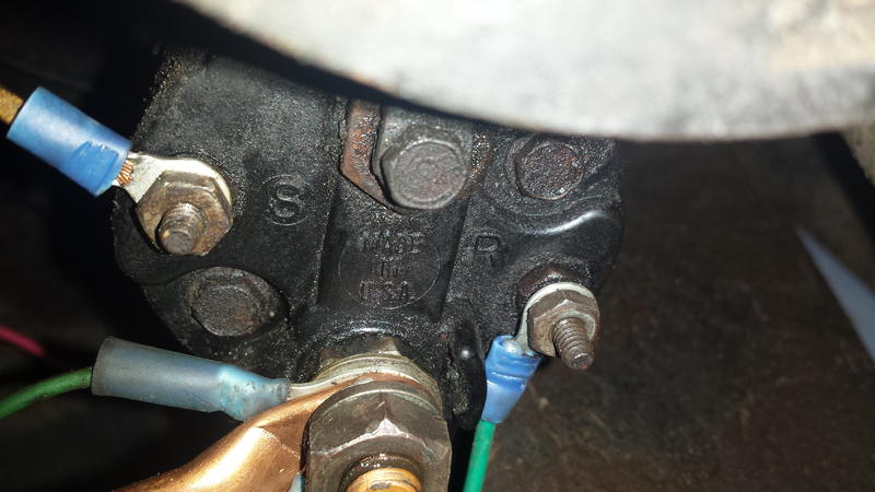

For fun I disconnected the "resistor leg" going to the coil and checked the voltage at the coil coming from the "r" terminal on the starter solenoid.. Only got 9 volts and some change while cranking. As I understand it shouldn't this be a solid 12 volts? The "hot" pole on the starter solenoid is reading 12 v from the battery.
Through all of this I have yet to be able to jump a spark from the coil lead. As I said I checked all grounds and connections under the hood... I'm starting to wonder if the problem is originating in the starter. As I crank, it rapidly gets weaker and the low voltage seems suspicious. Thoughts?

Your ballast and coil primary resistance figures are good. What did you set your point gap to?
While a starter issue can't yet be ruled out, a weak or discharged battery is more likely. A fully charged and solid battery will display a surface charge of 12.x volts and will be capable of multiple, brief, diagnostic starter bursts before any noticeable drop in cranking speed occurs. That same battery surface charge should be seen at the big solenoid post also. If you are able, take a voltage reading at the battery just prior to, during and after a starter crank. Report the three readings in that sequence.

I tried the jumper method directly to the coil and still no juice. All tests yesterday were done using a new coil to dist lead, & this is a brand new battery with 8-10 attempts at cranking... I'm thinking I May be off Mark on the point gap... What do you recommend on it and is there any special steps when gapping (#8 on tdc? Ect.?). I haven't done a lot when it comes to timing so I'm pretty ignorant when it comes to dwell and the likes. Also, what do you recommend the spark plug gap being?
I'd still like to see battery voltage numbers. You need a gap feeler gauge to set point and spark plug gaps. One with a nice variety of thickness blades gradually stepped from say .010 to .045 with the ability to combine blades for setting custom gaps is handy.

A new point set should come with a little gel cap of rubbing block lube. Don't get any oil contamination, bodily or otherwise, on the point contact surface. You'll notice the circular cam that rotates inside the distributor has 8 ridges and 8 flat spots, one for each cylinder. The points open on the ridges and close on the flat spots. This cam should be lubed to prevent premature wearing of the point rubbing block. Bump the starter until the rubbing block is is resting on any of the ridges. Setting your point gap to .017 of an inch should get you close enough for now. Measuring dwell angle is the preferred method for precise tuning, but it requires a dwell meter and is best accomplished with a running engine. Set spark plug gap to .035 of an inch if they are anything other than a bosch platinum.
Got it. I have champions in it now gapped at .03. I'll verify the rest of the stuff next chance I have to run out there. Thanks again for the help.

Quick update. Gapped the points and charged the bat. Now getting a weak (orange) spark on the #2 plug. When. I plugged straight into the new coil it gave me a blue spark... It'll crank but won't even attempt to turn over. Like I said all new plugs, wires, rotor, cap, points. Condenser is still the same. The battery is reading 12.8 to 13 volts.. A side note. I started cranking and the ballast resistor started smoking on me... I'm thinking that's a bad sign... Thoughts?
Well if you're getting a nice hot blue spark at the coil and a weak orange on the end of the plug wire, either the wires, cap or rotor is bad.
Its rarely a good thing when precious smoke escapes from any electrical component. The question is why and I don't have the answer. Resistance creates heat, but ballast resistors don't typically make like cheech and chong.
You say the condensor has not been changed. You can test them but I'd I install a new one. Buy an authentic standard ignition condensor. There are a lot of crap chinese ones out there that are doa.
