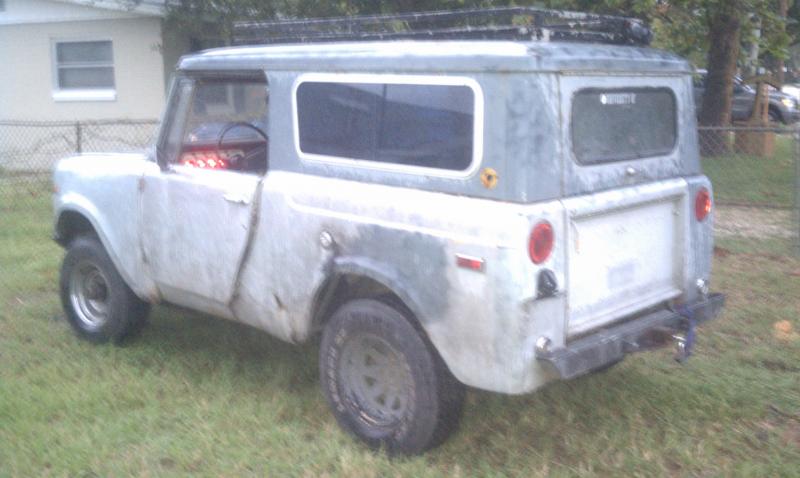

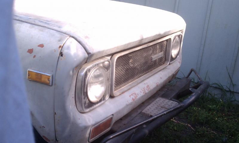

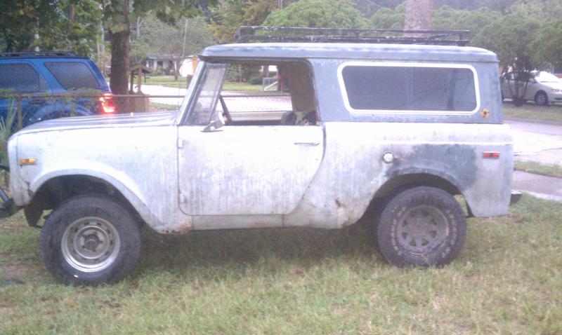

Just got this 71 800B a couple of weeks ago for a project. Not looking to restore to any kind of perfect shape but just a slow project to work on over time.
It has a IH 304, t727 auto, Dana 300. It runs and drives except reverse is not working and neutral drives forwards.
I would like to swap out the tranny for a manual (t98 or t19?) but not sure what I will need for that yet. I'll be searching over the threads for info but any direct info is always a help. I'm in daytona if anyone else is around florida.
I'm new to these forums and relatively new to IH projects. I'm looking forward to tearing this one down and building it back up!
Here are some before pics

Welcome to the forum. Your trans and t-case combo are not original to your 800 and so were swapped in from a 1980 Scout II at some point. The shifting malfunction could be as simple as the shifter cable being out of adjustment, preventing full travel of the shift linkage. The 727 is a pretty robust automatic when everything is as it should be.
