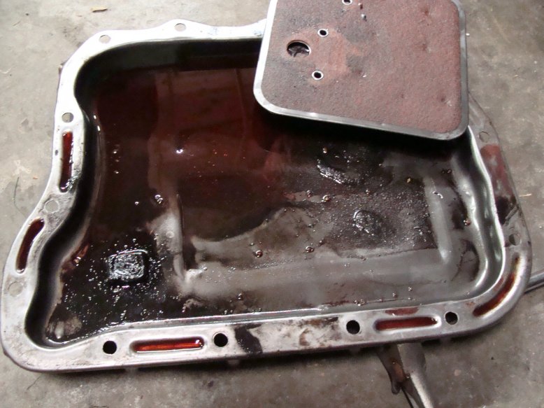

Tranny pan...:yikes:

tranny pan...:yikes:
That my friend is not a good sign...far worse than "normal sluff" found after say 20k miles!!!
Something is broken.
I'm going to suggest that the overrunning clutch race has broken loose and spun in the case. That is the last component to be accessed/inspected during teardown.
Some folks throw bullshit and say "all 727 trannys are weak in that area". Total crap statement, the overrunning clutch fails because of abuse, too much torque/hp for the particular tranny build, or it was damaged previously and either overlooked or ignored during the previous rebuild (most likely).
Some of that metallic residue is steel (the inner and outer races, springs and rollers), and some of it is the aluminum case itself which is possibly now badly stripped and will not hold an oem press-in race. That is when we install a "bolt-in sprag" which is a repair component used in order to hopefully salvage the case, if not the case is destroyed.

Given the value of that vehicle, I'd suggest having the unit done correctly by a pro who knows the 727, knows how to perform normal performance unit upgrades, and has access to the correct service parts.
With the level of debris I see, there is something badly damaged internally, this is not something that can be "fixed" at this point.

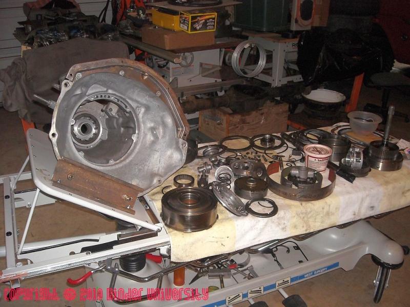

Pic attached is a unit we did for a customer just last week, I installed a dodge motorhome tailshaft and housing into a IH 1310 727 core. Reason being the customer is installing a gearvendors under/overdrive unit on it and those are only available now for the dodge tailhousing pattern.

This pic shows the red 727 after cleaning and mounting on the surgery table. All the guts are laid out.

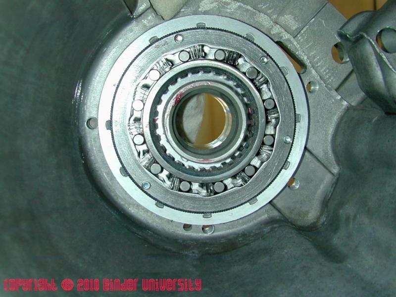

If you look inside the case at that dark ring, that is the outer race for the overrunning clutch. The oem part has a very fine spline cut into it's periphery, then it's pressed into the housing and has an "insurance" set screw locked into a indentation.
The repair race is exactly the same except it has three holes drilled into it. Those holes have to align with three of the holes that retain the output shaft support and three special fasteners are used to retain. Thus the race is locked into the case and we're able to save a case that has had the race bore ripped out.

This pic shows a typical bolt-in sprag race after the installation is completed and the inner race, springs and rollers have been installed.
