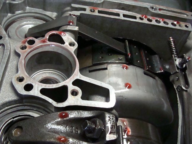

Pic attached is a unit we did for a customer just last week, I installed a dodge motorhome tailshaft and housing into a IH 1310 727 core. Reason being the customer is installing a gearvendors under/overdrive unit on it and those are only available now for the dodge tailhousing pattern.

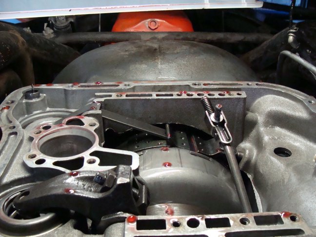

This pic shows the red 727 after cleaning and mounting on the surgery table. All the guts are laid out.
If you look inside the case at that dark ring, that is the outer race for the overrunning clutch. The oem part has a very fine spline cut into it's periphery, then it's pressed into the housing and has an "insurance" set screw locked into a indentation.
The repair race is exactly the same except it has three holes drilled into it. Those holes have to align with three of the holes that retain the output shaft support and three special fasteners are used to retain. Thus the race is locked into the case and we're able to save a case that has had the race bore ripped out.

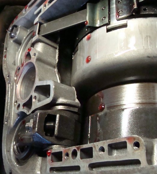

This pic shows a typical bolt-in sprag race after the installation is completed and the inner race, springs and rollers have been installed.

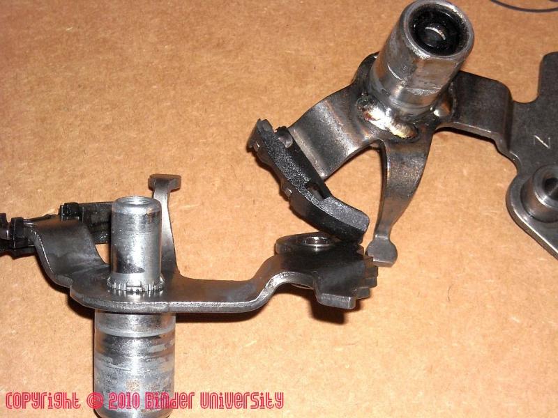

I haven't found variations in the kickdown lever on the shift tower...but that certainly doesn't mean I've seen 'em all! There are many variations of the "shift" lever though, that is to accommodate the myriad versions of shifter controls used with all these trannys, the lever for a Scout II floor shift is cable controlled and the strangest of all!.. The dodge motorhome shifter is also a dash-mounted shifter that used a cable instead of the "johnson rod" linkage used on most of the chrysler floor shifters, the column shifters were yet another variation.
In the case of your setup...the kickdown control system that is engine-mounted must match the lever length on the trans! Even just 1/4" difference in the leverage ratio is huge! So I'd use either all the parts from the motorhome or all the parts from the charger. Then adjust the system so that as soon as the throttle linkage moves off idle, the throttle pressure lever begins to move also. When the throttle is wot mechanically, the throttle pressure control lever must be all the way back and lightly against it's internal stop on the valve body.
Throttle lever actuation and throttle pressure activation should be a "coordinated movement" in a one-to-one ratio (within reason!).
If a shift kit was installed, there is a one-time adjustment for the pressure regulation system outside the valve body. Each type of shift kit is different in that respect, so I'd have to know exactly whose shift kit was installed and which version, in the case of transgo, there are three different kits currently and in earlier days there were two "different" kits they supplied!
