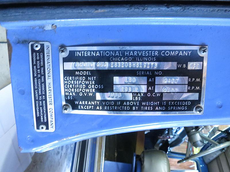

looking for the vin location on this truck so that I can order a line setting ticket.

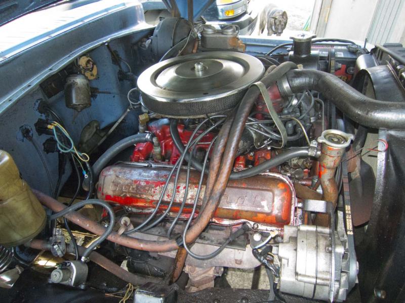

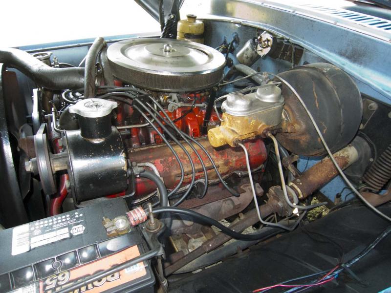

Runs pretty well, though she's blowing oil out of the dipstick, some out of the exhaust but no blue or white smoke.
Transmission seems to be ok. We've been driving her on short trips until she really started to blow the oil. My local mechanic said that's an indication we need to rebuild or overhaul. They don't want to touch it.

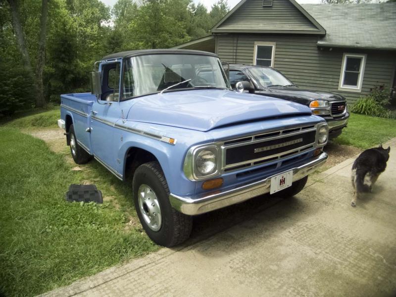

Welcome to the forum. Man, that is a damn sharp lookin' round body peekup! Even if the engine is complete toast, the body alone is worth doing all you can to preserve. Donor engines are a dime a dozen by comparison. Your vin is the number on the tag just to the right of where it says..."1200c 4x4".

Oil escaping from the dispstick tube indicates a condition known as "blow by". It might be that your engine is in need of a rebuild as your fraidy-cat mechanic said, or it might simply be that your crankcase ventilation system is not doing its job. That option should be thoroughly investigated before declaring the engine as "too pooped to pop."
Hey thanks! We really love this truck. Soon as I get some shot I'll show some photos of the inside. Really well maintained or restored interior. Glove box has a cracked vinyl but that's about it. Love the search lite on there too. Wife says it makes her feel like the federal b.I.
I'll recheck the crankcase ventilation to be sure. Mechanic said that he'd ruled that out.

Thanks for the vin information. I'd read somewhere that the vin was on the frame somewhere and not the number on that tag, or that they might be different. I will use that number to get my line ticket. Looking forward to seeing that!
