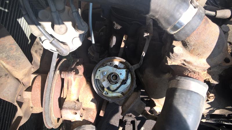

So I put the new box on again. I turned the distributor and got it running smooth, but it started dying again so I couldn't hit it with the timing light. I pulled the cap and dust cover off the dizzy to inspect the it, well no points. Now my problems evolved. I found a pertronix ignitor instruction sheet and a receipt of the installation. It said 73 Scout on the work order, and the po did own multiple scouts. My question is did they have an electronic distributor with the gold box ignition. I ask because the module is white and has two black wires, the few pertronix modules I've seen were black. Also as per the instructions it indicates a pertronix has a red and black wire.

Not really up on the electronic gold box distributors, but have run a few pertronix ignitors. Couple of questions to help trouble shoot. 1. Did it run ok before the new fuel pump, filter, and carb clean? 2. Are you sure it's an ignition problem and not a fuel problem? If it is a pertronix ignitor, you don't need the gold box. When it dies, pull one of the plug wires off a plug end, stick a spare spark plug in the end, lay it on the block some place where its grounded, and crank the engine to see if there is any spark.
Your distributor is a Holley electronic unit and needs the Holley gold box connected and properly grounded to work properly.
You do not have a pertronix ignition on that engine.
Set sv-8 timing off of cylinder #8, set I-4 timing off of cylinder #1, around 5 to 10 degrees btdc is a good place to start. See how it runs there.
Adjust the carb curb idle speed as necessary to maintain idle speed of 675 to725 rpm.
Edit: the gold box unit does not Control or cause the ignition timing to change or advance etc.
Also the air gap between the distributor "cam" and the electronic pickup should be .008".
Check and adjust this if necessary, with the ignition "off".
