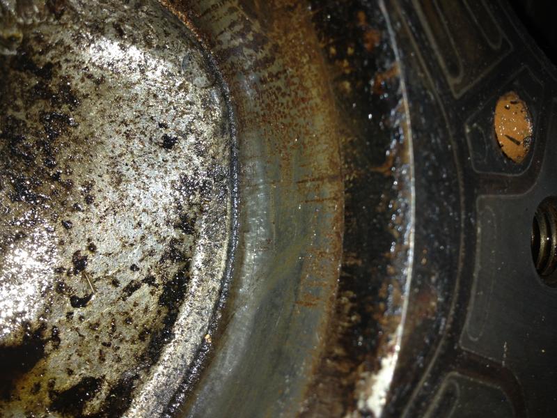

The engine is out and to my nice supprise what I thought was itching or grooves was carbon buildup. What is the best method to properly remove the buildup? Now I do have a lot of damage to the piston. From the pictures attached can you tell should I just replace the one piston or replace them all. This is my first project of this magnitude. I want to do it right without spending more than necessary. Any advice or links to follow would be appreciated.

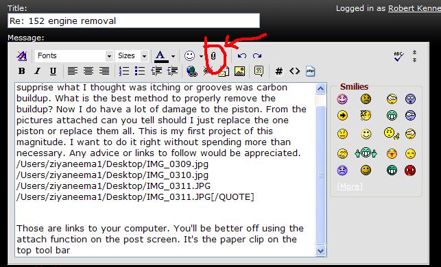

Those are links to your computer. You'll be better off using the attach function on the post screen. It's the paper clip on the top tool bar. See attached photo.

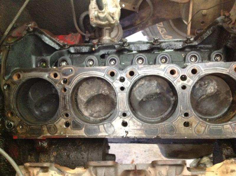

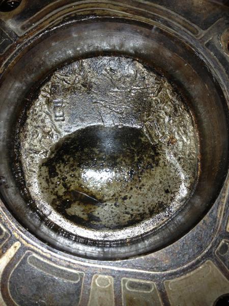

Lets try that again here are the pictures of the cylinders, pistons and buildup.

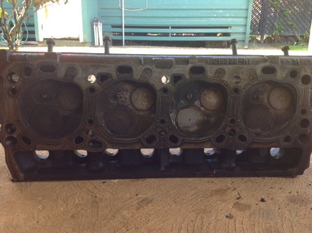

Wow!! That thing has been through a lot during it's life. What do the combustion chamber's look like. It either ingested a foreign object or it was stuck and someone pounded the pistons free..
In your case I'd want to tear it the rest of the way apart and asses the damage.
The carbon at the top is easily scraped off with a single edged razor blade. Then a good cleaning with carb cleaner to remove the left overs.
I do see some water damage which is pitting. Once you have it apart buy a bottle brush hone of 220 grit and give it a licking making sure to move up and down so you have cross hatch.
After it it is clean measure it up with a bore gauge of telescoping gauges and a micrometer. See what you have for wear. Or post up numbers. We'll decide then.

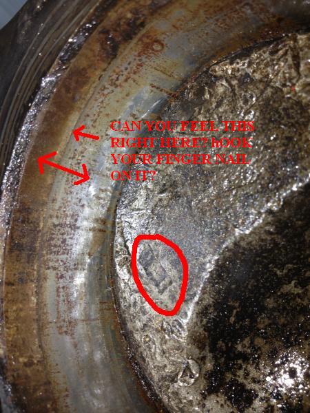

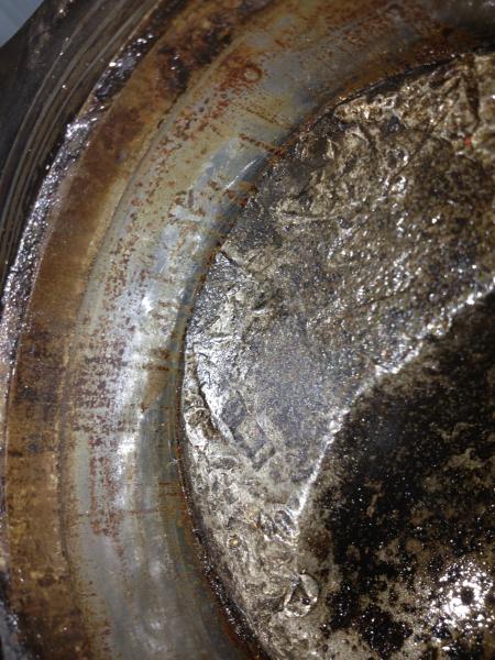

Hard to tell but is one beat to crud like the piston? In the circle it looks like the imprint of a nut on edge.

Yes I can feel the ridge and you are exactly right about the nut. Apparently the missing nut I lost on the air filter found its way into the intake manifold. As soon as I heard the noise I knew what happen but the engine was warmed up and the damage was done. That is why this project was started. The nut was completely gone when I pulled the head just a few pieces of metal.
Sorry about the nut eating ordeal. Just guessing that it would be best to bore it. Can you pick up any numbers stamped on the existing pistons? Usually on the round flat valve relief. I have a set of those in .020 over that we could talk about if you end up going that route.
Finally had time to pull the pistons. I had to clean a lot of carbon off but found the numbers stamped on them 216160-r1 the measurements on the pistons are 3 27/32. The cylinders I used a engine cylinder hone tool with a 240 grit stone to remove the lip on the cylinder the cylinder measurement is 3 7/8. I was able to clean up the damaged piston pretty well I will attach a picture when I can get the picture down down loaded. The sides of the piston look good no appearent damaged should I still replace it or them? I have not removed the camshaft yet. At this point in the disassembly would you recommend continuing and replace any camshaft seals and bearings?
You really need a good set of micrometers to measure the piston. If you just want to do minimal work and simply have fun with your Scout, hone all of the cylinders like the first one, find an old usable standard piston to replace the bashed up one and install new rings bearings and run it. Will probably be fine really for even a daily driver. These things were designed to be field serviceable.
Ok I fininished honeing the cylinders and took new mesuerments. The cylinders are 3.888 or 3.889mm would you recommend just replacing rings or getting new oversized pistons. Although I only drive 30 miles a day this is my daily driver and I the island I live on is mountainous. About a thousand foot elevation change to get home.
If the pistons were right on 3.875 you would have .013 clearence. .0025- .004 is a good range. I would bore it. The machine shop needs to take there own measurements to determine how far to go over size. Probably .030.
