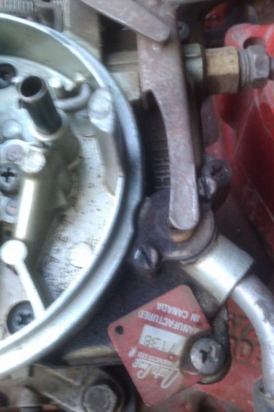

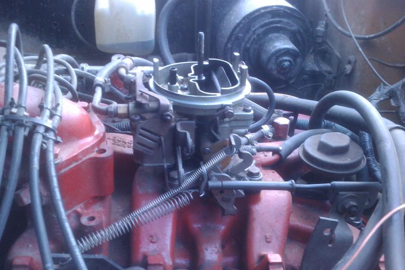

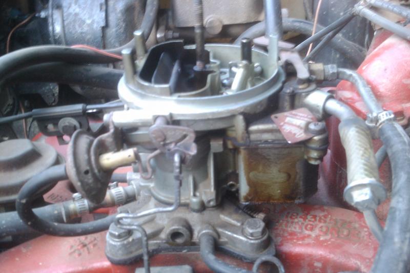

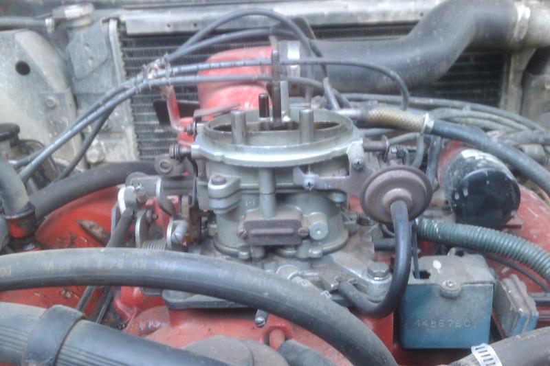

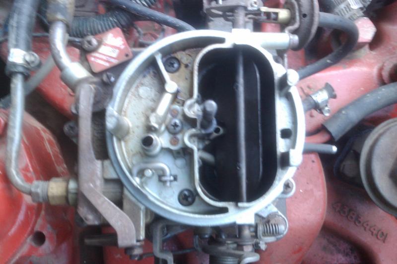

Here are some pics, let me know what you think. Btw it ran fine on the way home, sputtered a little bit but hardly noticeable and only once and a while. Been driving it tonight and having no problems, somewhat sputters but driving none the less. Yes the list on the 2300 was 4412.... I had another one that was had 7448 on it, but it also had 4412 lol :s but thats here nor their cause I dont have it anymore.

Thanks. The carb is a Holley 22xx. One picture clearly shows evidence of raw fuel seepage from the fuel bowl due to gasket failure. Overall I'd have to disagree with your assessment that its in like new condition. Looks to me like a candidate for a rebuild.
I see quite a few vacuum lines capped off. Any one of which has the potential for creating a vacuum leak. Your throttle return spring routing looks kinda dicey. Not that its contributing to your performance issues, but as a general safety concern, those could use some improvement.
This type of carb incorporates a divorced choke mechanism that is pulled off via a vacuum diaphragm. Have you watched the choke mechanism during a cold start to see that it functions properly?
You've also got an egr valve which is the brass-looking object behind the carb. These are failure prone. Is there still a vacuum line connected to it?

As for that gasket that looks like it leaked, I didnt notice that till I was taking the pictures. So yes, its deffinatly going to need to come apart be cleaned and rebuilt... Yes the I know the throttle springs are a little funny, I only had one on there and didnt like the tension of the gas pedal and didnt have any other springs that were stronger so I put 2 weaker ones.... It was like new when I put it on 2 months ago and there deffinatly was not leakage in the gaskets.

there is no vacuuum line to the egr and it is capped off. I honstly dont know where lots of those lines go and most were capped off when I got the carb.
