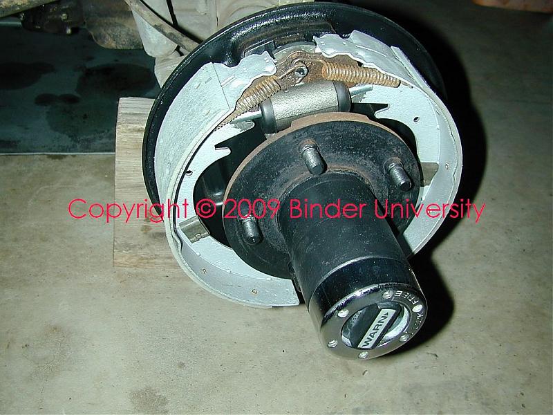

As for the front drum removal, the hubs and drums are lightly "swedged" together when originally manufactured. So ya gotta remove the locking hubs and spindle nuts to pull the assemblies off the spindle/backing plates.
Once the hub/drum assemblies are on the bench, you can do surgery and "make" the drum come off the hub so that in the future it can be removed without disturbing the hub/bearings.
Here's a pic of a similar setup on mine, even though the axles/spindle systems are different from yours, the concept is exactly the same.
