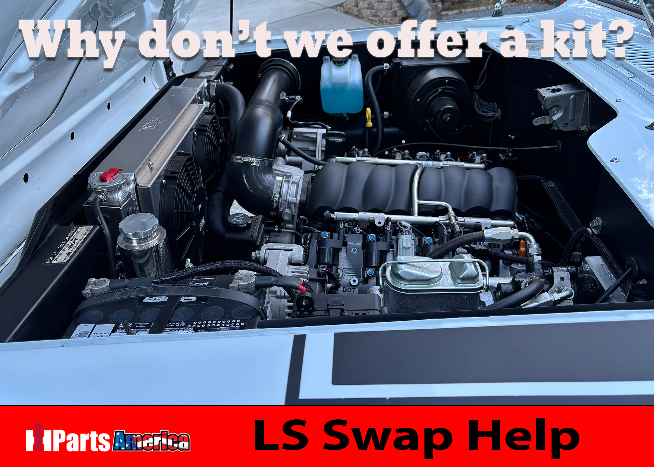

Think of it this way. You're building your dream Scout, and you've decided to drop an LS engine under the hood. Now imagine buying a complete swap kit that forces you to use a certain set of parts, mount everything in a specific location, and build your Scout around what comes in the box. But what if you want to run a different transmission? A different transfer case? Maybe you have a certain way you want your exhaust routed or your engine positioned.
That's exactly why we don't offer a one size fits all LS swap kit. No two Scout builds are exactly alike, and we don't believe you should have to build yours around someone else's idea of what works best. Instead, we'd rather help you pick the right parts for your particular build, giving you the freedom to put things together the way you want.
Guidance is always great, which is why this thread is starting. We have over 15 years experience in LS swapping, and quite honestly I believe we produce the best driving Scouts out there. With this guidance, you should be on the right track to set up your Scout to be reliable and powerful.
Before you start buying parts, the first thing you need to figure out is what you're actually working with. Is it a Scout 80, Scout 800, Scout II, or an IH pickup or Travelall?
You might think an LS swap is pretty much the same regardless of what you're putting it into, but that's far from the case. Each of these vehicles has its own challenges when it comes to engine placement, available space, drivetrain options, and everything else that goes into making the conversion work.
When you add 4x or more of the original power to your IH, everything down the chain needs to be strengthened to accommodate the increase of HP. Unless you have a really good life-insurance policy and don't care, you might want to put just as much attention to the rest of your build to make sure you aren't building a death-trap.
Knowing what you're starting with will play a huge role in how you plan your build and which parts you'll need along the way.

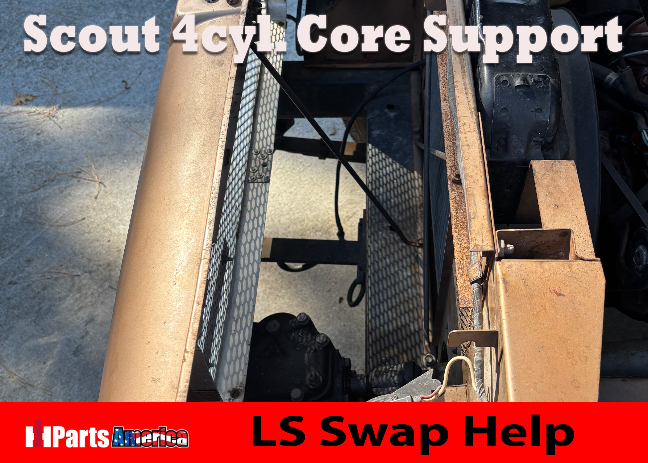

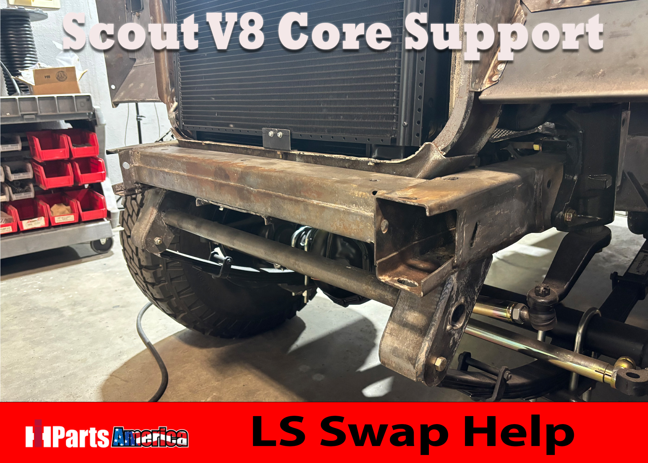

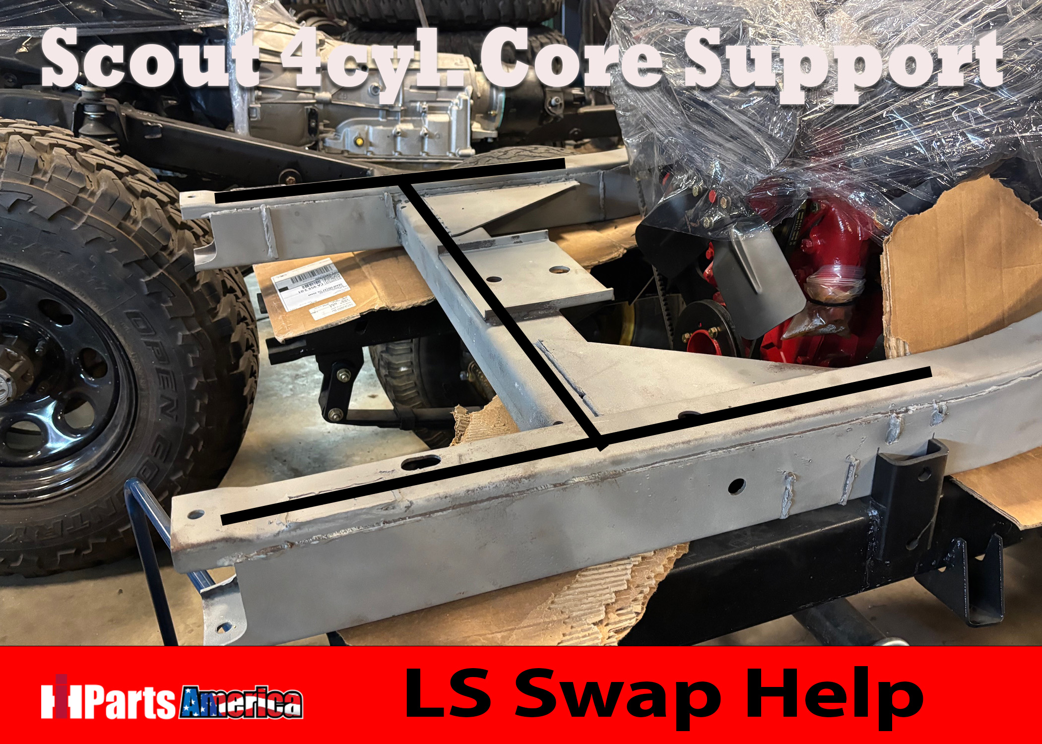

When it comes to a four cylinder Scout 80 or 800, the frame is your first major hurdle.
If you've ever popped the hood on one of these early Scouts, you might have noticed the huge amount of empty space between the radiator and the grille. There's actually a reason for that, and it's something you'll quickly discover when trying to squeeze a V8 under the hood.
From the factory, these Scouts have a welded frame crossmember positioned farther back to accommodate the original four cylinder engine. While that worked perfectly fine for the factory setup, it becomes a major obstacle when trying to fit a much longer V8 engine into the same space.
This is where an LS swap starts becoming more than just a matter of bolting in a new engine. You're now looking at making modifications to the frame itself before you can even begin figuring out where everything else is going to fit.
...compared to a later V8 Scout 800 frame...
As you can see, the front crossmember sits much farther forward compared to the factory four cylinder frame. There's a good reason for that. If you don't relocate that crossmember, you'll quickly run out of room trying to fit an LS engine under the hood. In fact, by the time you get everything positioned, you might find yourself with half the engine sitting inside the cab.
Now, remember that domino effect I mentioned earlier? Well, here's a perfect example of it. This is also one of the reasons why starting with a factory V8 Scout can save you a whole lot of work right out of the gate. On the four cylinder Scouts, the steering box is mounted on the inside of the frame. Once you start moving things around to make room for that LS engine, including relocating the radiator core support forward, the factory steering setup becomes another obstacle. You'll need to move the steering box to the outside of the frame, just like the factory V8 Scouts.
Fortunately, this is one area where IH Parts America can help. We offer a power steering conversion kit designed for factory V8 frames or four cylinder frames that have been modified for a V8.

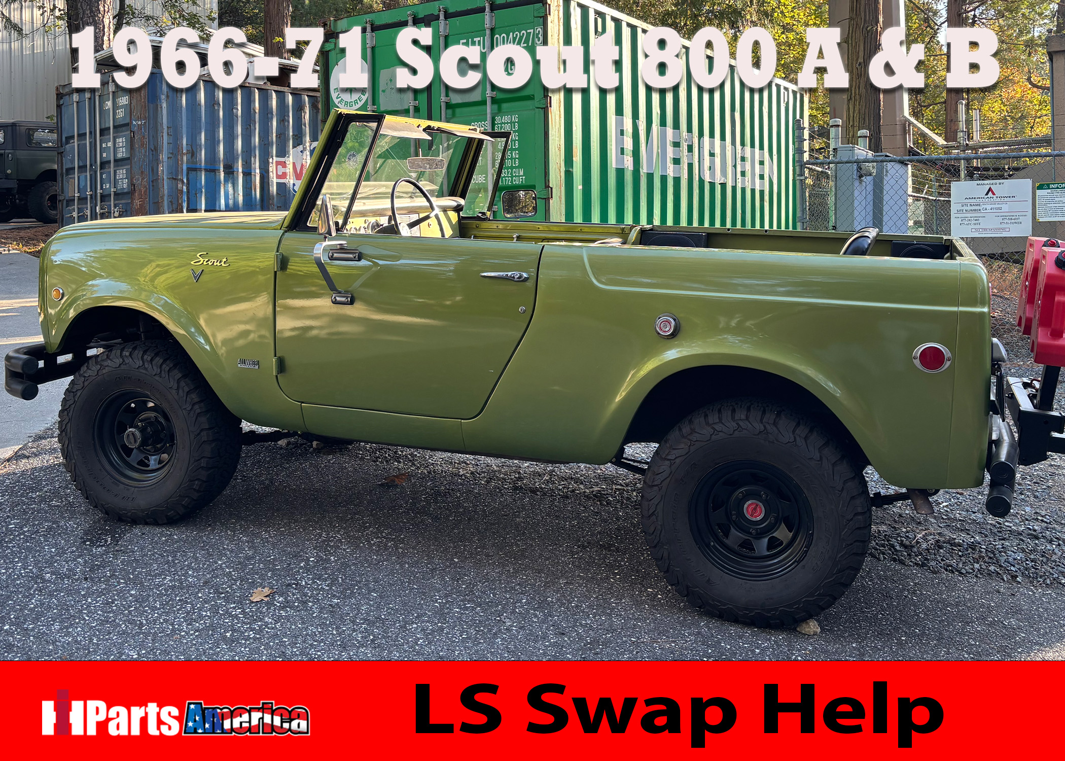

Next up is the 1966 to 1971 Scout 800, including the 800A and 800B models. Sorry if this all sounds redundant - worded for the novice.

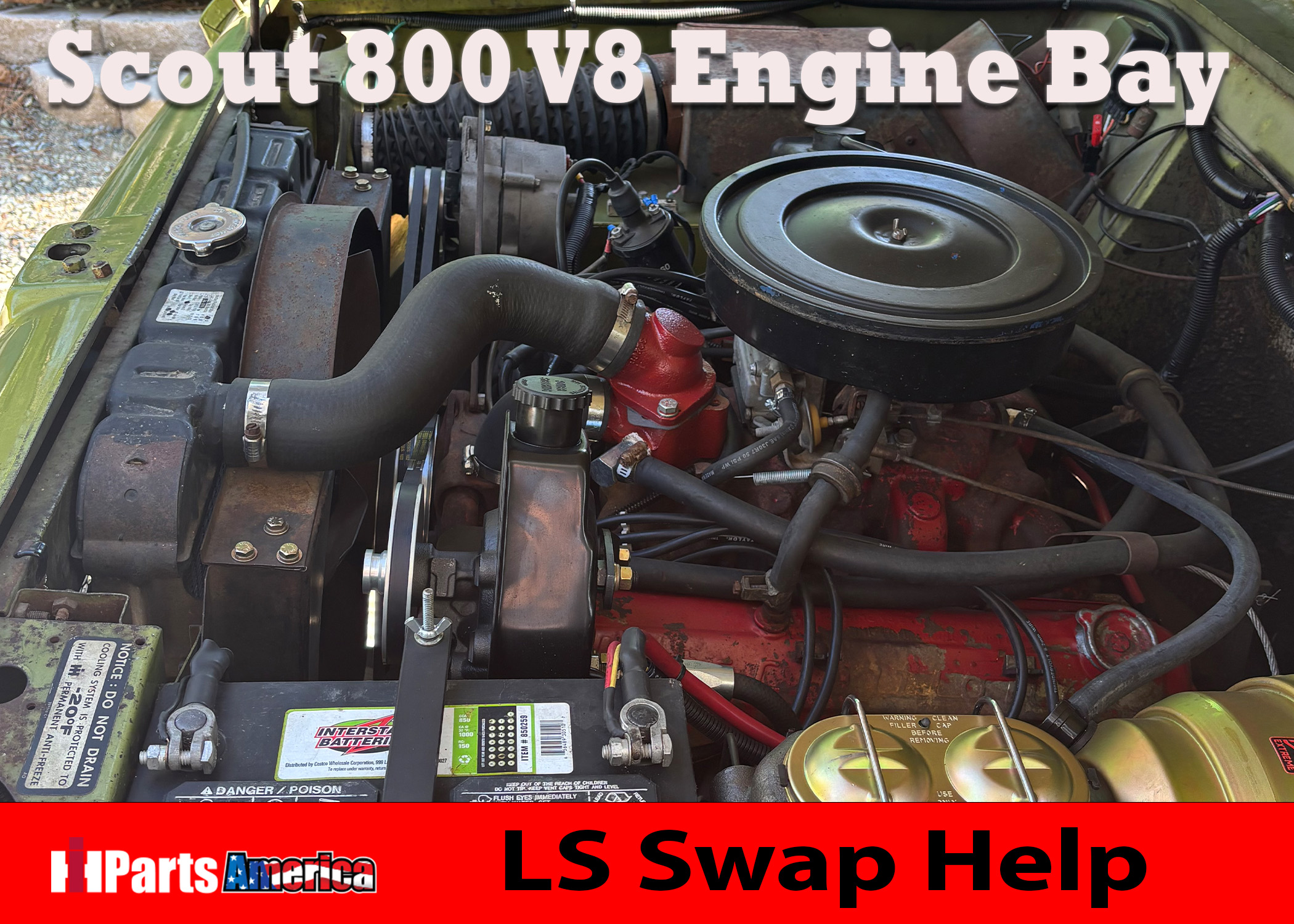

This is where things start getting a little more interesting. Unlike the earlier Scout 80, the Scout 800 was offered with several engine options throughout its production run. These included the IH 196 four cylinder, IH 266 V8, IH 304 V8, and the AMC 232 inline six.
Here's where knowing what engine your Scout originally came with makes a big difference. The 266 V8, 304 V8, and AMC 232 inline six all shared the same firewall and radiator core support configuration. This means that if you're starting with one of these models, you've already got a head start when it comes to fitting an LS engine under the hood.
If you're starting with a four cylinder Scout 800, however, you're going to run into many of the same obstacles we just covered with the Scout 80.

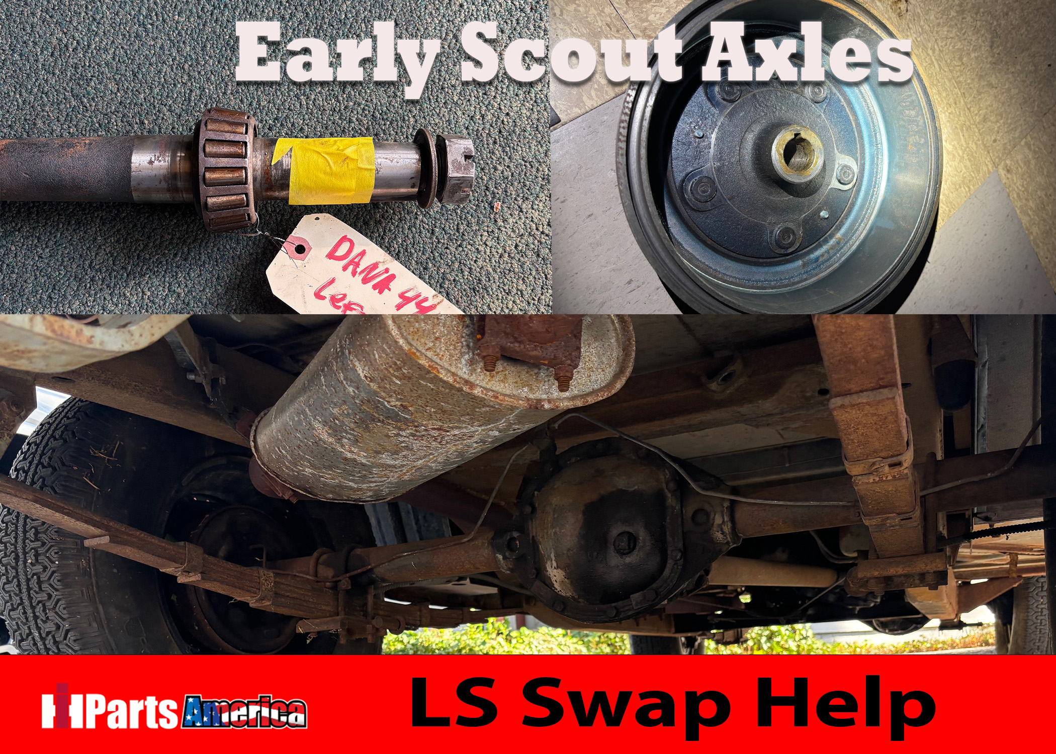

Why does any of this matter for an LS swap? Because not all Dana 44s are created equal. Those later 1969 to 1971 rear axles are a much better starting point than the earlier two piece designs, thanks to the improvements IH made over the years.
Does that mean they're automatically ready to handle whatever LS engine you throw at them? Not necessarily. But if you're trying to figure out what you can keep and what should probably go, knowing which axle is under your Scout can save you some headaches and money down the road.
Unless you're keeping your Scout completely stock and only driving it around town or taking it to the occasional parade, I wouldn't trust these axles, especially the Dana 27.
Here's where the design really starts to show its age. The early two piece Dana axles use tapered bearings that are essentially backwards compared to the later axle designs. When you take a corner and put a side load on the axle, the bearings actually want to separate from the taper rather than stay seated against it. Not exactly something you want happening when you're putting more horsepower to the ground.
To make matters worse, the axle shafts themselves are obsolete and rely on each other for thrust. There's a thrust pin inside the carrier, and bearing preload is adjusted using shims behind one of the axle retainer plates. It's an outdated setup that leaves a lot to be desired, especially when you start introducing the power of an LS engine.
And while we're on the subject, I have a bone to pick with vendors selling disc brake conversion kits for these early axles. Because of the way these axles handle side loads and axle shaft movement, the brake rotor can actually shift its position in relation to the caliper when you're cornering. This can cause uneven pressure, poor rotor centering within the caliper, and a whole list of potential problems down the road. We hear lots of complaints of this issue. That is why we do not advertise our kit for use with two-piece axles.
There is zero ring/pinion availability for Dana 27's. Early Dana 44's are limited to the OE Power Lock and open differential, and Limited support for the Dana 30. We like to retain Scout II axles or our CPT Rear Ford 9" Assembly.
Just because someone makes a disc brake kit for an axle doesn't mean that axle suddenly becomes a good choice for a modern drivetrain.

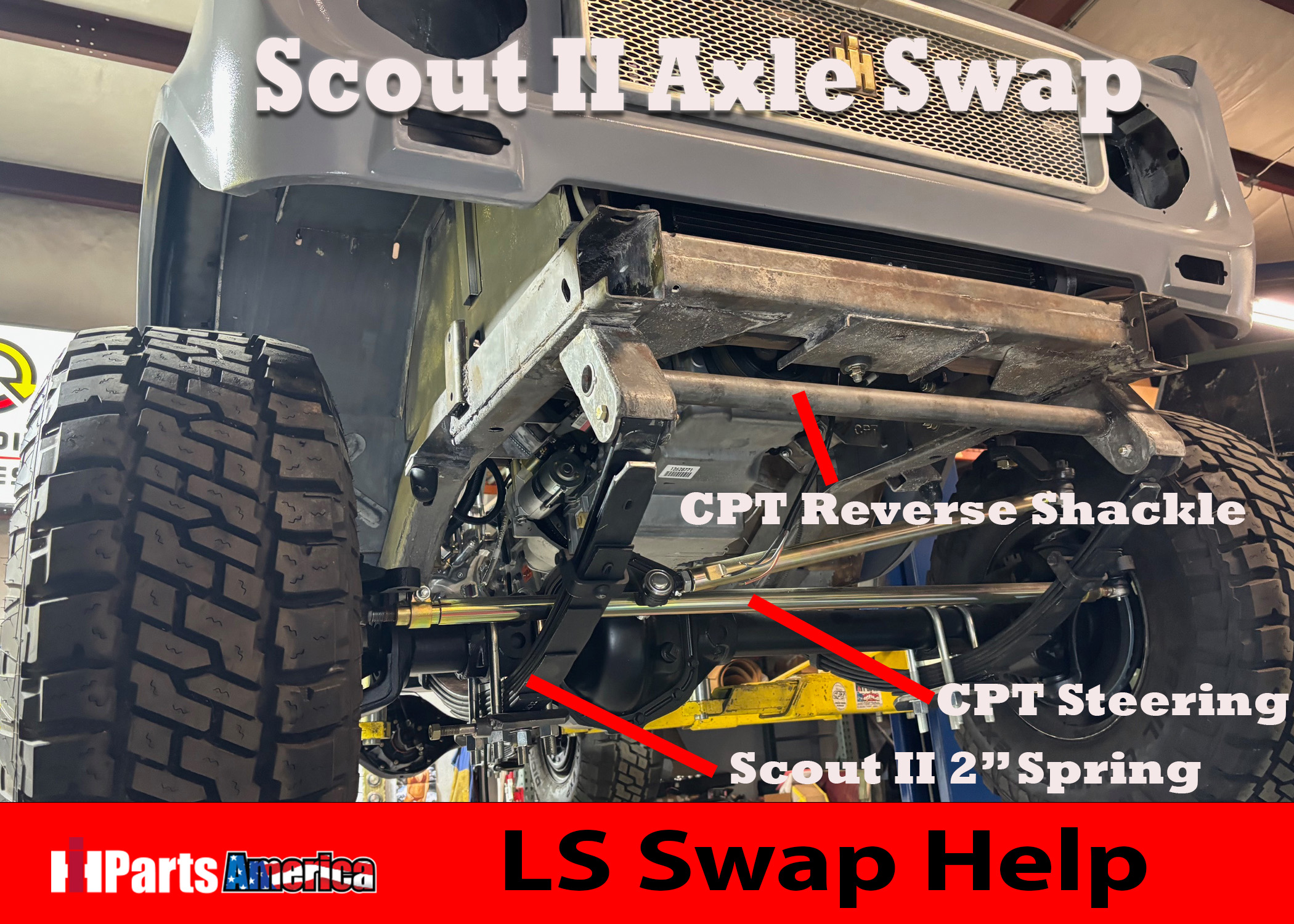

When swapping Scout II axles under an early Scout, one thing you'll notice right away is the difference in width. A Scout II axle measures 58.5 inches from wheel mounting surface to wheel mounting surface, commonly referred to as WMS.
For comparison, a Scout 80 measures around 55 inches, while a Scout 800 comes in at 57 inches. That means even compared to the wider Scout 800, you're only gaining 1.5 inches of overall axle width with the Scout II setup.
That little bit of extra width is actually a good thing. It gives the Scout a slightly wider stance, which can help improve stability and handling, especially when you're adding more horsepower and building something you actually plan on driving.

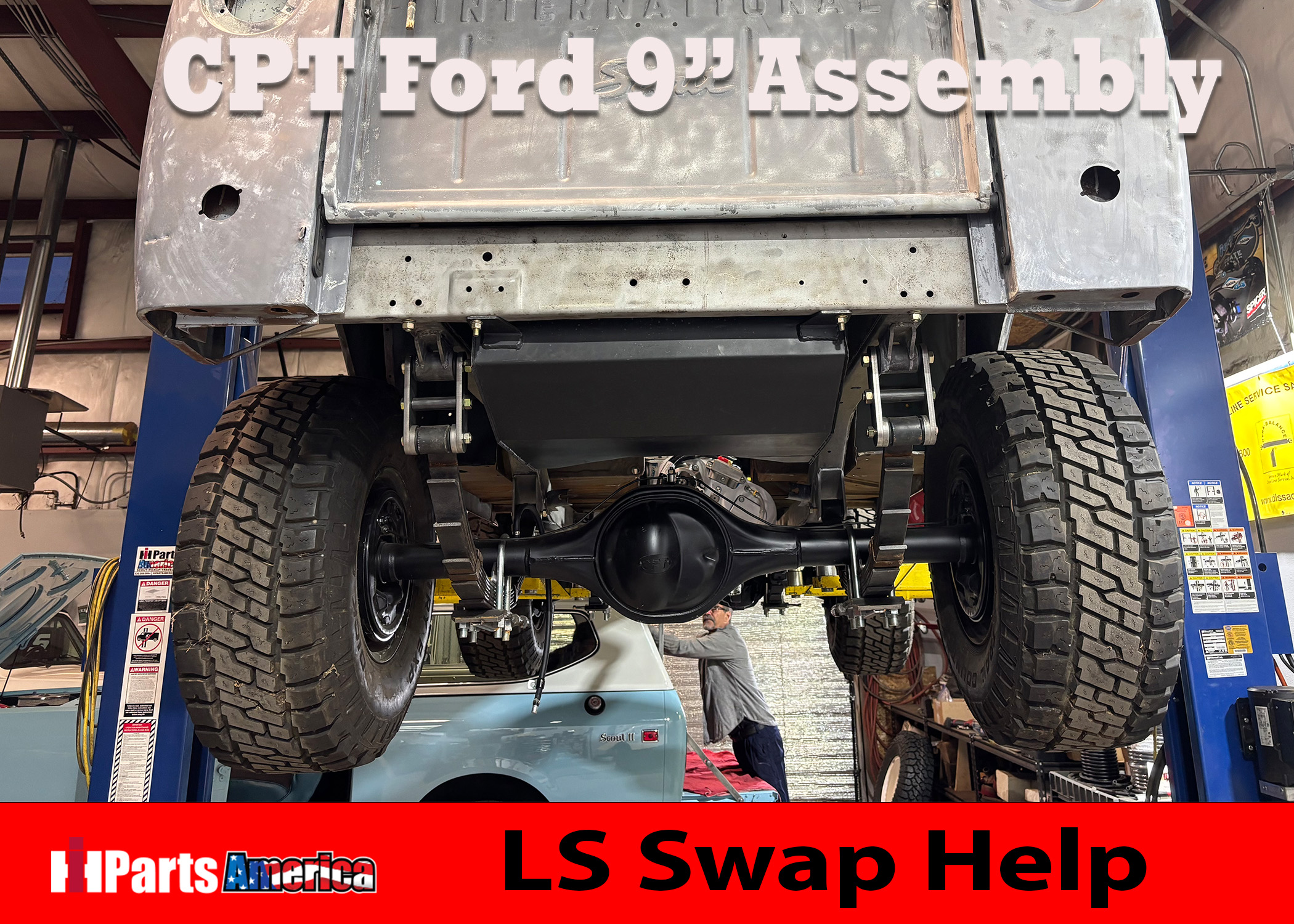

Now, while you could run Scout II Dana 44 axles front and rear, that's not typically how we like to do things here at IH Parts America.
Our preferred setup is to use a Scout II Dana 44 up front and pair it with one of our CPT Ford 9 inch rear axles. This gives you a much better foundation to build from, especially if you're planning on putting some real power to the ground.
After all, if you're already going through the trouble of swapping axles, you might as well put something under there that's worth the effort.

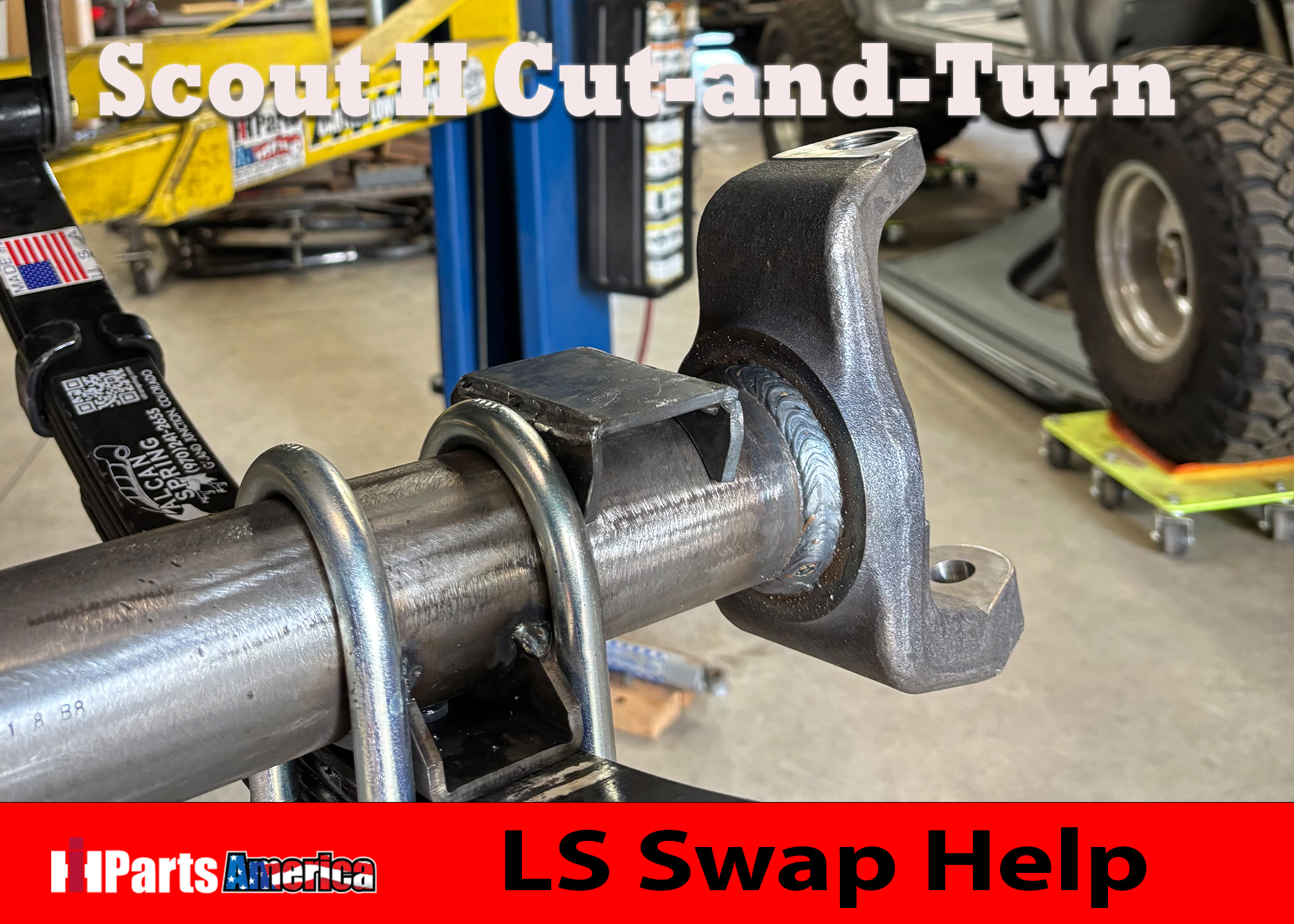

Here's a good example of what we're talking about with a current build in our shop. We've installed a CPT'ified Dana 44 front axle out of a Scout II, complete with factory disc brakes.
We also performed a cut and turn on the axle to maintain 4-5 degrees of positive caster. This is an important detail that often gets overlooked when swapping axles, especially on these early Scouts. Getting the caster angle right makes a big difference in how the Scout steers, tracks down the road, and returns to center after making a turn.
After all, there's no point in upgrading everything underneath your Scout if it ends up wandering all over the road when you're trying to drive it.
When we do these cut-and-turns, we go ahead and chop off the front axle C's. If you don't want to reuse your old ones, or ruined them - we have new ones. Axle C Set for Dana 44

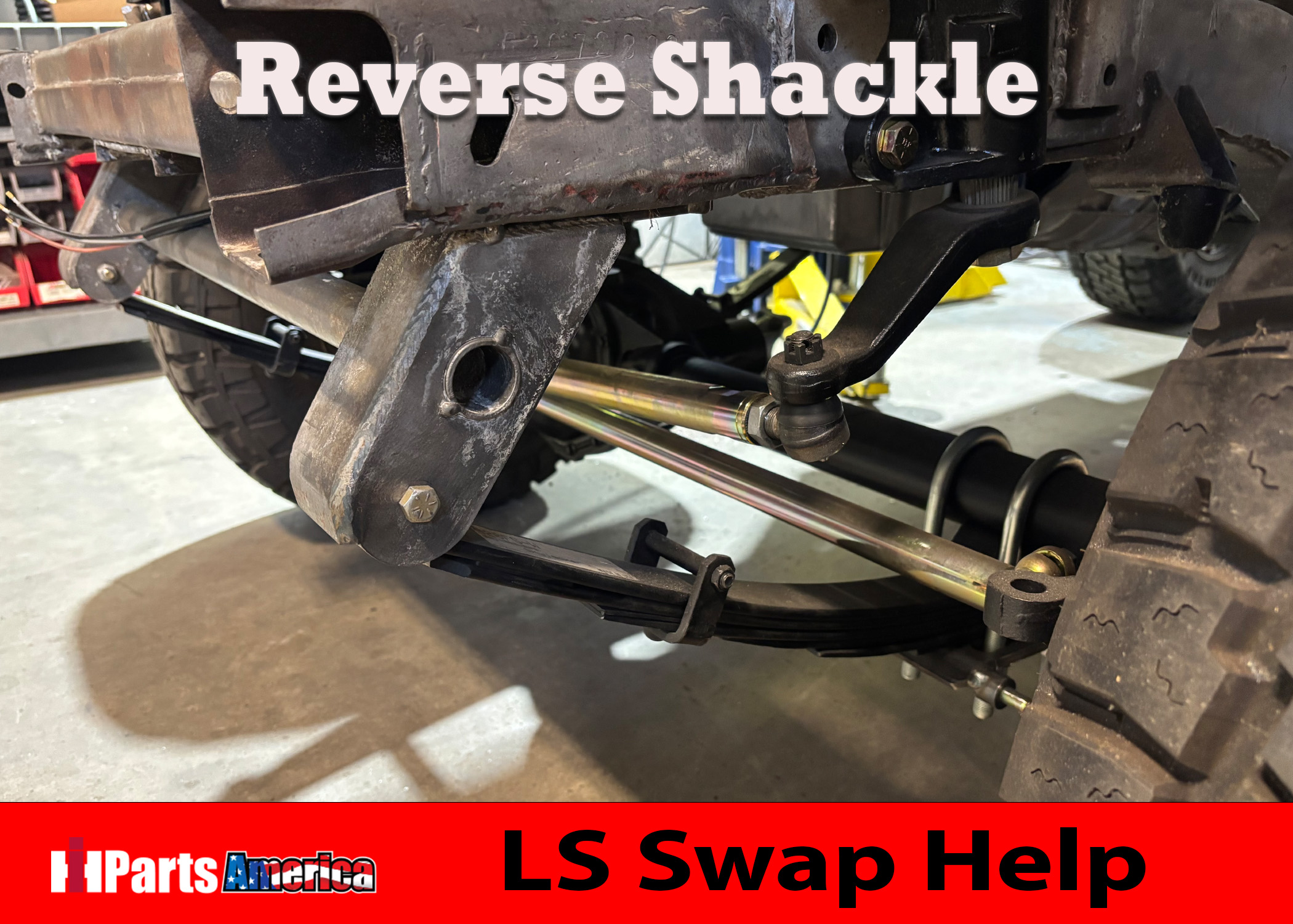

When installing a Dana 44 out of a Scout II under your early Scout, there's another thing to consider: leaf spring width. The factory Scout 80 and 800 springs are 1.75 inches wide, while the Scout II uses a wider 2 inch spring.
This is the perfect opportunity to kill two birds with one stone. Since you're already making changes to the front suspension, we highly recommend installing our CPT Reverse Shackle Kit for the Scout 80 and 800.
Not only does this give you the benefits of a reverse shackle setup, but it also allows you to run the wider 2 inch Scout II leaf springs. You can certainly stick with the original 1.75 inch springs if you'd like, but our thinking is pretty simple. If you're already going this far with your build, why not upgrade the springs while you're at it?
On the Scout pictured here, we're running a set of Skyjacker 2 inch lift leaf springs designed for the Scout II. It's a great example of how a few well planned upgrades can work together rather than trying to make a bunch of original parts work around your new drivetrain.

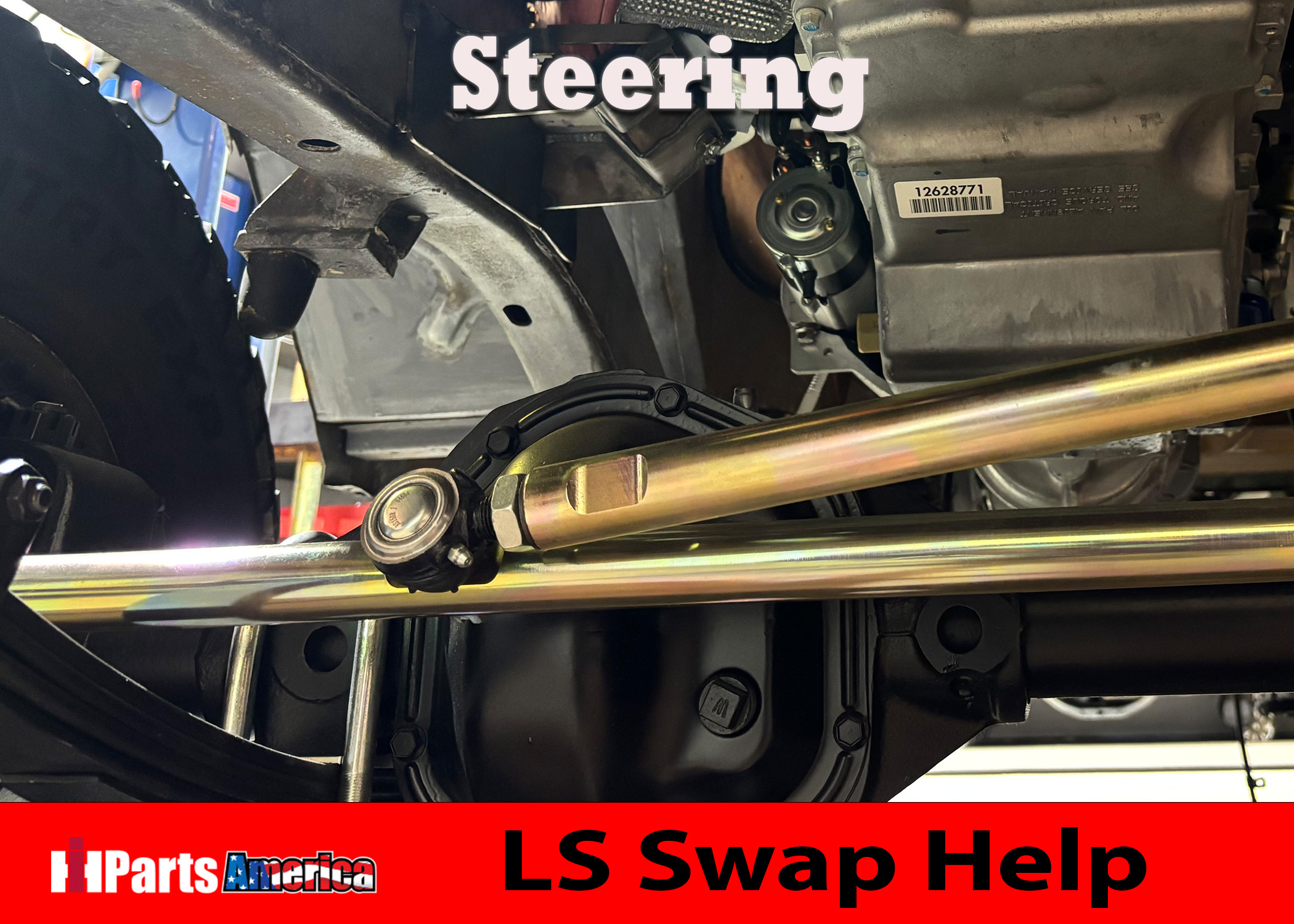

Now that you've got your Dana 44 mounted under your Scout, there's one more thing to figure out. How are you going to steer it?
With the new axle in place, you'll need a tie rod and drag link to get everything connected and working properly. Fortunately, this is another area where we've already done the homework for you.
CPT offers a direct fit steering linkage setup that takes the guesswork out of this part of the conversion. No need to piece together a bunch of mismatched steering components when we've already got a solution ready to go. We use a 46" long tube with modern ES150 replaceable ends. The draglink also uses the same ends. - Tierod and Draglink Assembly for the Scout 80 or 800 with Dana 44 Option.

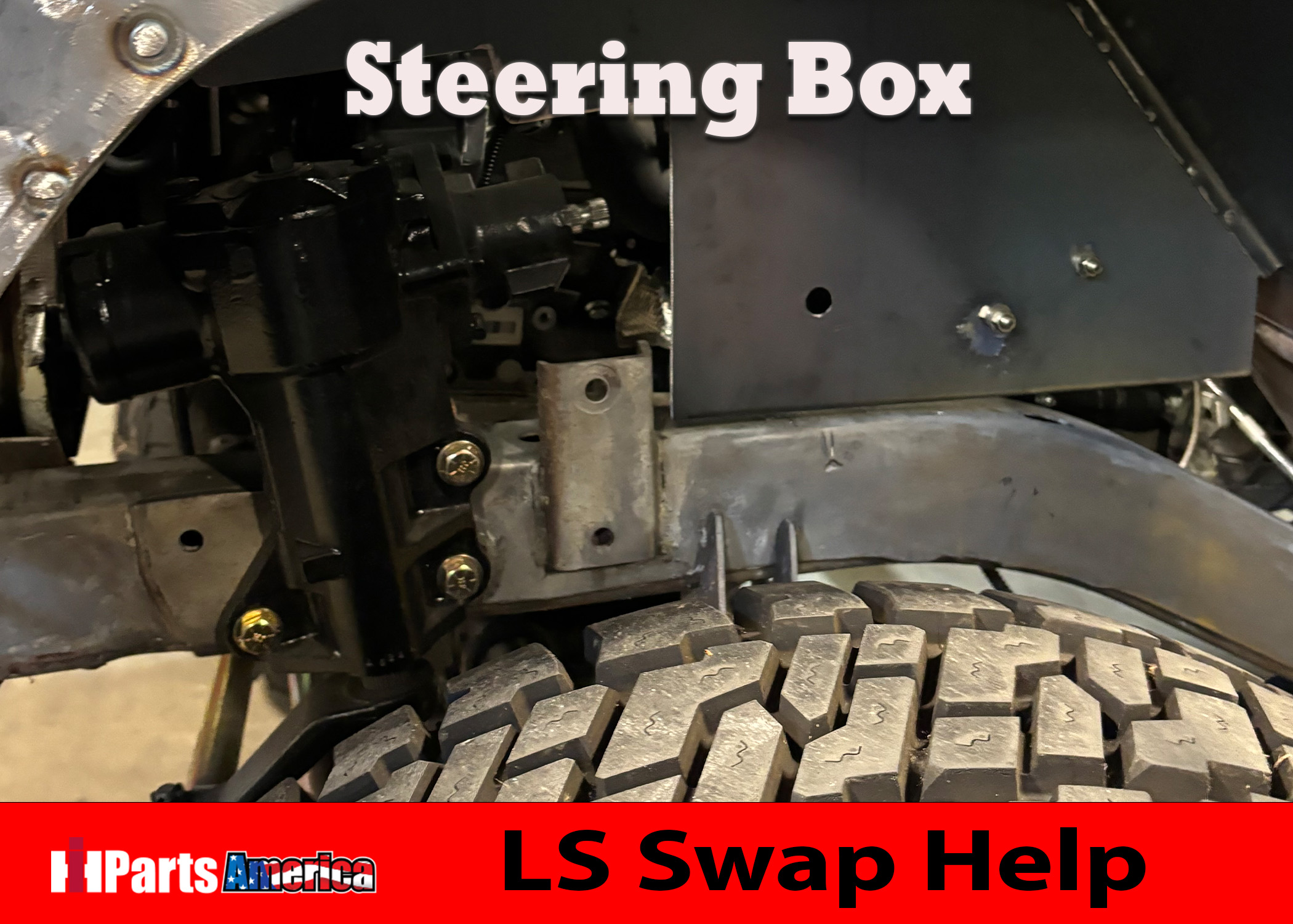

Now, when it comes to the steering box itself, that's where we leave the decision up to you. There are several ways to go about it, and how you choose to set yours up will depend on the direction you're taking your build.
One thing we definitely don't recommend is sticking with the factory manual steering box. Sure, you could make it work, but with the increased horsepower and performance of an LS engine, that old manual box is going to leave a lot to be desired. The steering ratio is simply too slow for the kind of driving you're likely building this Scout for.
If you're going through all the trouble of upgrading the engine, axles, and suspension, it only makes sense to give the steering some attention too. After all, going fast is one thing, but being able to comfortably control where you're going is just as important.
CPT does have a bare-bones steering box kit as mentioned earlier: Part Number: CPT-S800-AB-PSKIT-LS if you would like to copy what is seen on the picture. Major fabrication skills and competence is needed throughout the build process.
As seen, the steering kit ties into this steering box quite well. The pitman arm used is IHPA part number: PM-18006-03 known as Pitman Arm #3.

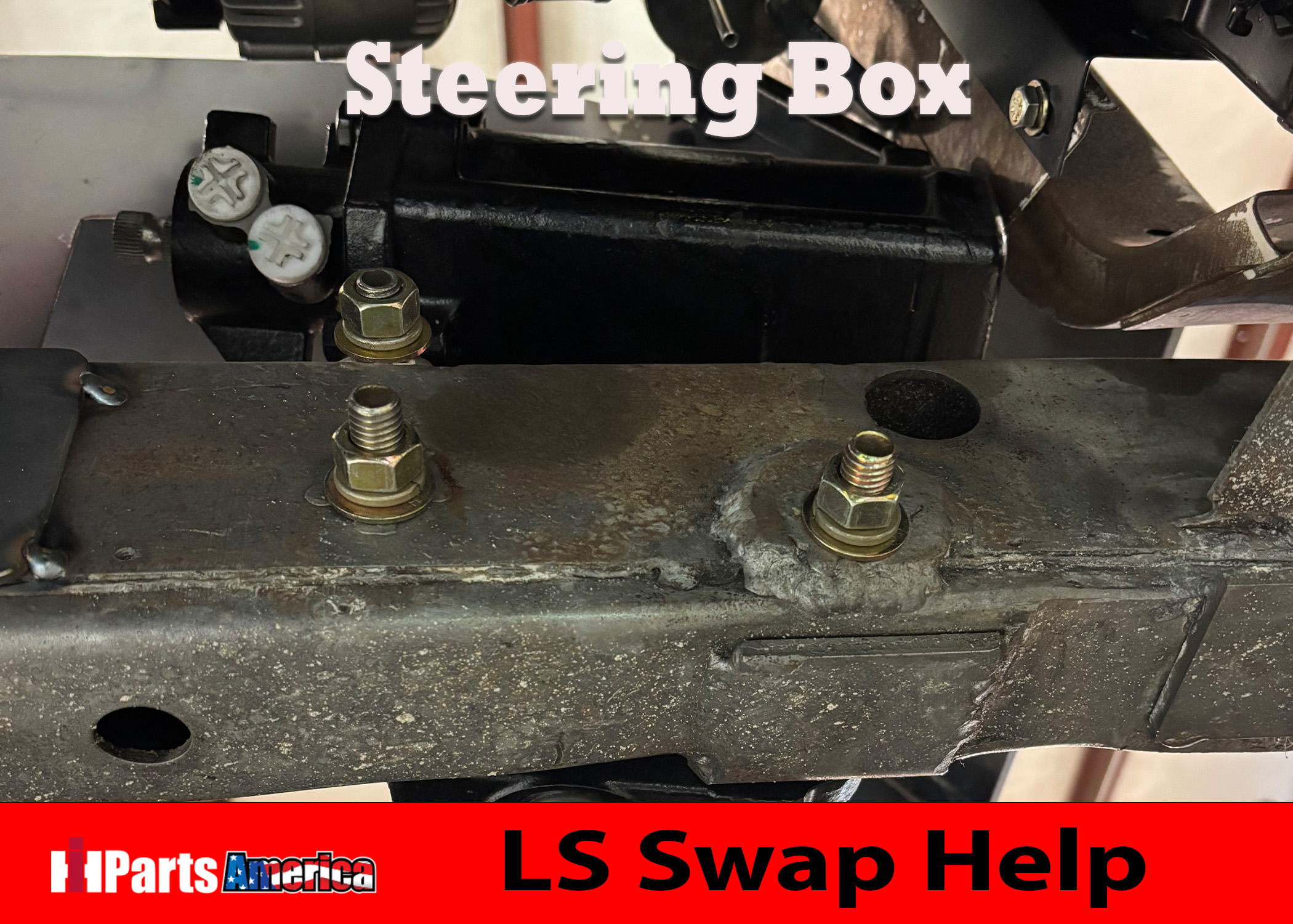

So, how exactly does the steering box mount to the frame? Well, welcome to the world of custom fabrication. There's no single answer here, as your particular build might require the box to be mounted in a slightly different location.
That being said, here's how we typically do it in our shop.
On factory V8 frames, we take advantage of an existing hole in the frame to get started. From there, we weld in a sleeve at the top of the frame, followed by another sleeve and washer at the bottom to complete the mounting arrangement.
If you're starting with a four cylinder frame, you've got a little more work ahead of you. Since those frames don't have the same mounting provisions, you'll need to locate and fabricate all three mounting holes from scratch.
Again, this is why we don't offer a universal kit that dictates exactly where everything needs to go. What works perfectly on one Scout might not be the best solution for another. Sometimes you've just got to break out the welder and make it work for your particular build.
It is not rocket science, a slight angle to the steering box is nicer on the steering joints up above. Inner-fender cutting or a complete inside panel may need to be made depending on other mods covered later.

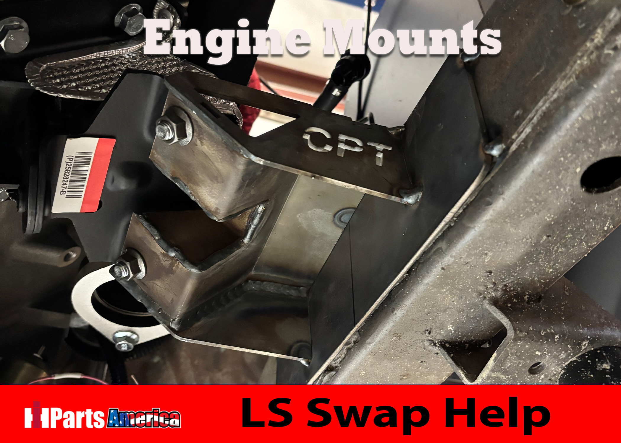

Since we're already working right next to the engine mounts, this is a good time to talk about what we use here at IH Parts America. This applies to the popular GM 4.8L, 5.3L, 6.0L, and 6.2L LS based engines.
For years, we used the same generic, off the shelf engine mount kits that just about everyone else was using. They worked, but we were never completely happy with them.
Most of these kits use a leaf spring style bushing for the engine mount. While there's no question that this design is strong, strength wasn't our complaint. The problem was vibration. Those bushings did very little to isolate engine vibration from the frame, and you could certainly feel it inside the Scout.
And let's face it, nobody wants to spend all that time and money building their dream Scout only to have it rattle their teeth out at a stoplight.
Rather than continue selling something we weren't entirely satisfied with, we decided to design our own mounting brackets around a factory GM engine mount.
The mount we chose is GM Part Number 25828247, commonly used in larger GM trucks and SUVs. There's a reason we went this route. These mounts were designed by GM for heavier vehicle applications, provide much better vibration isolation, and are readily available from parts suppliers across the country.
That last part is important to us. If you ever need to replace an engine mount years down the road, you shouldn't have to hunt down some oddball specialty bushing or rely on a custom part that might not be available anymore.
Sometimes the best solution isn't reinventing everything. It's taking a proven factory component and designing a better way to use it.
If interested - customers can purchase these for themselves by clicking this sentence.

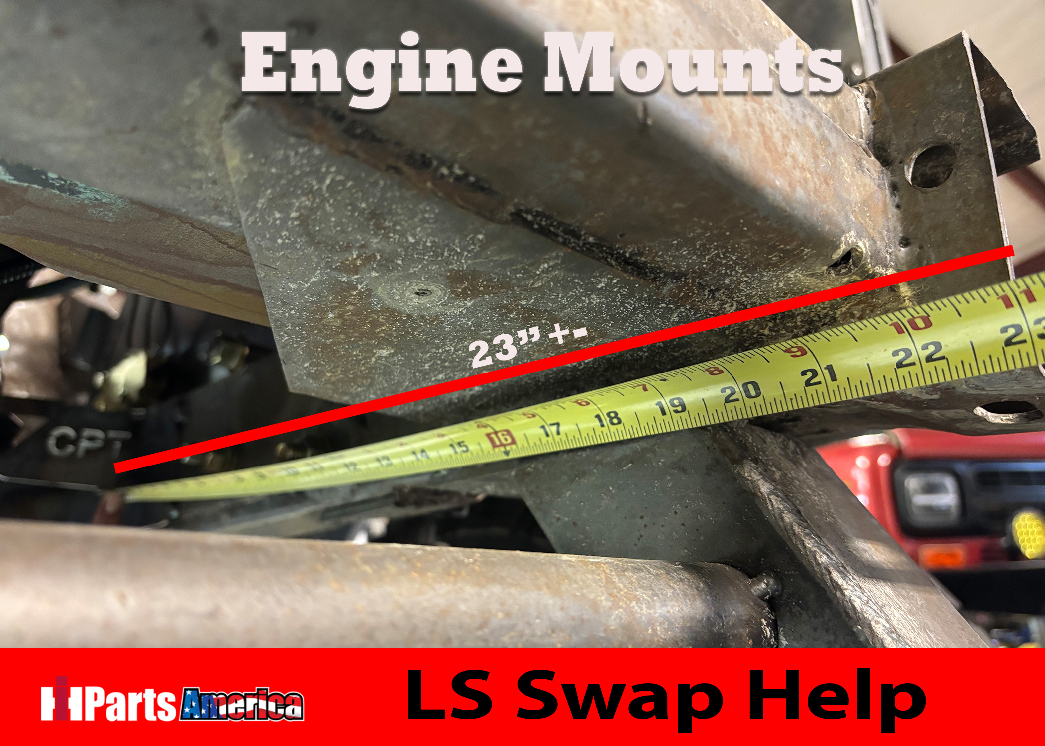

One of the most common questions we get is, "Where exactly do I weld my engine mounts?"
Well, if you've made it this far into the article, you should probably be starting to understand why there isn't one simple answer to that question. There are just too many variables from one Scout to the next.

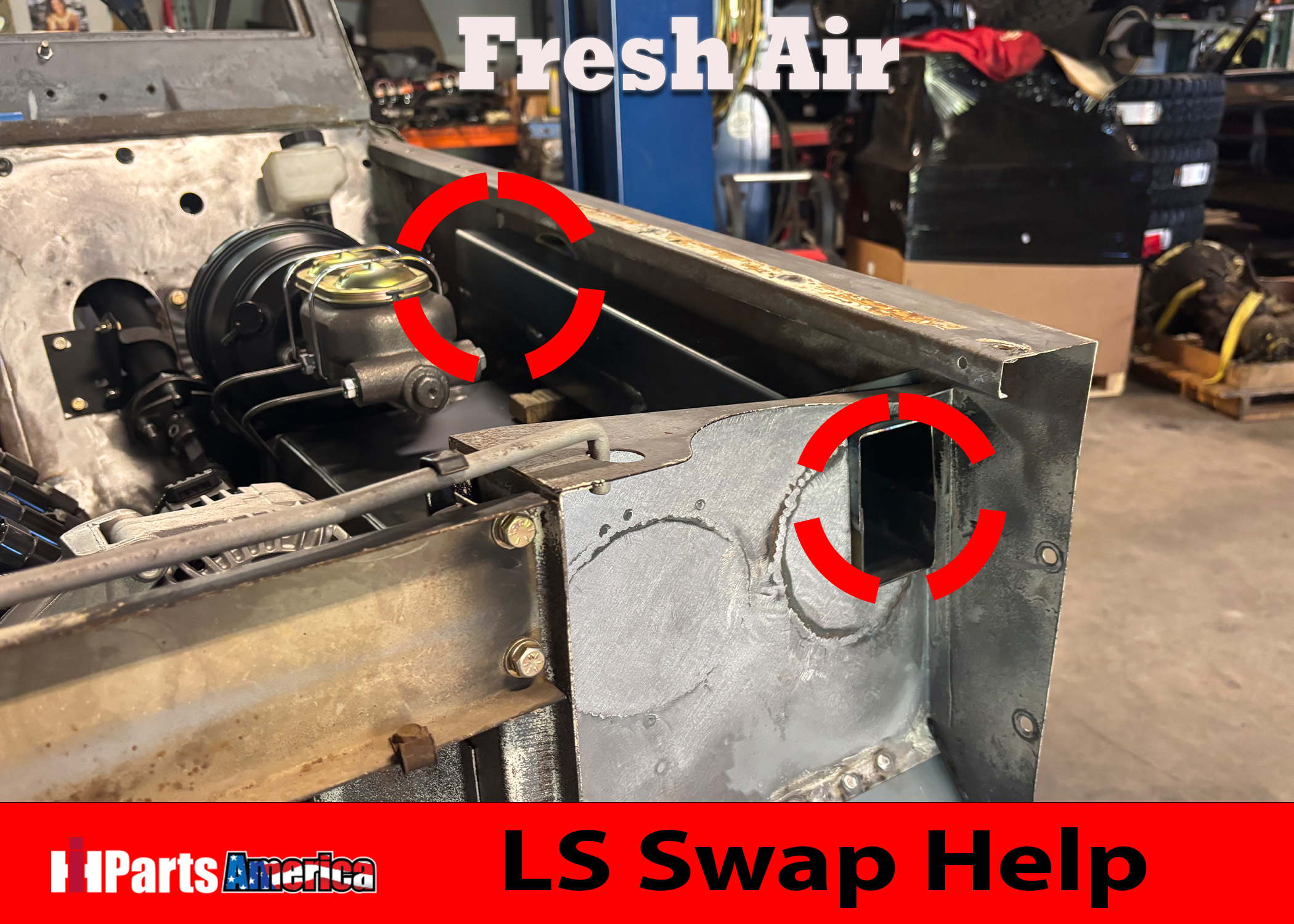

For example, on this particular Scout 800, we made modifications to the firewall to accommodate our engine placement. Does that mean you need to do the same thing? Absolutely not. But it does mean that where we positioned our engine mounts might not be where you'll want yours.

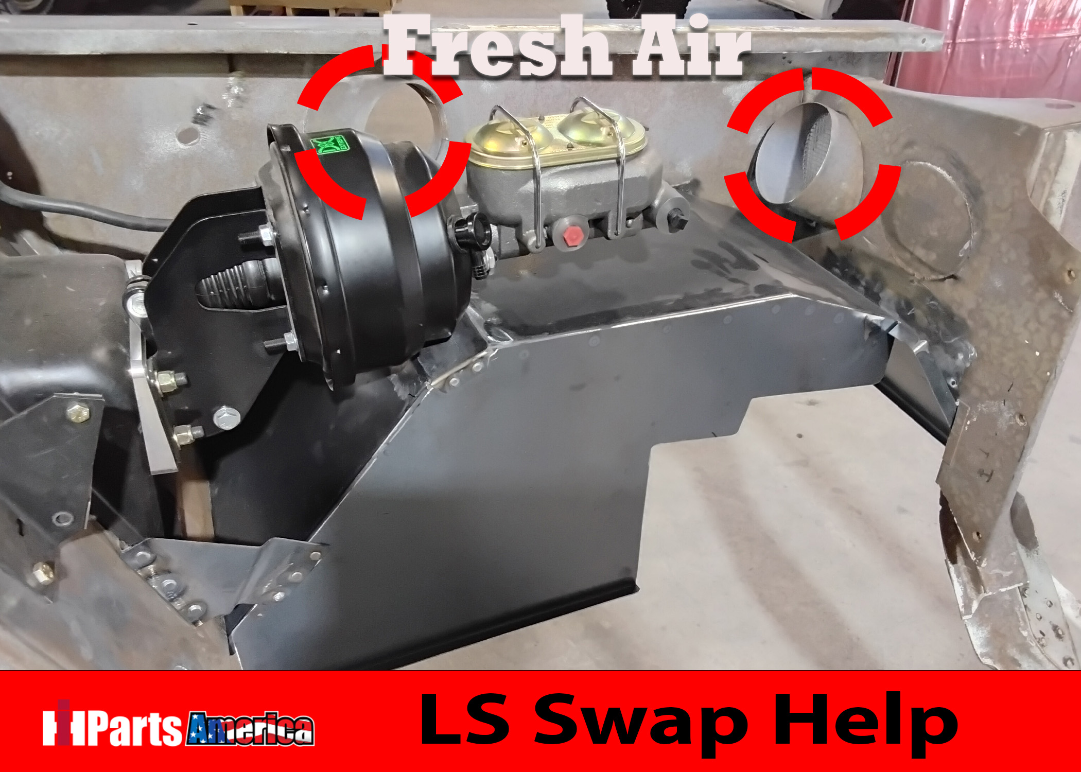

You also need to think about what engine you're running and how you plan on cooling it. Whether you're installing a 5.3L or 6.0L, running a mechanical fan means you'll need to leave adequate clearance between the fan and radiator. If you're going with electric fans, you've got a little more flexibility, but that doesn't mean you should just throw the engine wherever it fits. 6.2 LSIII's don't have threads on the waterpumps for a fan, so just a lot of things to consider.
Regardless of which route you take, we generally recommend positioning the engine as far back as reasonably possible while maintaining proper clearance for everything else.
And this brings us right back to why we don't sell a complete LS swap kit. We could tell you exactly where to weld your mounts based on how we built one particular Scout, but that doesn't mean it's going to work for yours. We'd rather give you the right parts and let you position everything to suit your build instead of forcing you to work around ours.
On this build, we have a single 19" brushless fan - we came up with around 23" from the tip of the frame to the front side of the CPT engine mount. This gave us plenty of clearance.

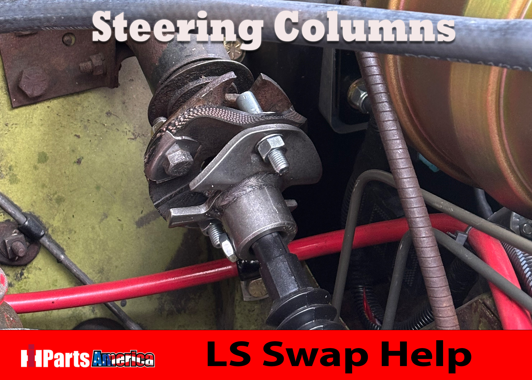

Before we get too far away from steering, there's one more thing worth talking about: the steering column.
What should you use? Well, if you're trying to keep the interior of your Scout looking as original as possible, our preferred choice is a 1969 to 1971 Scout 800A or 800B short steering column.
Take a look at the picture for reference. The easiest way to identify one of these short columns is to look just past the firewall. If you see a rag joint coupler connecting the column to the steering shaft, you've got the short version.
Having the short steering column makes life a whole lot easier, especially when it comes time to connect everything to your new steering box.
We actually offer a kit specifically for this setup, so you don't have to spend hours figuring out which steering components will work together. Our setup uses a 24 inch DD telescoping steering shaft, a 3/4 inch DD rag joint flange, and a 3/4 inch 36 spline to 1 inch DD steering joint at the steering box.
It's a fairly straightforward way to connect the original column to your new steering setup without having to reinvent the wheel.

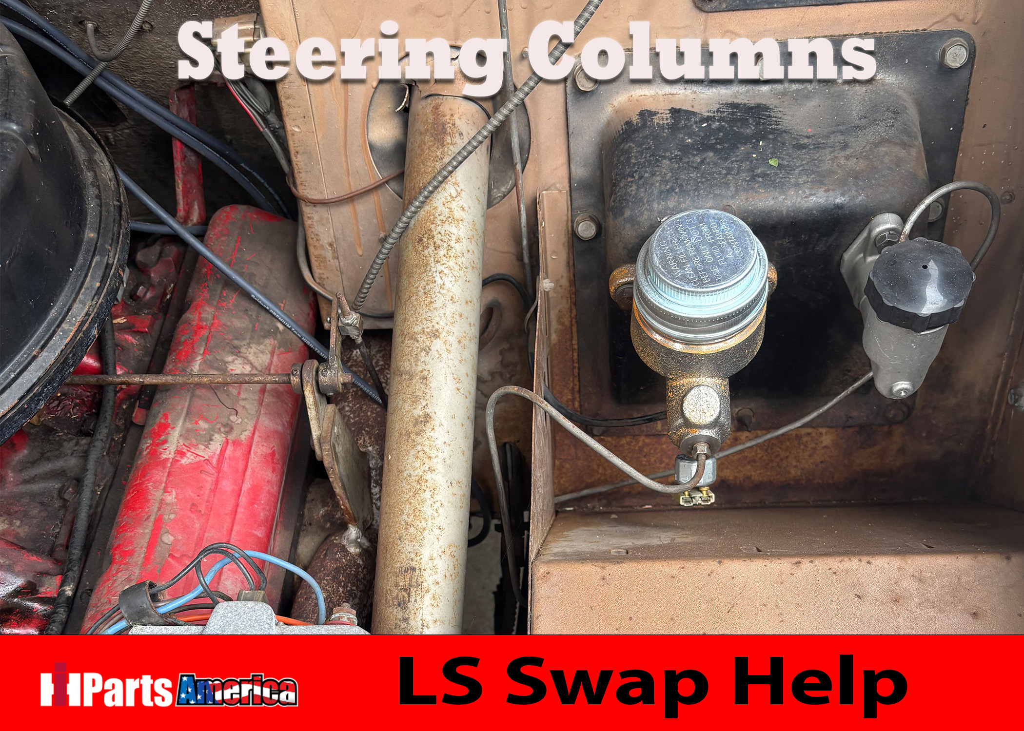

But what if your Scout doesn't have the short column? Well, that's where things get a little more interesting.
Earlier Scouts, particularly those built before 1968, came with a long, one piece steering column. Unlike the later short columns, these don't have that convenient rag joint connection just outside the firewall.
Take a look at the picture below and you'll see exactly what we're talking about. This is the long column, and if your Scout has one, you'll need to approach the steering conversion a little differently.
As you can see, the steering column is one continuous length to the steering box. Don't loose hope, there is a way to turn this into a short shaft.

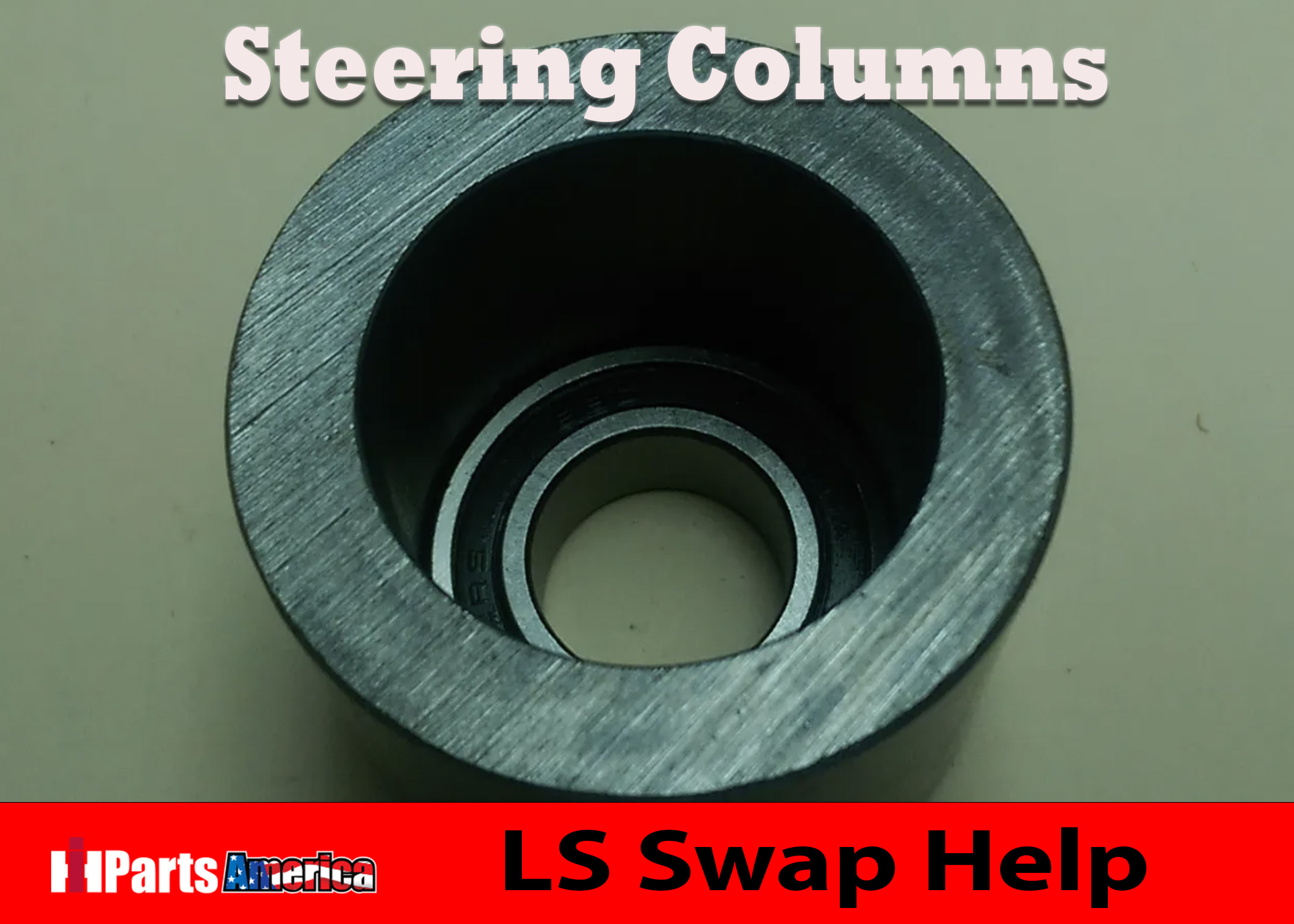

We have a bearing kit to cut down these columns: Part Number: DNC-S80-800-SCAB
If you're working with one of these early long steering columns, don't worry, you don't necessarily have to throw it away and hunt down a later short column.
When you shorten the original column, you'll need a way to attach a steering joint to the end of the shaft. Fortunately, Borgeson makes a weld on joint that works well for this application.
Borgeson Part Number: BORG-014968
1 inch Smooth Bore x 3/4 inch DD Joint
This joint allows you to adapt your original steering column to work with the same steering shaft and components we mentioned earlier.
It's a good way to keep your original column while making it compatible with a modern steering setup. Just keep in mind that you're modifying a critical steering component, so proper fitment and welding are extremely important. This isn't an area where you want to cut corners.

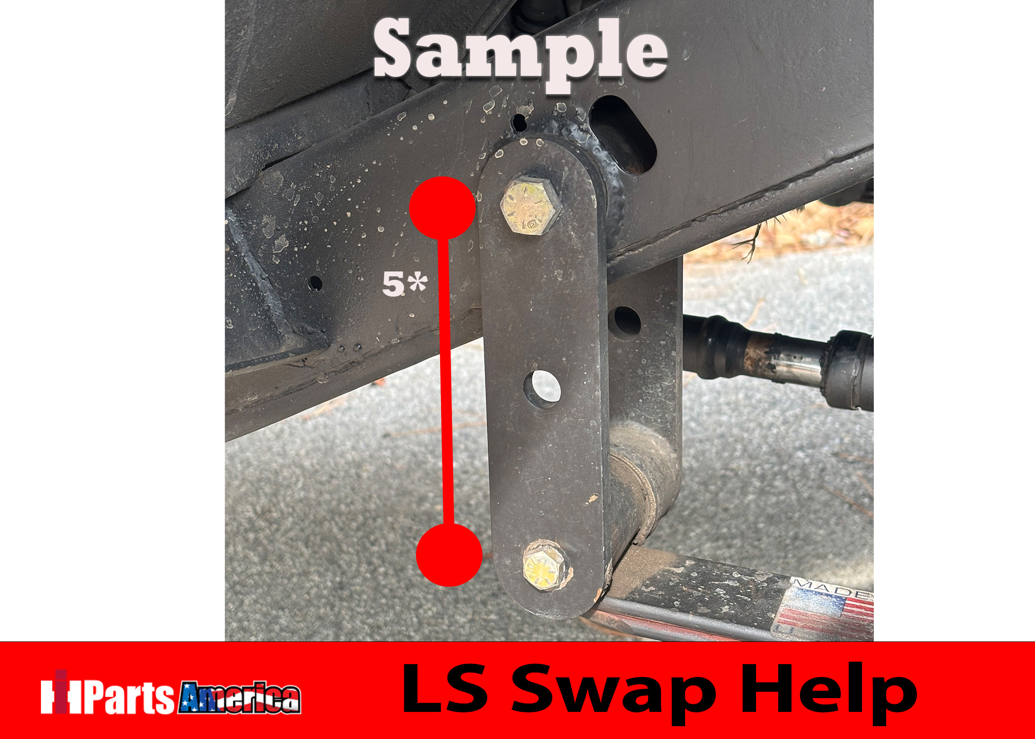

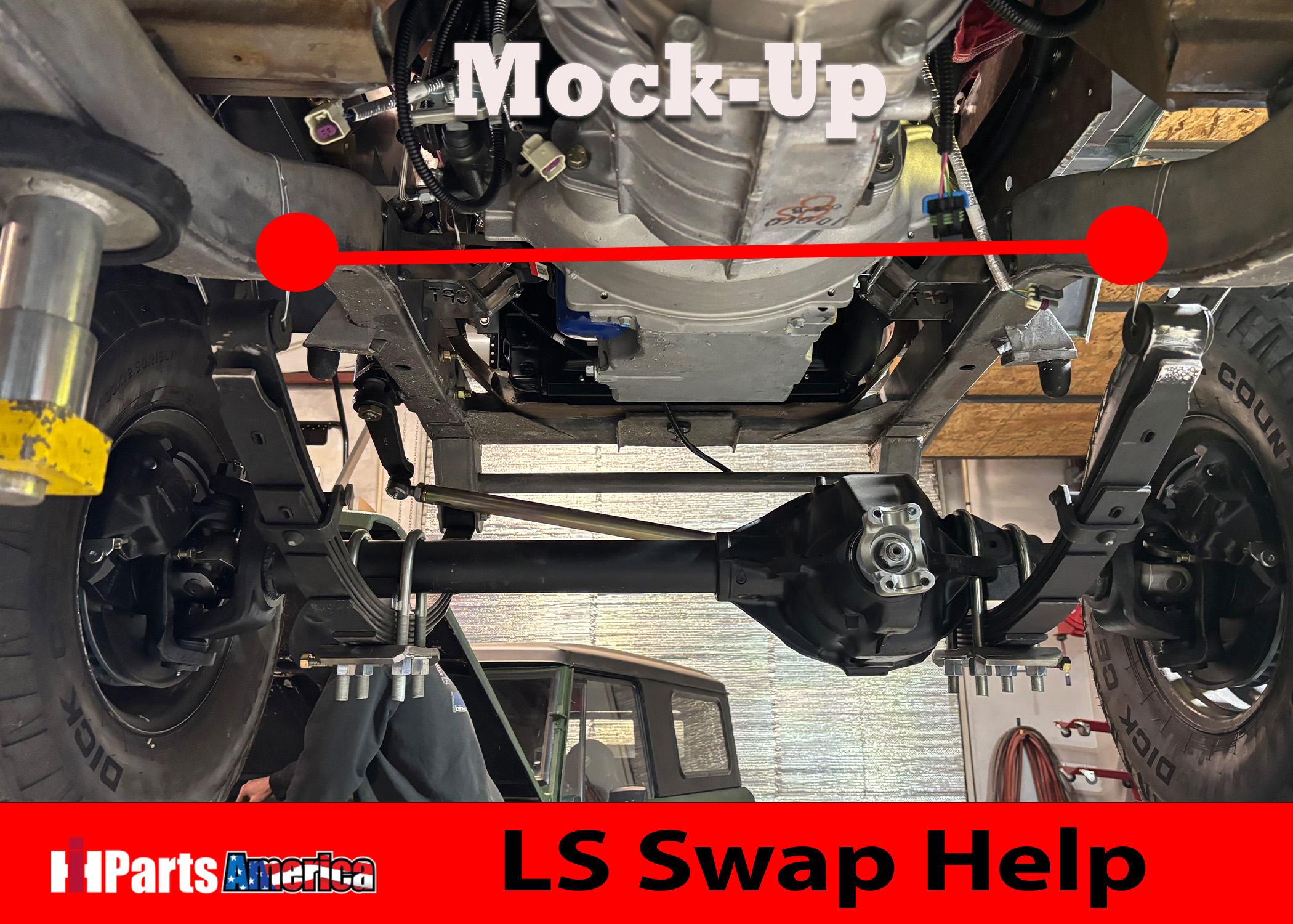

We prefer to wait until the entire Scout is mocked up, with all the weight of the drivetrain, body, and other components in place, before making our final suspension mounting decisions. This is especially important when it comes to drilling the frame and installing the sleeves for our CPT Reverse Shackle Kit.
The goal is to get the rear shackle angle correct with the Scout sitting at its actual finished weight. For now, we've simply used some baling wire to hold the leaf springs up and out of the way while we continue working on the rest of the build.
Here's something a lot of people don't realize. There isn't some magical measurement in a textbook that tells you exactly where to cut and sleeve the frame for every Scout. Something as simple as adding another 100 pounds to the front end can change how the springs sit, which in turn changes where that shackle needs to be positioned.
This is why we don't rush into permanently welding everything together. It's a whole lot easier to make adjustments during mockup than it is to cut apart something you thought was finished.
Measure twice, weld once. Or in our case, mock everything up before you even think about burning it all in.
Here's a good example using a Scout II to show what we're trying to accomplish. Once the full weight of the vehicle is sitting on the suspension, we like to see approximately 5 degrees of shackle angle.
Now, where you actually drill and sleeve the frame is another decision you'll need to make based on your particular build. There's some flexibility here depending on how you want the Scout to sit.
The lower you position the sleeve in the frame, the more lift you'll achieve. Move that sleeve higher up, and you'll end up with less lift.
Sounds simple enough, right? Well, just remember that changing the mounting location also affects your suspension geometry. This is why we keep stressing the importance of having the vehicle at its finished weight before committing to a final location. What looks perfect with an empty engine bay might be a completely different story once everything is installed. This also does affect your caster and pinion angle.
When doing reverse shackle in general, if you plan on wheeling it - you should consider a longer-slip driveshaft.

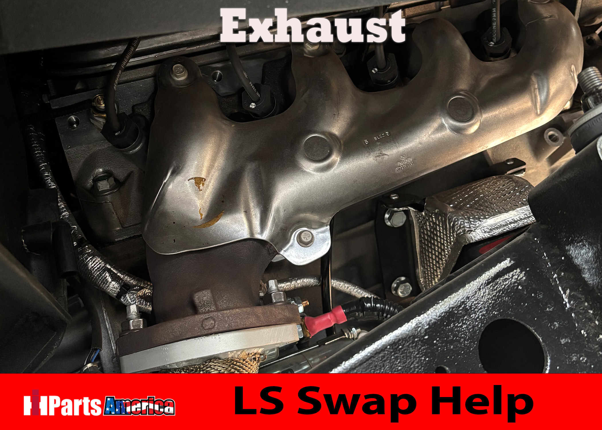

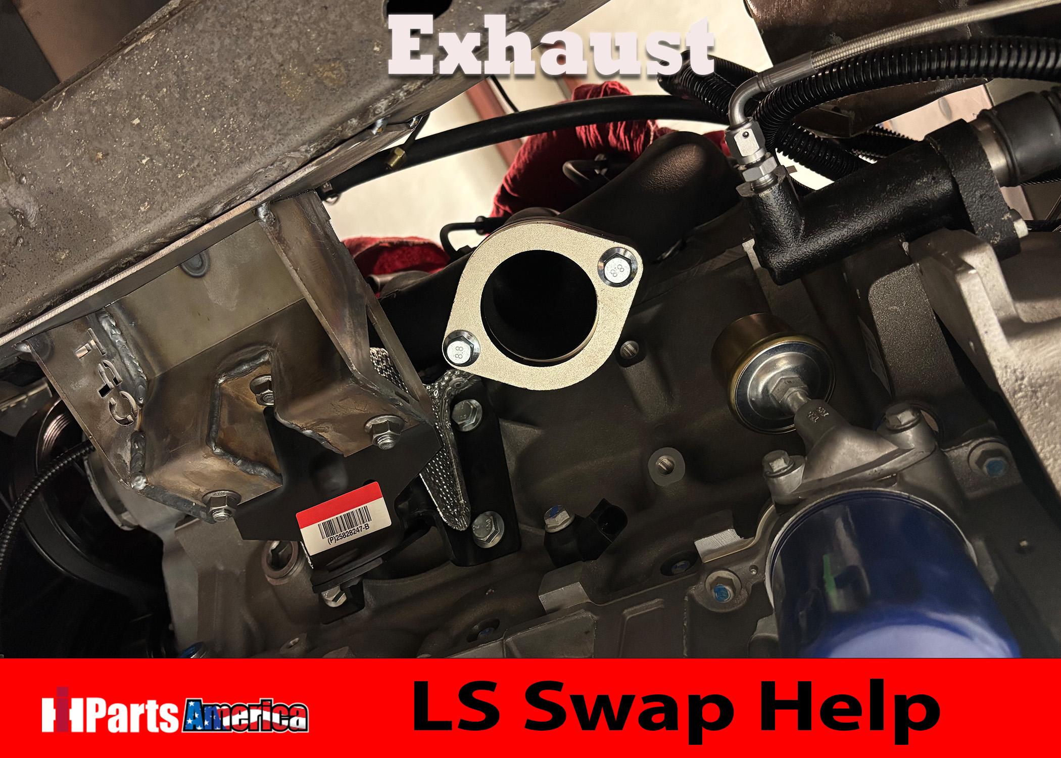

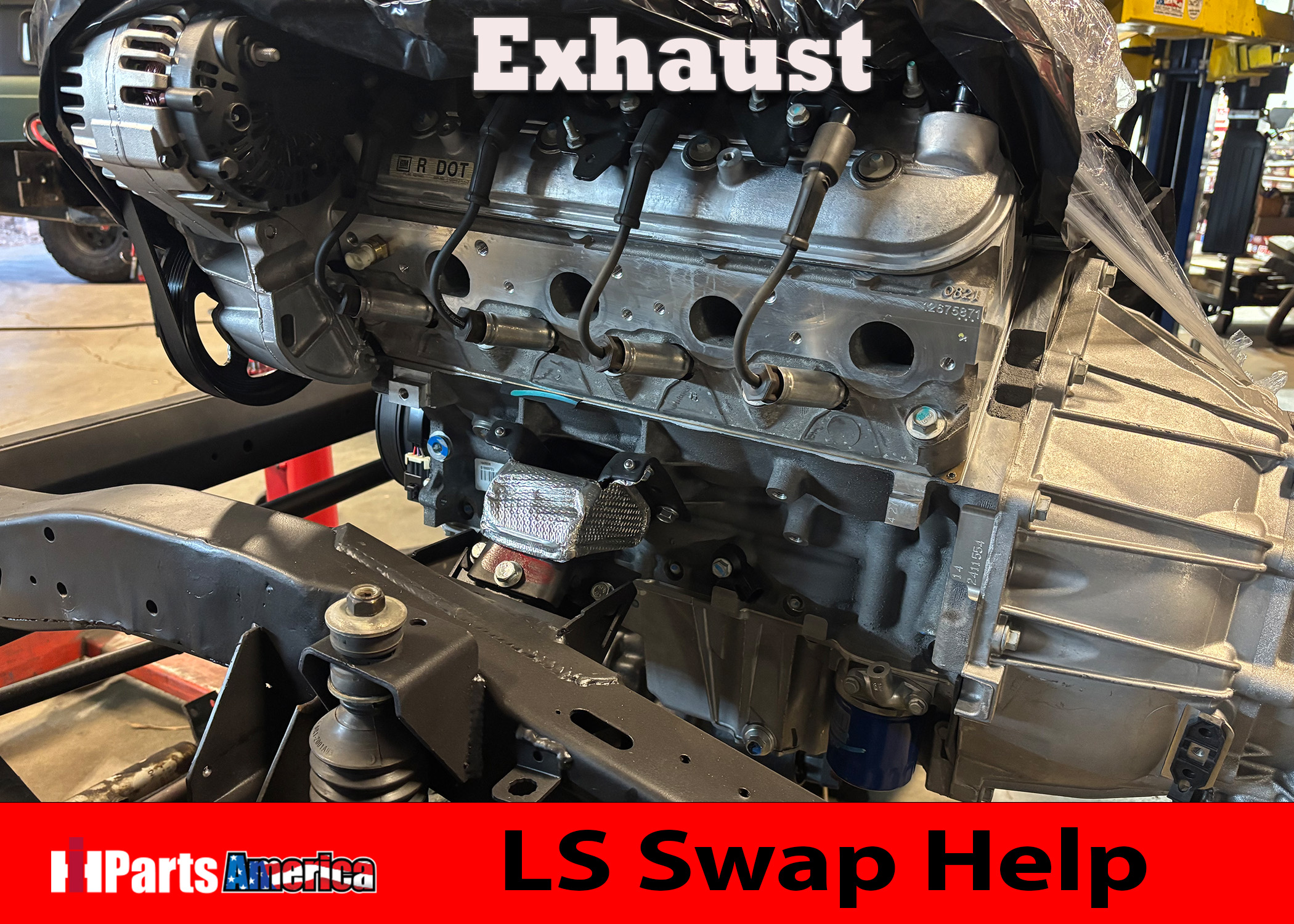

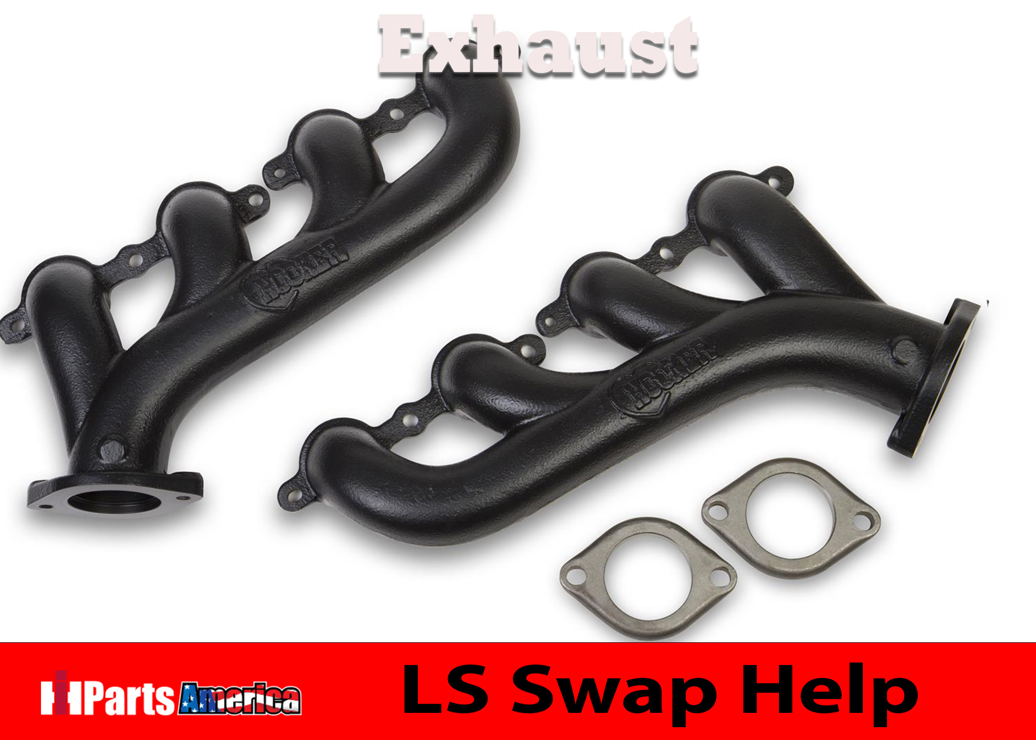

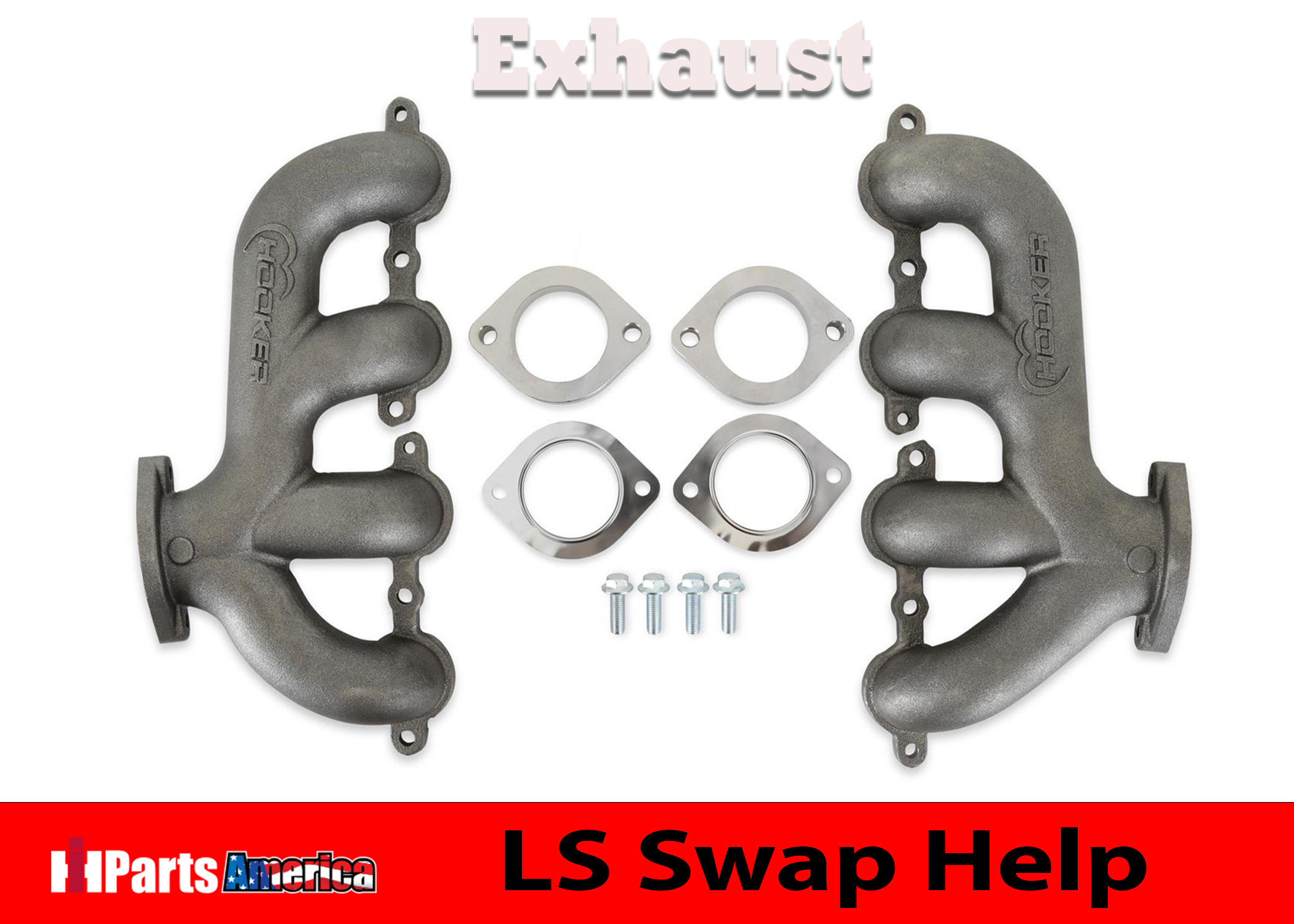

Now, let's move on to exhaust manifolds and headers.
First things first, we don't use headers here at IH Parts America. Why? Because quite frankly, we think they suck.
Sure, headers have their place, but when it comes to building a Scout that's actually going to be driven, we'd rather avoid the headaches that come with them. They tend to throw off more heat under the hood, can warp, develop leaks, and generally become another thing you have to mess with down the road.
We've found that a good quality, high flow cast exhaust manifold is a much better choice for the kind of builds we do. They're durable, typically seal better, and don't come with many of the problems we've experienced with aftermarket headers.
Are you going to squeeze every last bit of horsepower out of your LS with a factory style manifold? Probably not. But we're building Scouts to drive, not chasing dyno numbers.
Sometimes reliability and simplicity are worth a whole lot more than a few extra horsepower.
Over the years, we've narrowed things down to two exhaust manifold options that work really well for the builds we do here at IH Parts America.
When we're running an automatic transmission, we generally prefer a rear dump exhaust manifold. The problem with using the factory GM manifolds is that the exhaust outlet tends to end up right where the Scout's firewall is. Not exactly ideal when you're trying to route an exhaust system without cutting half the vehicle apart.
One option we've had great luck with is the Hooker HOK-8501-3HKR. This manifold works particularly well with the GM 6L80, 4L60, and other automatic transmission setups where there aren't any components interfering with the exhaust outlet.
Of course, this all comes back to how you've positioned your engine and what transmission you're running. Just because a manifold fits one LS swapped Scout doesn't mean it's automatically going to clear everything on yours. But for the right application, this Hooker manifold has been a solid choice for us.
Now, if you're building your Scout on a shoestring budget, there are situations where the factory GM exhaust manifolds can work. By positioning the engine farther forward and running electric cooling fans, you may be able to gain enough clearance to make them fit.
Would we recommend moving your entire engine forward just to save a few bucks on exhaust manifolds? Absolutely not. You're making a pretty big compromise in engine placement just to avoid buying a better fitting set of manifolds.
However, sometimes you don't have much of a choice.
Take the Scout pictured below, for example. This particular build received an LS3 E-ROD engine, or what I like to call the California Communist Transplant Special. Thanks to California's wonderful emissions requirements, we were forced to retain the original, unmodified exhaust manifolds as part of the approved engine package.
In this case, moving the engine forward wasn't about saving money. It was about making everything fit while keeping the emissions equipment compliant.

Now back to the Scout 800.

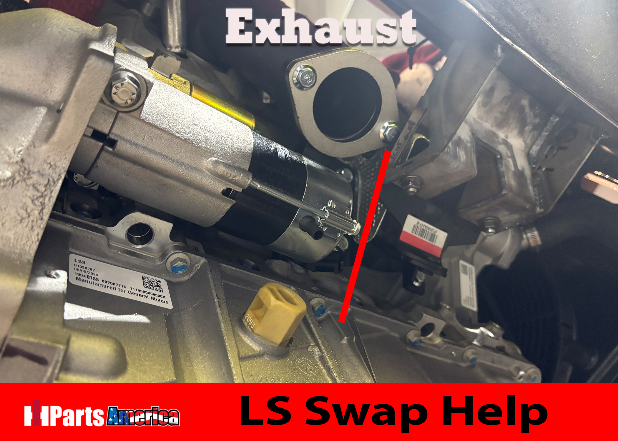

Now, if you're planning on running a manual transmission behind your LS, things change a little.
Unlike the automatic setups we just covered, a rear dump exhaust manifold generally isn't going to work. In most cases, the exhaust outlet ends up fighting for the same space as the clutch slave cylinder. And as you can imagine, having a hot exhaust manifold right up against your clutch hydraulics isn't exactly a great idea.
Even with our CPT engine mounts, clearance in this area is extremely tight. We can make it work with a slight modification, which we'll show you a little later in the article.
For these manual transmission builds, we've had much better luck with the Hooker Mid Dump exhaust manifolds, Part Number HOK-8505HKR.
By moving the exhaust outlet away from the rear of the engine, these manifolds give us a better starting point for routing the exhaust around the clutch components.
Again, it's one of those little details that's easy to overlook when planning an LS swap. Your transmission choice doesn't just determine what goes behind the engine. It can also dictate what parts you're able to use alongside it.
Here's what the Hooker Mid Dump manifolds look like installed in a Scout. As you can see, the difference in clearance is pretty significant. Moving the exhaust outlet away from the rear of the engine gives you much more room to work with, especially around the clutch components. It's a simple change that can save you a whole lot of headaches when it comes time to route your exhaust.
One thing to keep in mind with a V8 engine is that the cylinder banks are offset from one another. This means the exhaust manifolds don't sit in exactly the same position on each side of the engine.
As we mentioned earlier, this creates a bit of a clearance issue on the passenger side when using our CPT engine mounts. Take a look at the picture below and you'll see exactly where things get tight. Fortunately, it's nothing a small modification can't take care of, which we'll get into next.
Fortunately, the fix is pretty simple. All you need to do is slightly notch or bend the small strip on the engine mount to give yourself enough room to get a socket and extension past it. Nothing major, just a little extra clearance to make getting to the bolt a whole lot easier.

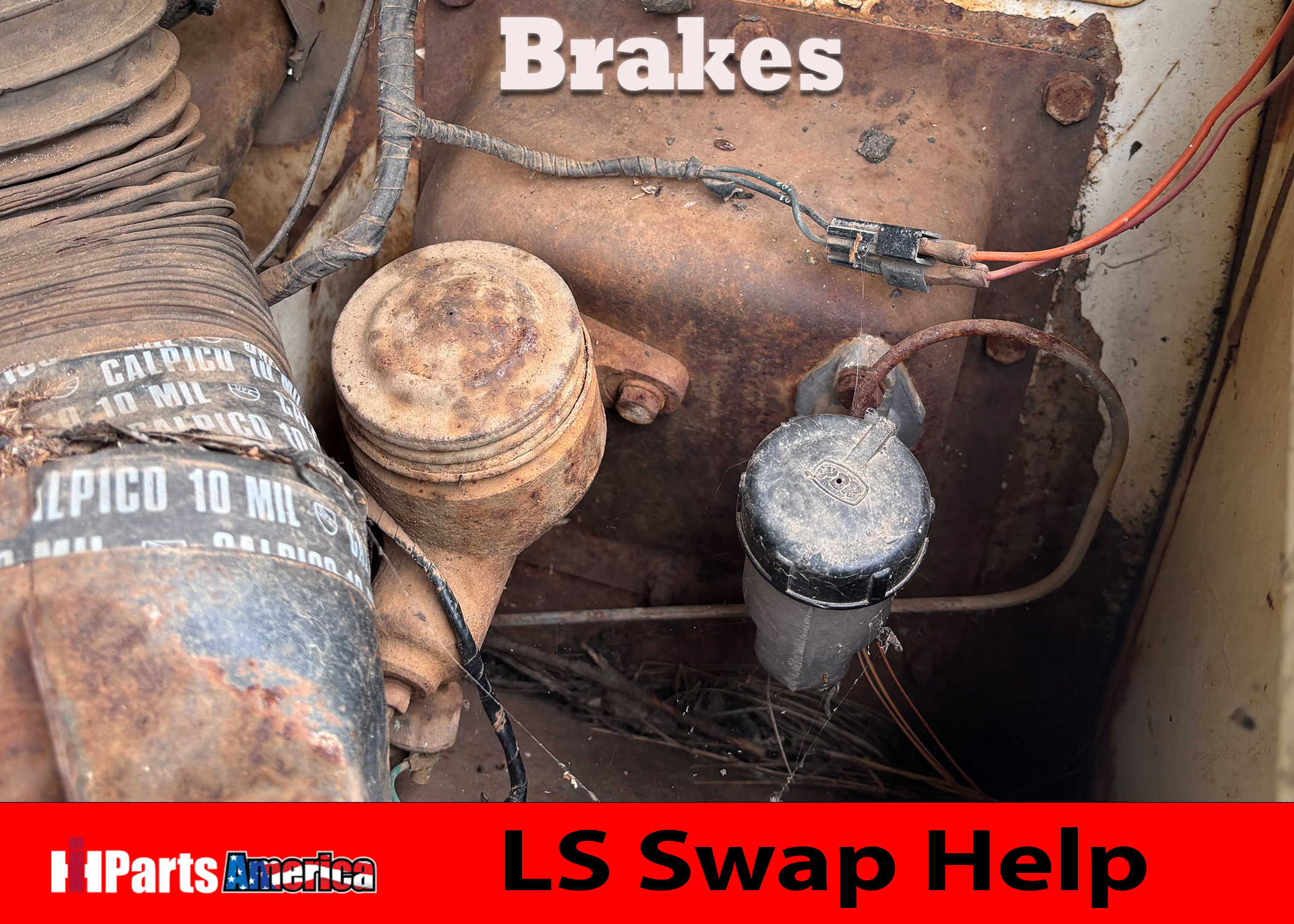

Since we're still talking about the Scout 80 and 800, let's address another part of the original setup that really has no business being overlooked when adding 300 to 400 horsepower: the factory braking system.
These early Scouts were never designed with that kind of performance in mind, and the original master cylinder and manual drum brake setup leave a lot to be desired by today's standards.
Think about it for a second. You've just stuffed a 350 horsepower LS engine under the hood of a Scout that originally had less than 100 horsepower. Now imagine trying to control all that power with the original manual steering and manual brakes.
Sounds like a good way to turn an exciting test drive into a terrifying one.
This is why we keep stressing that an LS swap is much more than just an engine conversion. Making your Scout go faster is the easy part. Making sure it steers and stops properly is just as important, if not more.

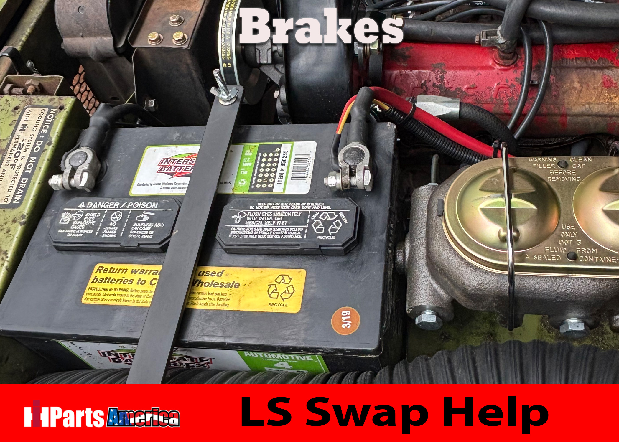

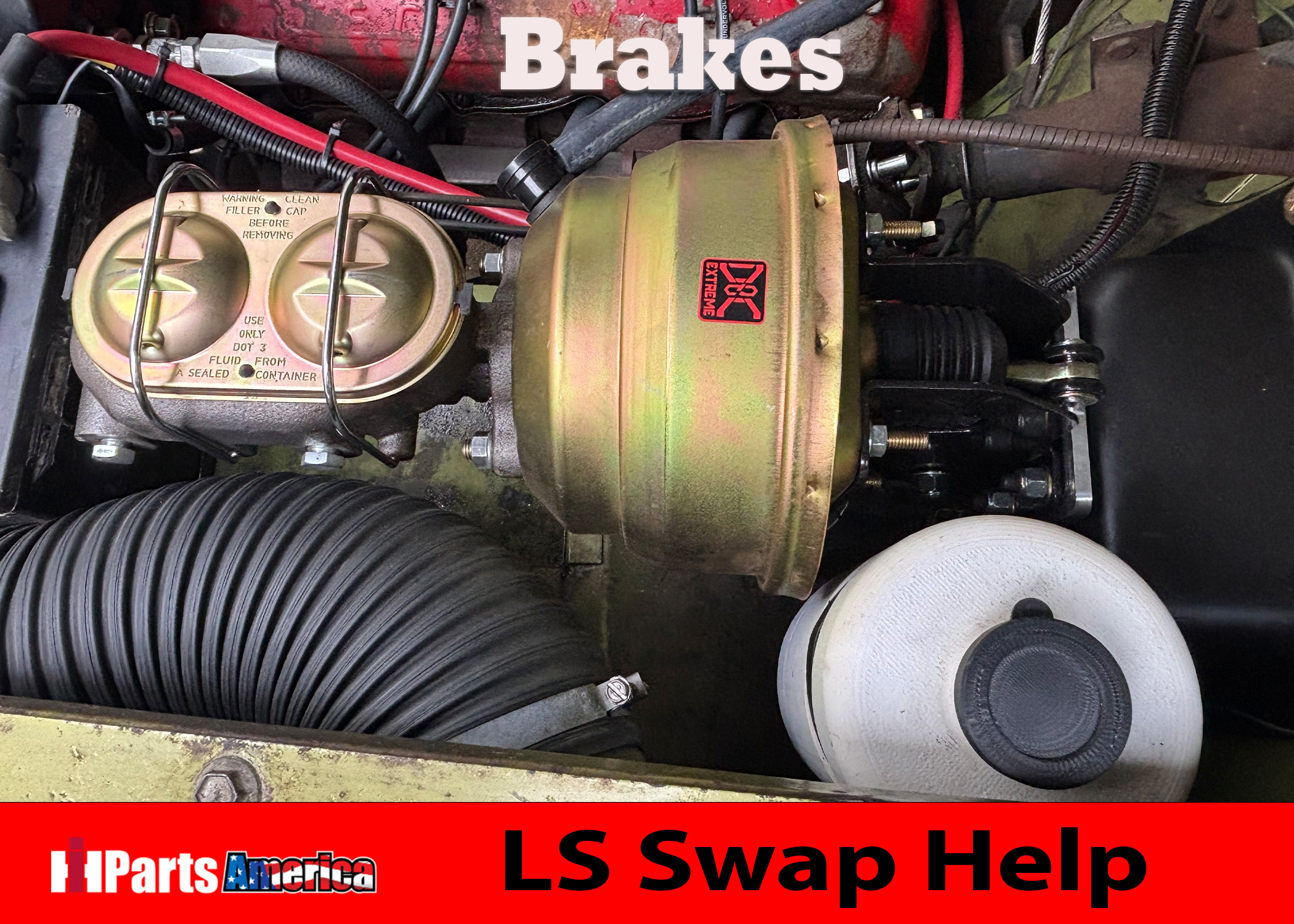

Up until 1967, Scouts were equipped with a single circuit brake master cylinder. What does that mean? Well, if you develop a significant brake fluid leak anywhere in the system, you can lose all hydraulic braking pressure. Not exactly something you want to experience while driving down the road, especially with a few hundred horsepower under the hood.
Starting in 1967, federal safety requirements brought dual circuit master cylinders into the picture, separating the braking system into two circuits. If one circuit fails, the other can still provide some braking ability.
A pretty important improvement, wouldn't you say?
While the later dual circuit setup was certainly a step in the right direction, it still doesn't mean the original braking system is what we'd recommend for a modern LS powered Scout.

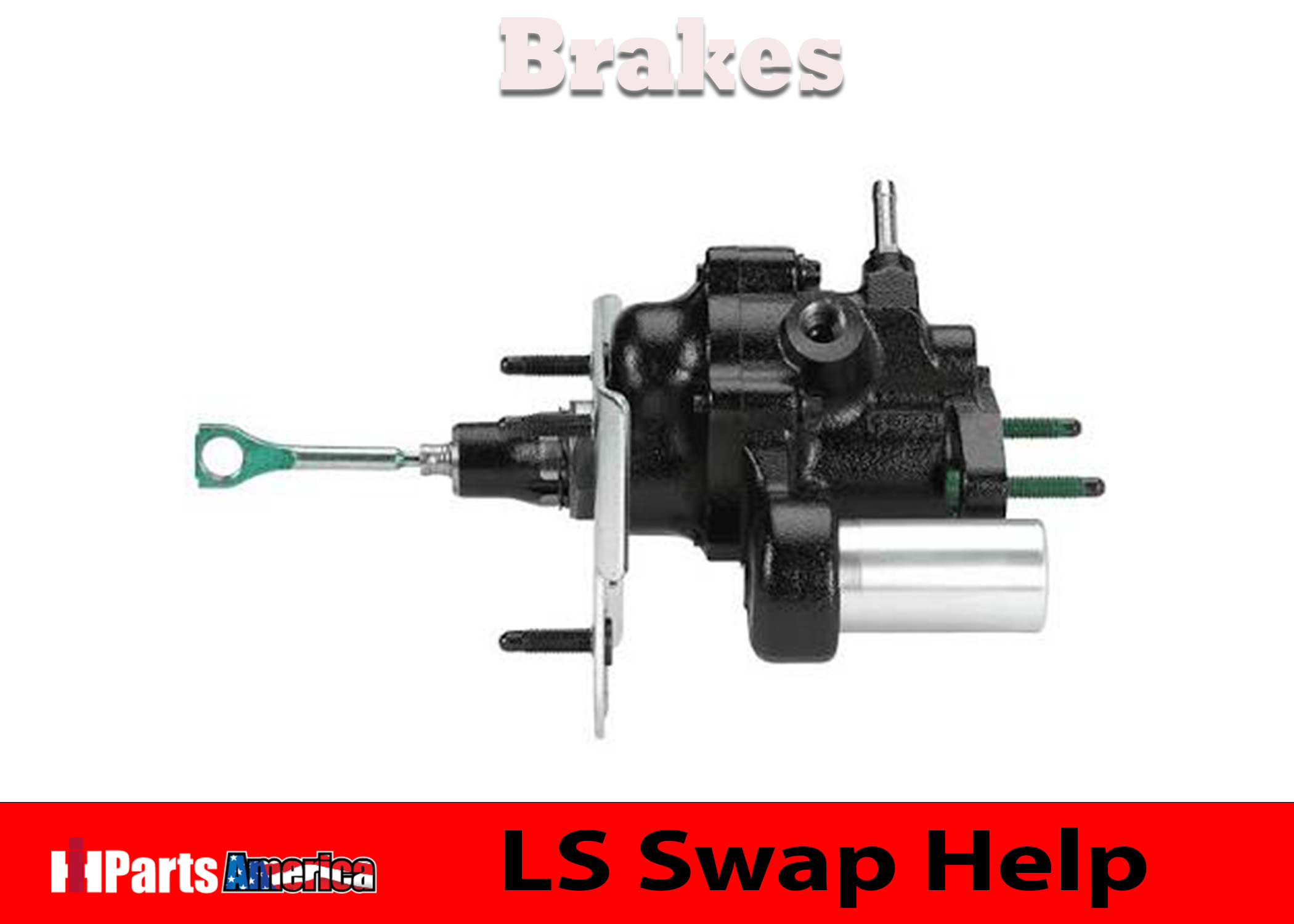

One of the more popular upgrades we offer is the D&C Extreme Power Brake Booster Kit with Master Cylinder.
IH Parts America Part Number: DNC-S80-800-BRK-BOOSTR
Since most naturally aspirated LS engines produce plenty of vacuum, a traditional vacuum assisted brake booster is a great option. It's one of the easiest ways to add power brakes to an early Scout without making the conversion more complicated than it needs to be.
And the best part? You don't need an LS engine to take advantage of this upgrade. Whether you're running the original IH engine or something with a whole lot more horsepower, adding power brakes is one of those improvements you'll appreciate every time you get behind the wheel.
But, like everything else - you need to work for this upgrade.
Well, if you're planning on LS swapping your Scout, you probably should have expected to relocate the battery at some point anyway. Just another part of that domino effect we've been talking about.
As you can see in the picture, things get pretty tight in this corner of the engine bay. The Scout shown here does have a somewhat odd sized battery, and a standard Group 24 would give you a little more breathing room. But even with a smaller battery, you're still working with very limited space.
This is just another one of those things you'll want to plan for before you start permanently mounting everything. It's a whole lot easier to relocate a battery during mockup than to find out later that your new brake booster and battery are fighting for the same real estate.
Now, if you're running into vacuum issues or simply want more braking assist, hydroboost is another popular option worth considering.
Unlike a traditional vacuum booster, hydroboost uses hydraulic pressure from your power steering system to assist with braking. It's a great option for builds where engine vacuum is limited or you just want a little more stopping power.
But don't expect it to be a simple bolt on affair. On these early Scouts, you'll most likely need to modify the firewall mounting plate to accommodate the hydroboost unit. You'll also need a whole slew of adapter fittings and hoses to get everything connected properly.

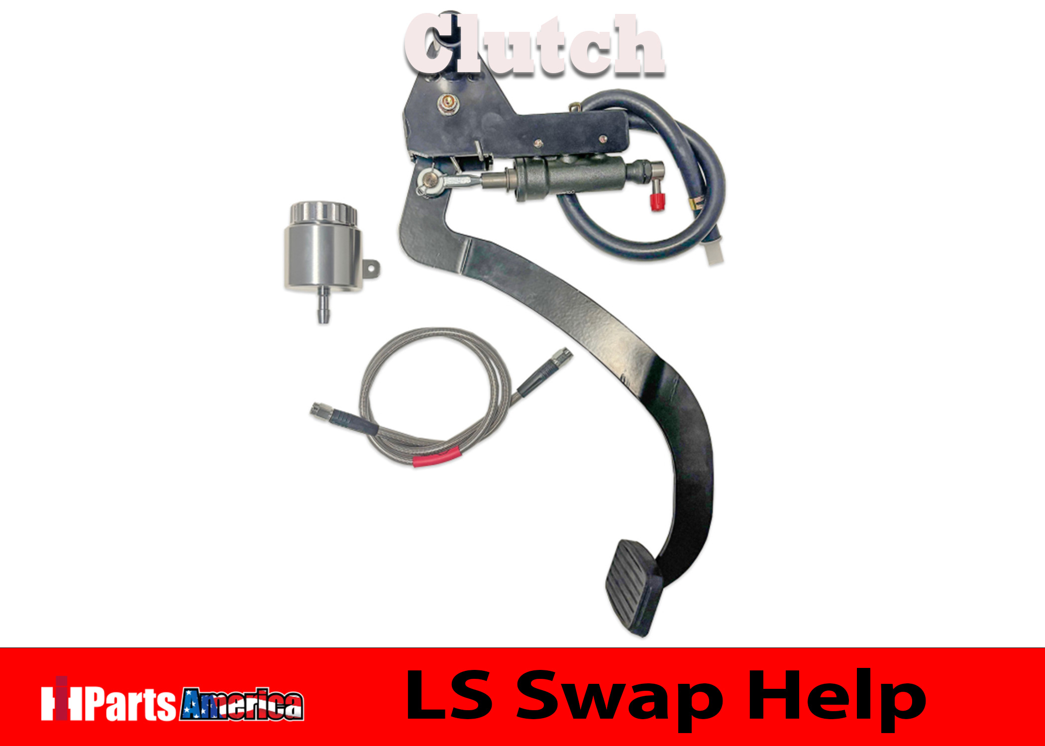

Now, if you're planning on running a manual transmission, here's another problem you're going to run into.
Whether you go with a vacuum brake booster or hydroboost, both setups take up a good amount of real estate on the firewall. Unfortunately, that's also right where you'd normally want to mount your clutch master cylinder.
And as you've probably figured out by now, space under the hood of an early Scout isn't exactly something you have an abundance of.
Fortunately, there's a way around this, and it's a setup we've had good luck with on our own builds.
This is an underdash hydraulic clutch master cylinder assembly designed for the 1961 to 1971 Scout 80 and 800.
Instead of trying to squeeze another master cylinder onto an already crowded firewall, this setup moves the clutch master cylinder underneath the dash, freeing up valuable space in the engine bay.
If you're planning on running a manual transmission like the AX15 or TR4050 behind your LS, this makes setting up the hydraulic clutch system a whole lot easier.
It's one of those upgrades that solves a problem before it becomes one. And considering how quickly space disappears under the hood of an early Scout, we'll take every extra inch we can get.

Here's another thing you probably didn't think about when planning your LS swap. Most of these brake and clutch upgrades end up taking over the same space occupied by the factory fresh air ducting.
Unfortunately, that means the original fresh air system usually ends up getting blocked off completely. Just another example of how changing one thing on these early Scouts tends to affect three or four other things along the way.
Over the years, we've gotten pretty creative with ways to work around this problem. On our most recent build, we fabricated a rectangular tube style fresh air duct that tucks much tighter against the inside of the fender.
Not only does this help retain the fresh air system, but it also cleans up the engine bay quite a bit. Instead of having bulky factory ducting fighting for space with everything else, we've got a much cleaner setup that looks like it actually belongs there.
It's little modifications like this that can make a big difference in the finished product, especially if you're trying to keep your engine bay looking clean and organized.
