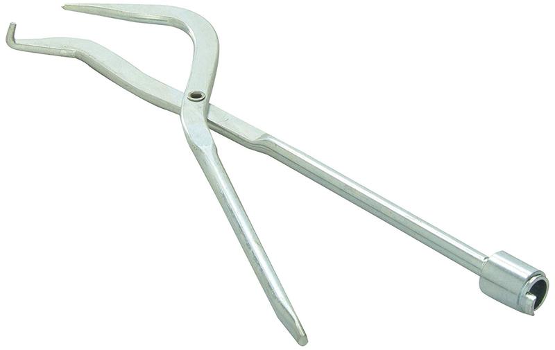

Drum brakes are not that hard to service just take your time and if you have a phone with a camera take plenty of pictures. Plan on replacing all the brake hardware (springs clips an possibly adjusters)
...and get one of these it will save much aggravation with the springs
