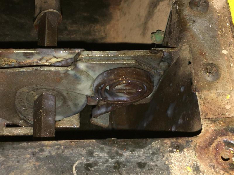

The tail gate latch return spring is the coiled one in the picture.

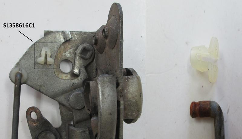

You will need the plastic retainers found on the store here. https://www.ihpartsamerica.com/store/SL358616C1.html
The website says these are for 1969-75 Truck/Travelall but they also work on 1972-80 Scout II's.

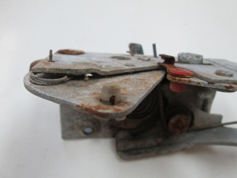

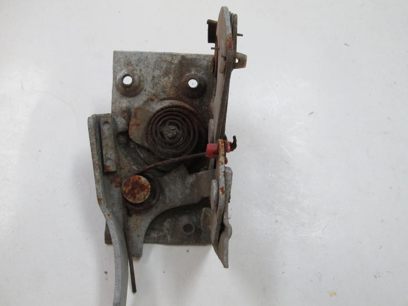

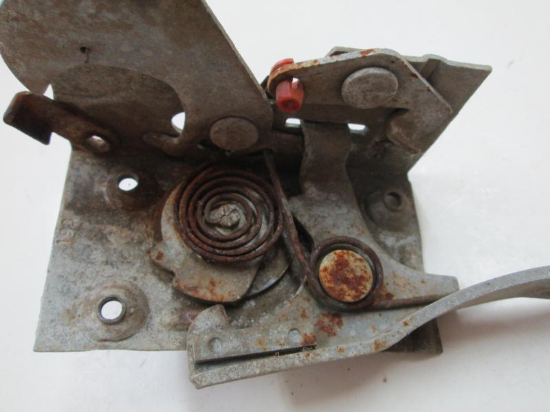

And here are some pictures of a SII door latch to compare to yours.
attachment.php
attachment.php
attachment.php

It sounds like you need to obtain some used SII door latches. The only springs you will find will either be NOS or a cross match to another car.
We do still have some new tailgate latches here on the store. https://www.ihpartsamerica.com/store/SL395909C1.html

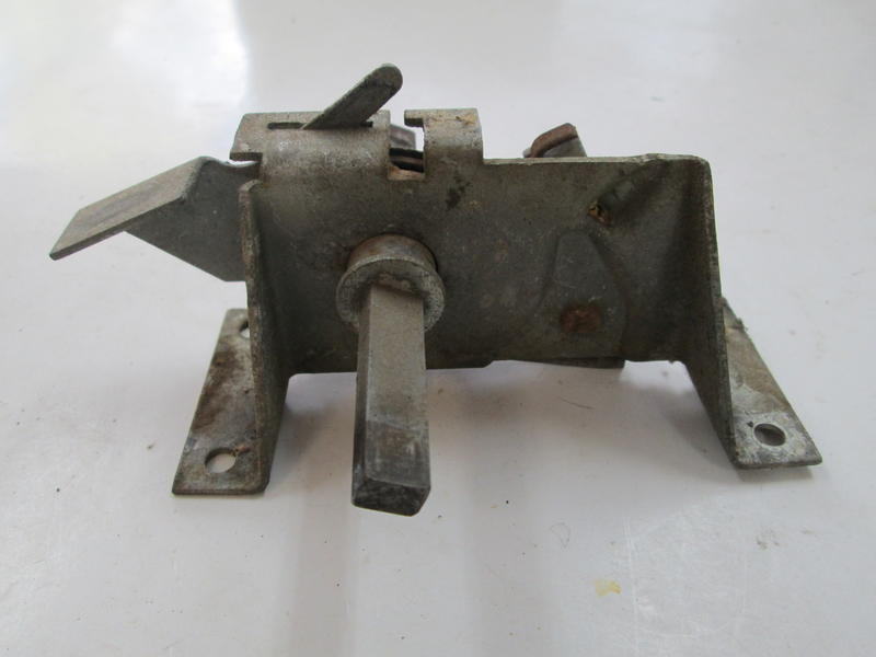

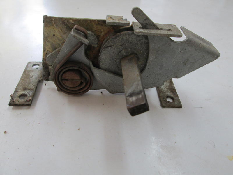

Here are some pictures of the tailgate latch.
attachment.php
attachment.php

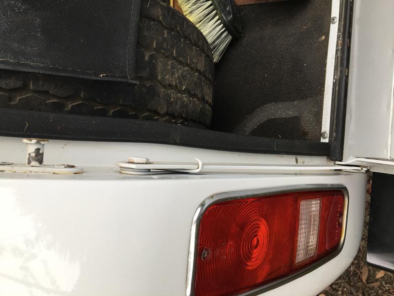

Might be this one. Only seen these on one Scout, my 72. Think it's to keep the lift gate strap from hinging the wrong way.
