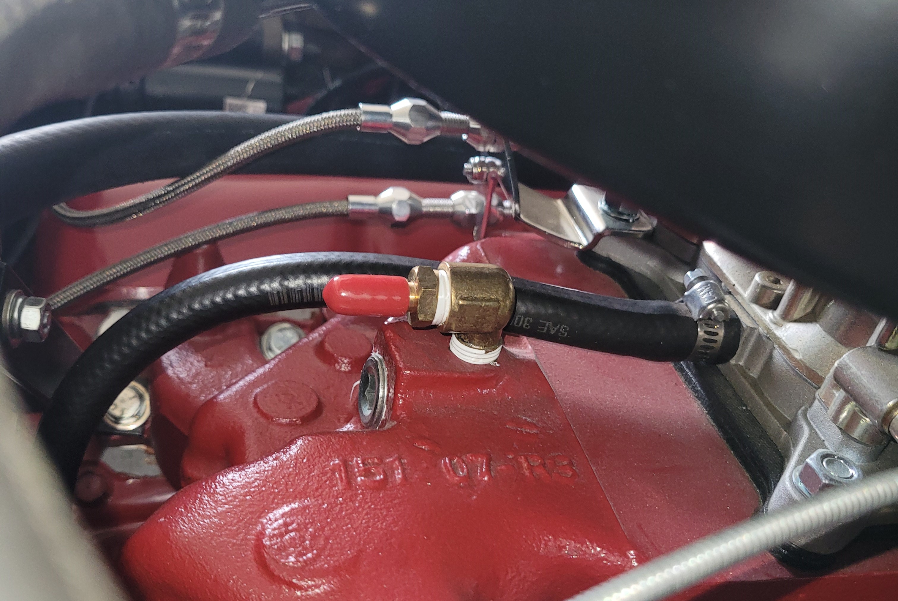

Zaedster, thanks for the reply. I use this fitting on the manifold for a vacuum reading when I'm tuning the carb. It would be okay to use this same fitting redused to a 1/4" for the charcoal canister?
Yes, reduced to a .050" or similar size before getting to the canister.
All hooked up and working. I shoved a Holley 122-50 jet in the 1/4" vapor hose as you advided. With the hose on the purge outlet on the charcoal canister its about one inch from the purge nipple. The other end of the hose is hooked up to a 90 deg 1/4" brass barb fitting on the manifold that I would use for a vacuum gauge when tunning the carb. Thanks again.
