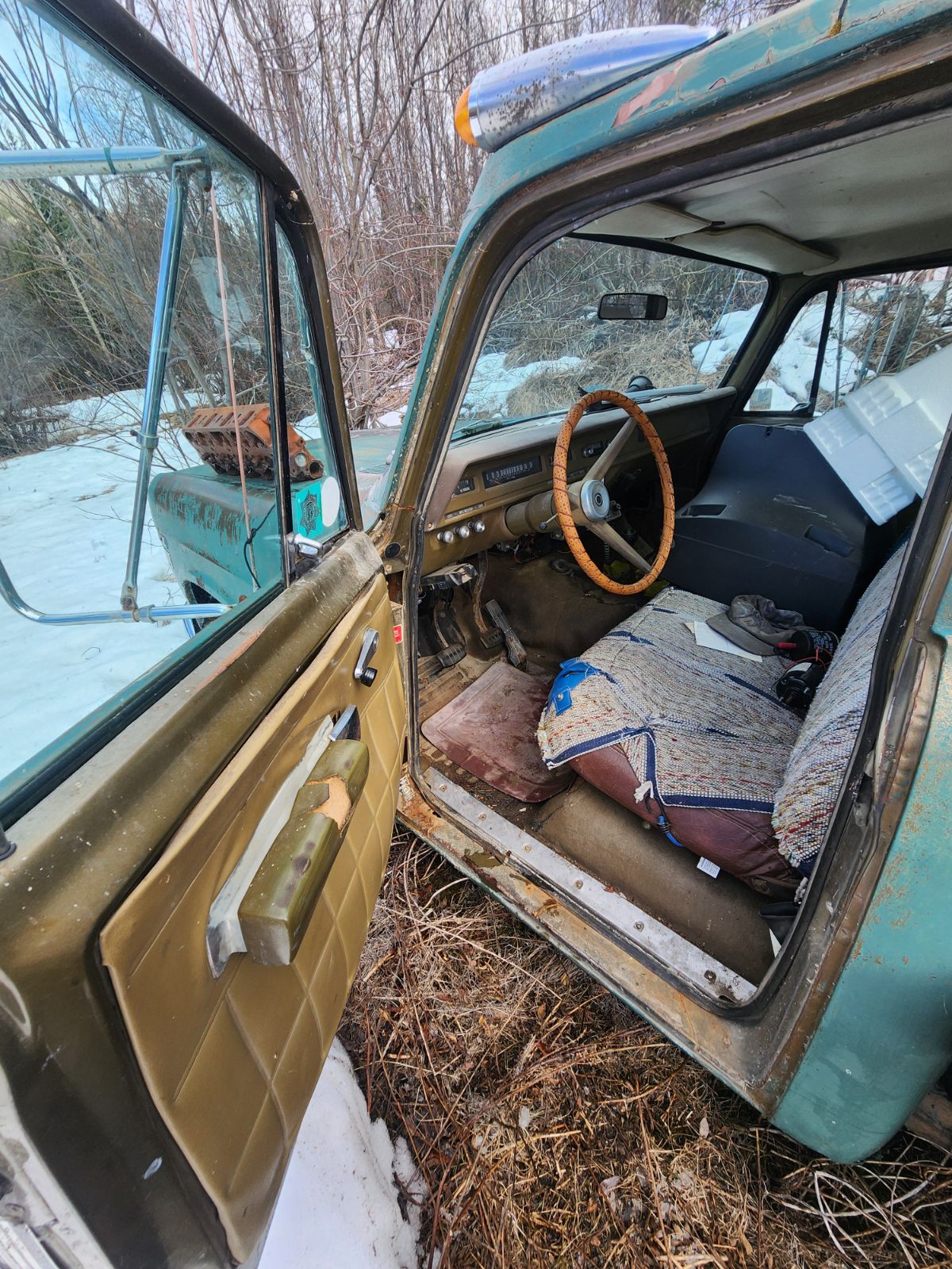

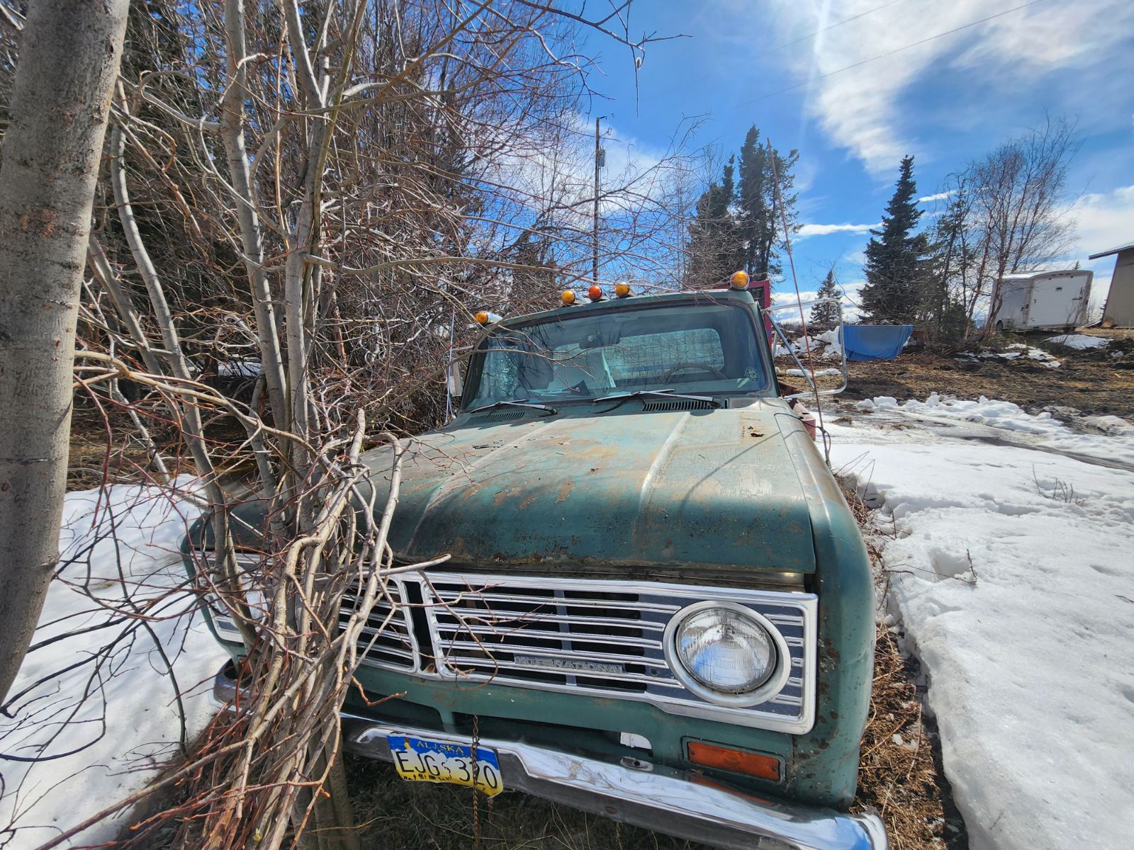

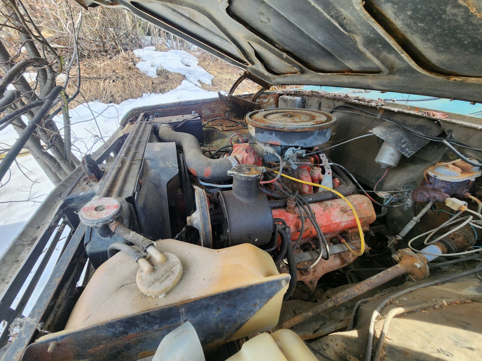

Recently I got a 1972 International 1210 4x4 with a t18 for free. The motor is blown and due to the inability to find a 392, I have been considering swapping in a different motor. I believe the t18's bell housing fits ford motors, but I think I'll probably do the engine and trans. I'd like to keep the hand throttle and all of those cool things. What trucks usually came with a 392 international? I'll try to find one with it hopefully.
Ouch, sounds like it froze. Have you looked into a 392 short block? Also are you aware that in 73 392 blocks changed to an improved cooling design.
I have not heard of the improved cooling design, but I will look into it. I have tried to find one, but I live (hence the username, Alaska) so shipping is probably going to be a pain. Probably best idea is to find an old semi or dump truck and play switcharoo. I'm more well versed with 73-79 fords , but I'm a little familier with the 392 engines
