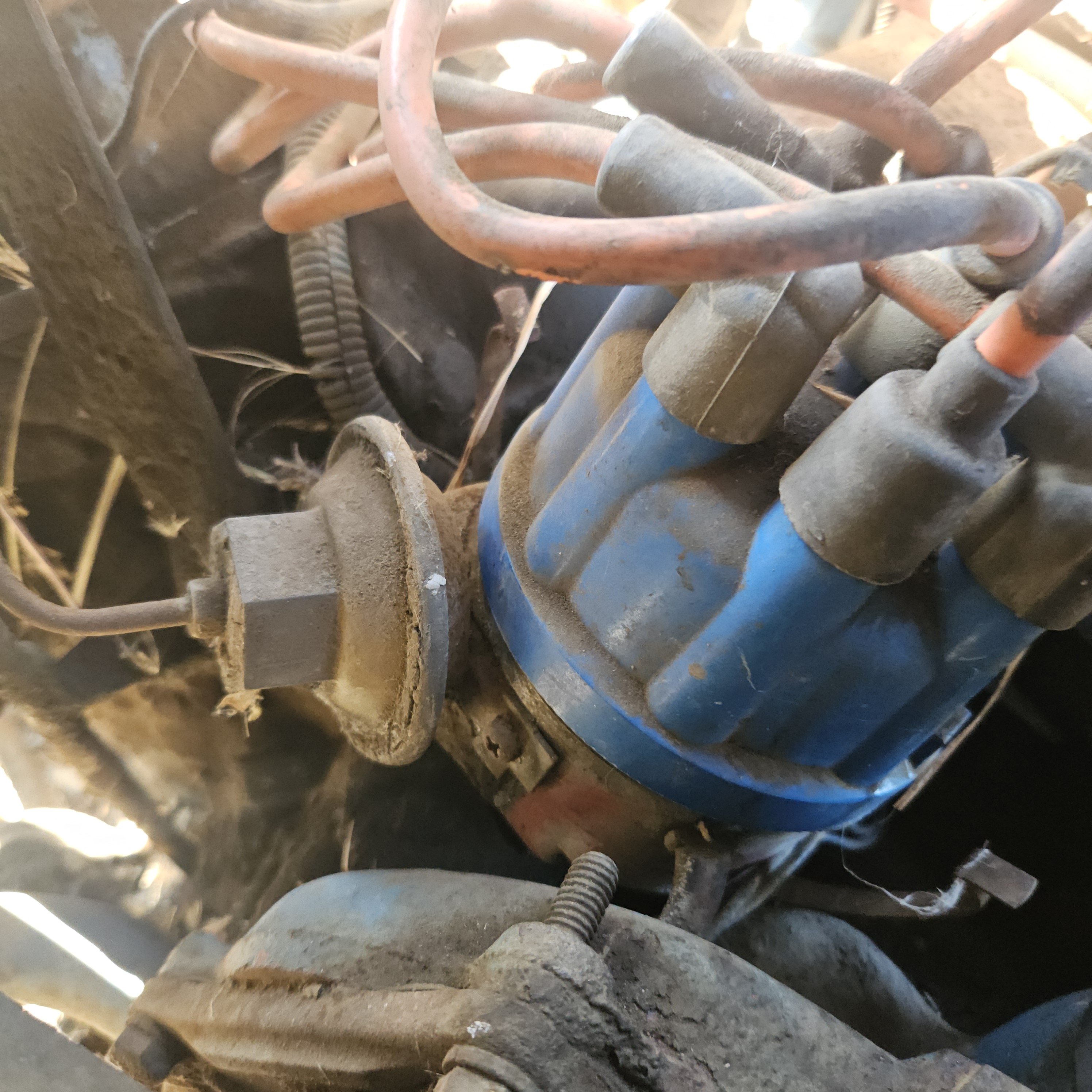

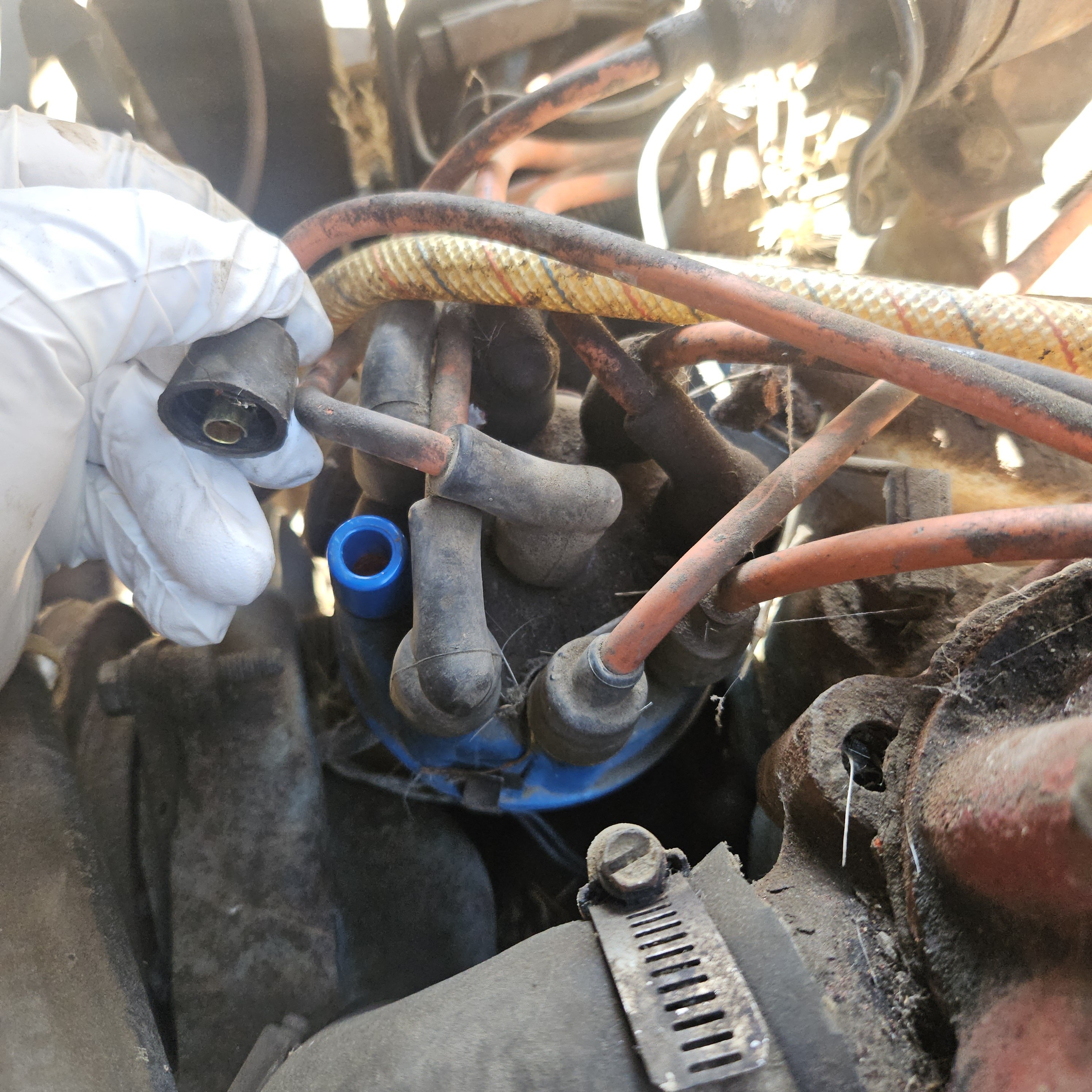

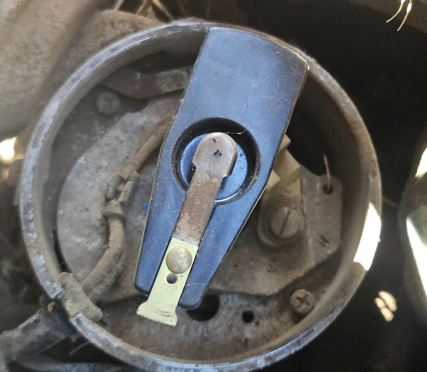

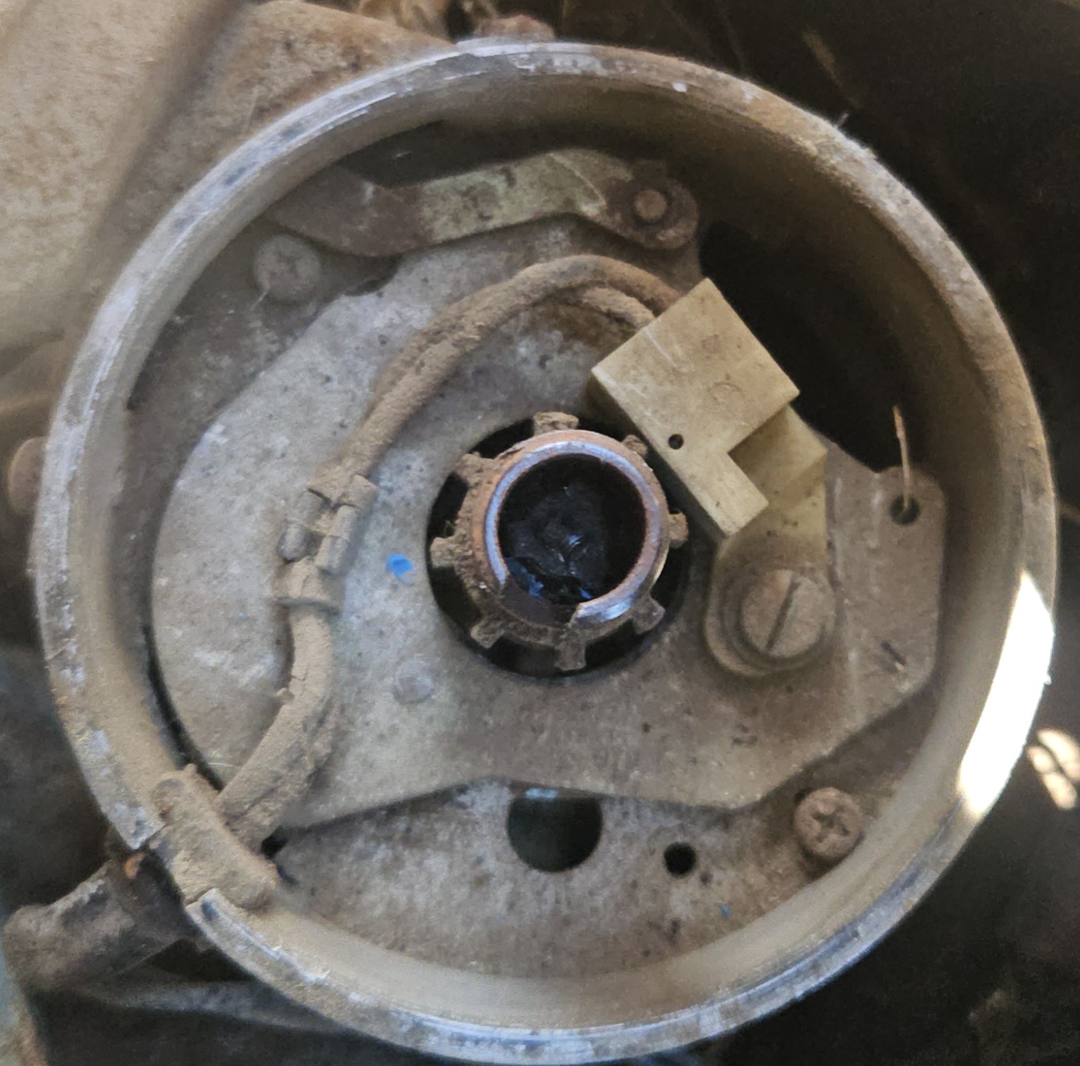

D Dia New member Monday at 7:41 PM #1 Is this a Prestolite Ignition or Holley , doing a tune up on this 345 - I know its dusty just want to correct plug wires and cap, Thanks ! Attachments 1000039307.jpg 1.2 MB · Views: 14 1000039310.jpg 3.5 MB · Views: 12 1000039311.jpg 2.9 MB · Views: 15 20260510_172440.jpg 1.1 MB · Views: 11
1975IH200 Active member Monday at 8:31 PM #2 Holley electronic ignition, aka "Gold Box". There should be a Gold Box on your firewall that is the remote ignition unit for this distributor.
